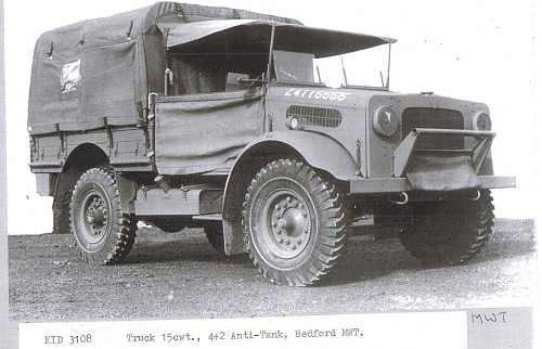

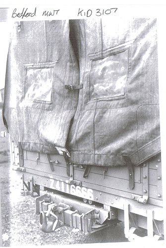

MW 15-CWT WD TYPE (‘SERVICE’) TRUCK (FLAT FRONT):
MWC WATER; MWD G/S; MWG A/A; MWR RADIO; [MWV Van adaptation of MWR] MWT Anti-tank Portee; MWX inflatable decoy
