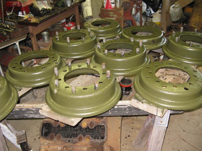

It is almost a year since the F15A project was started. There are now 2 1/2 F15's in various stages of disassembly. The last truck that was acquired (in April this year) proved to be the best subject to restore. A lot of component rebuilds / restorations have been completed. The transmission has been redone, the steering box, and several more items. At the moment the brakes are being rebuilt, and the wheels readied for tires.
A few pics of the project.
re s f15 redux aug 13.jpg   res cab floor aug 13.jpg   res f15 redux 2 ag 13.jpg   re s f15 wheels aug 13.jpg

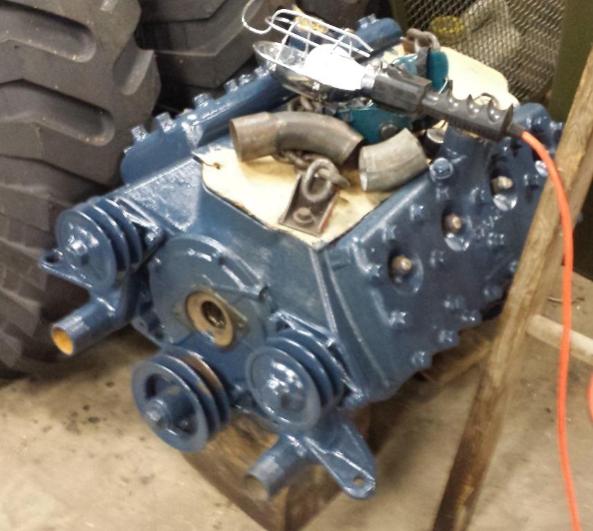

Nearing the second anniversary of the project, the restoration of the F15A is coming along. Several "mini-projects" are under way. The engine has been tested and compression good; painted and ready for installation. The seats are nearly completed, but an inside cold weather project. Window frames painted. Lots of small things done, with lots more to do.

Some of the projects under way.
Seats, (sorry about the poor image), window frames, engine, rad, gas tanks.

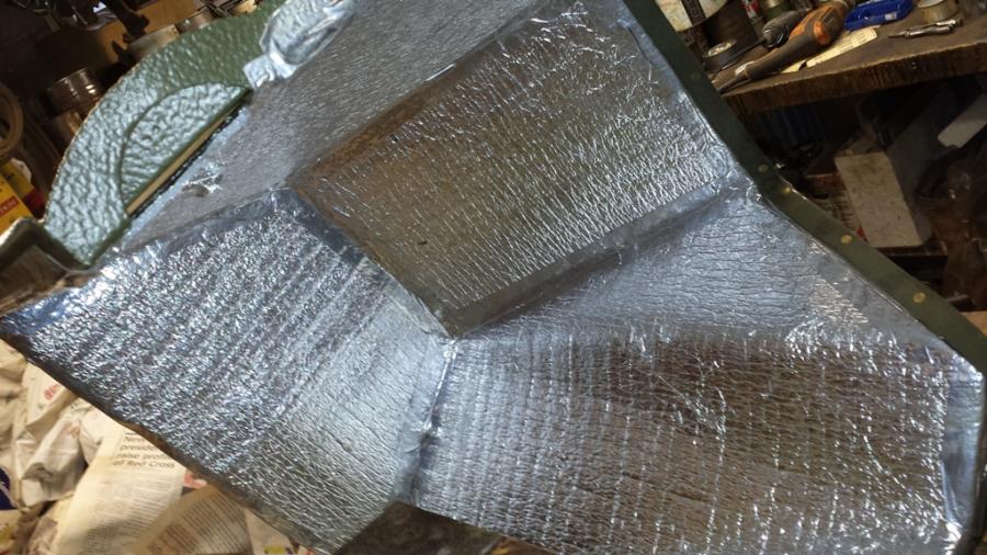

With the cold weather on us, work has moved inside. Some of the jobs under way include insulation under the engine cover and transfer cover, the dash board, the bumper and the hatch cover. A couple of modifications have been added, like a kill switch on the dash. Someone had cut two rectangular holes in the bumper which needed to be repaired. Insulation was added to the inside of the engine cover and the transfer case cover.

Default Engine cover insulation
Hi Bill
What did you use for the engine cover insulation....brand name.... obtained from where? How was it fixed inplace???

Here is the scoop. There isn't a brand name for the product. Dad got it from Mac's, a Ford parts dealer in Lockport New York, US. http://www.macsautoparts.com/ford_mercury_early/
The product is a foil with a thin foam middle layer, maybe 1/4 inch thick. It was glued on the engine cover using a contact cement. The edges were finished with an aluminium duct tape.
