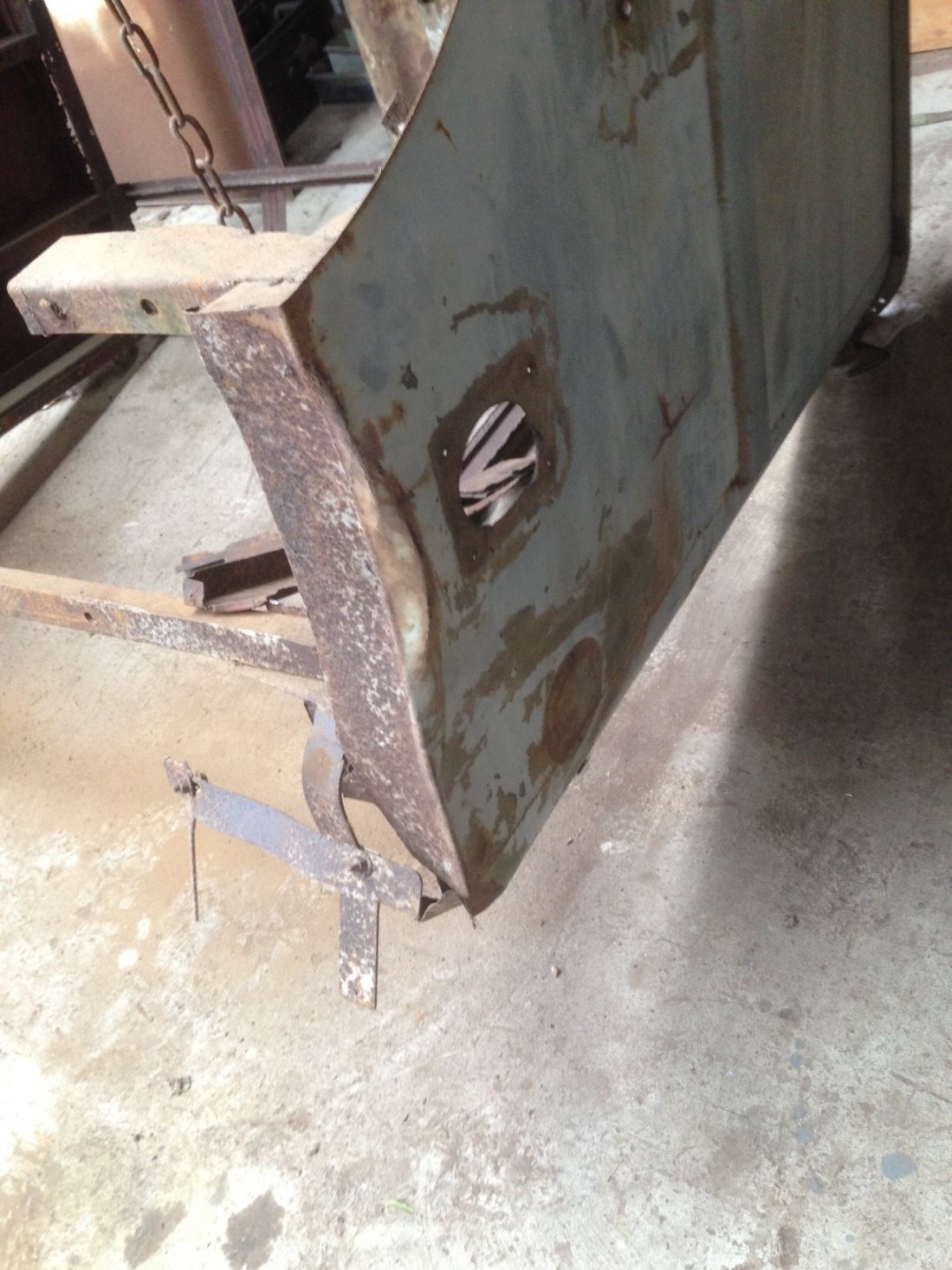

I have started on the rear box. It is missing the rearmost cross member and this has allowed the rear sides to twist outward a little. I need to repair the rear left corner which has been damaged and is too difficult to repair so I have opted to put a new patch in. This would weaken the sides even more so before I cut the damaged section out I welded up some scrap at right angles and clamped them top and bottom to square the sides up before any further interference.

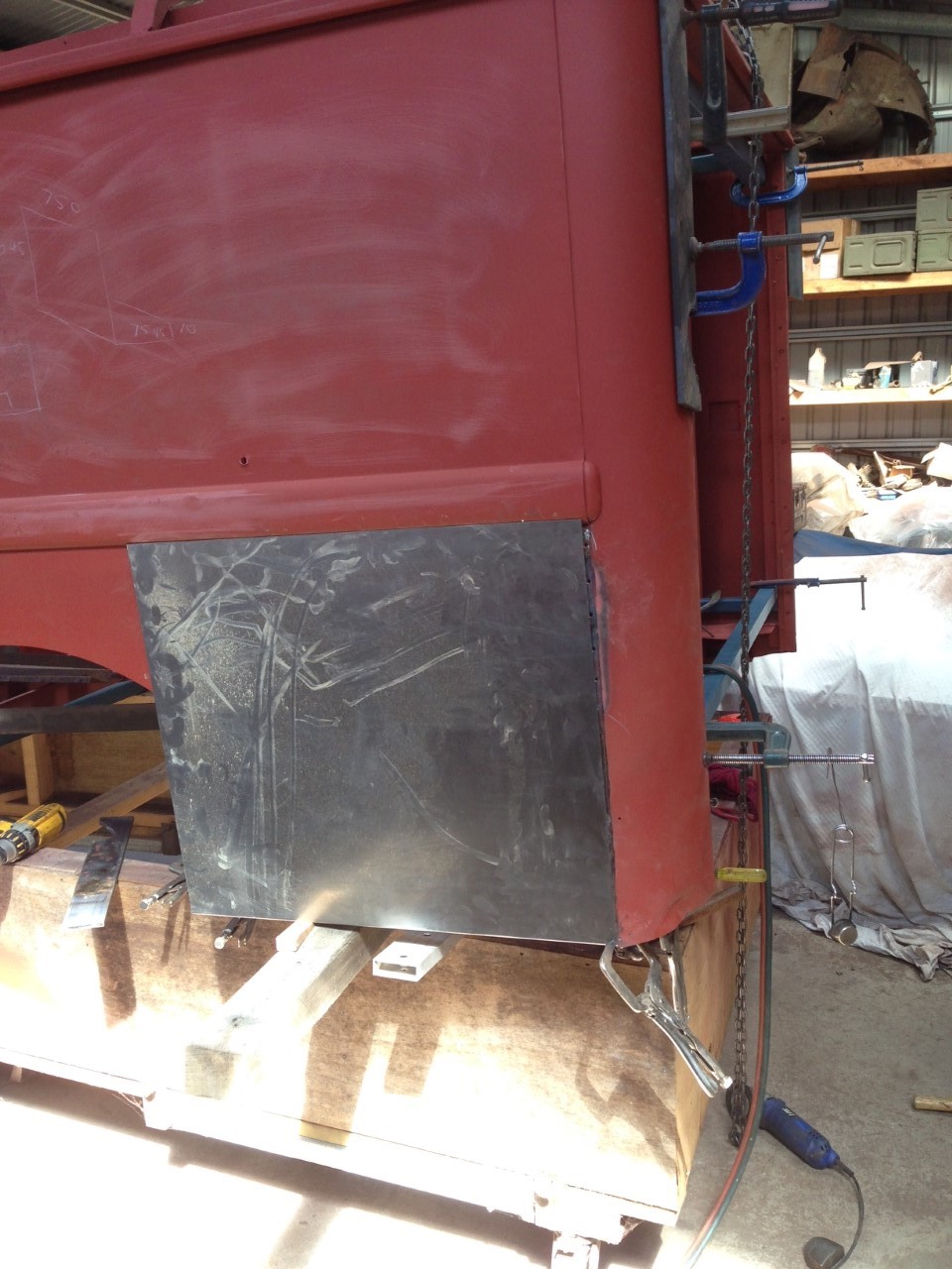

I had a patch folded to match the bottom folds of the corner and then cut out the damaged section. The top of the patch joins at the bottom of the side rib which should give it enough support to stop the weld distorting the repair. The front of the patch weld will be hidden under the pioneer tool rack as indicated by the chalk line.

It still needs a bit more work which I will tidy up when the other patches are done.

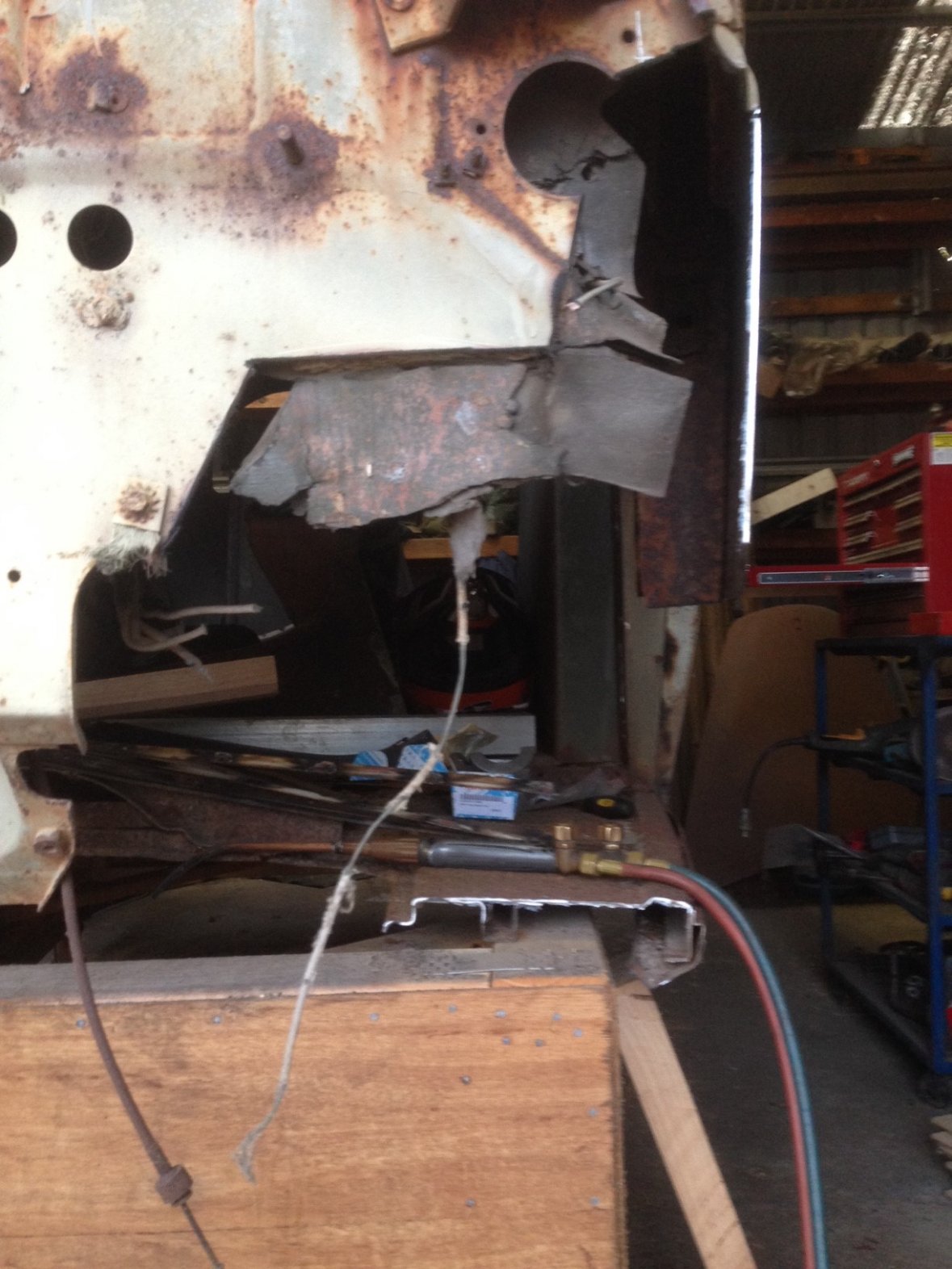

Another patch was required on the lower front right area where a cross member end had rotted away. The porta power was required to keep the sides apart.
It was a little bit tricky turning the box over but luckily my trusty gantry is there to assist. It will need rolling around a bit more before I am finished.
