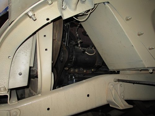

Old 13-09-14, 06:23
Default Well here they are....
Hi Phil
The first series of pictures are actually my cab 11 side panel which I opted to replace with a better one. It would be a good model to reproduce from. It seems that all my cab 11 and cab 12 are the same configuration..... with no access door.
You will noticed that all my trucks are named from who I got them from.... also keeps them easily identified if you have any questions.
You may wish to incorporate them on your site for future reference.
I have included text on each one.
If any one as any questions, comments or if my information is incorrect fire away.

Old 13-09-14, 15:57
Default Great Detail Of Inner Panel
Hi Bob
Those are great detail photos of the inner panel, it should be a snap to make a template for the panel now that I know what it looks like in such detail. Ian had also sent me a photo by e-mail so between all the photos I should be set.
My plan is to make a template for what how the original should be made, then plan to figure out how to make a panel that can be more easily removed for road side service. Having lost fan belts and had to fix stuck generator brushes on the road, want to be sure I can get into that area with out having to remove some of those bolts.

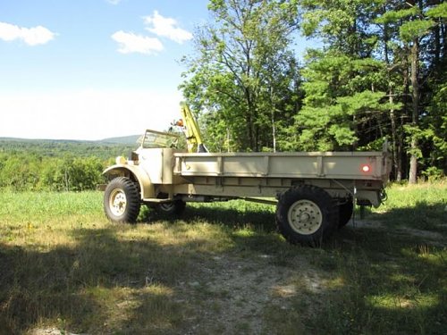

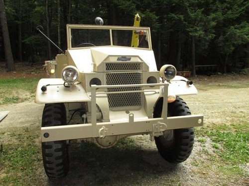

Old 07-07-17, 21:42

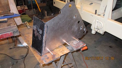

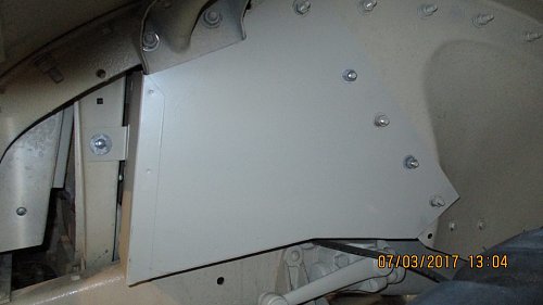

Default Splash Shield Made and Installed
Hi Bob and everybody else who responded to the Need Picture of Left Front Engine Shield
Well I finally got around to fabricating the Left Splash Shield.
Here it is installed, note I did some field modification reducing the number of bolts that have to be removed to access the generator. It now has only three bolts to remove or install.
Name:	2017 C60L Splash Shield_0837.jpg
See next post for dimensions.

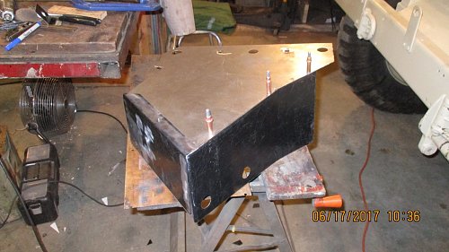

Next two photos show the unit being prep for spot welding.
Name:	2017 C60L Splash Shield_0797(1).jpg
Name:	2017 C60L Splash Shield_0795(1).jpg
Have not driven the truck much since installing but it noticeably reduces the amount of fan air coming out under the fender. But it also appears to increase the air pressure in the engine box so that any seem or joint on the dog house aimed at the driver now produces a stream of hot air. Spent the morning sealing and closing those gaps up.
My thanks for all the photos provided, once it was clear what the part looked like it was not difficult to cut and fit cardboard template. Once that was done then the steel was easy.

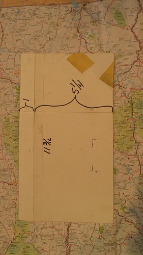

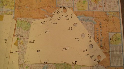

Old 10-07-17, 22:09

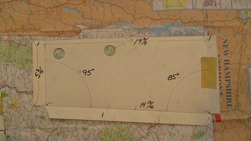

Default Left Side Engine Splash Shield
Hi
Hope these panel templates, with more readable dimension for the panels to fabricate the splash shield, are more helpful
Name:	W Pat 12 Splash Shield Side.jpg
Note the 1" holes are meant to over lay the side panel mounting bolts, with only 2 of them being used to attach the panel. The tap toward the front is bolted to the radiator frame using a carriage bolt with a thin nut to capture the bolt to the radiator frame which is them over laid by the tap with large washer and nut.
Name:	W Pat 12 Splash Shield bottom.jpg
On the bottom panel the two 1" holes over lay the frame rail rivets. This edge is covered with some anti squeaking material to allow for cab movement.
Name:	W Pat 12 Splash Shield Front.jpeg
Front of the shield just completes the enclosure.
As mentioned having both Splash Shields in place forces the air from the fan to flow through the engine dog house without all the air from the fan being exhausted into the wheel wells. Did some testing over the weekend in 80F air temp on long 10%+ grades down in second gear to see if it improves engine cooling or not. No clear difference.

Old 10-07-17, 23:35
Default Nice creative thinking.
Hi Phil
Love the way you over drilled the bolt holes to prevent having to tear down the whole cab assembly to access the panel.
I remember the headache I had trying to remember the sequence that needs to be followed in the cab re-assembly.
If you need any additional info let me know. I have not seen, at least in Eastern salted Canada, a cab11 or 12 that did not have these panels rusted to bits........ a bad design to start with but then they were not suppose to last 75+ years.
