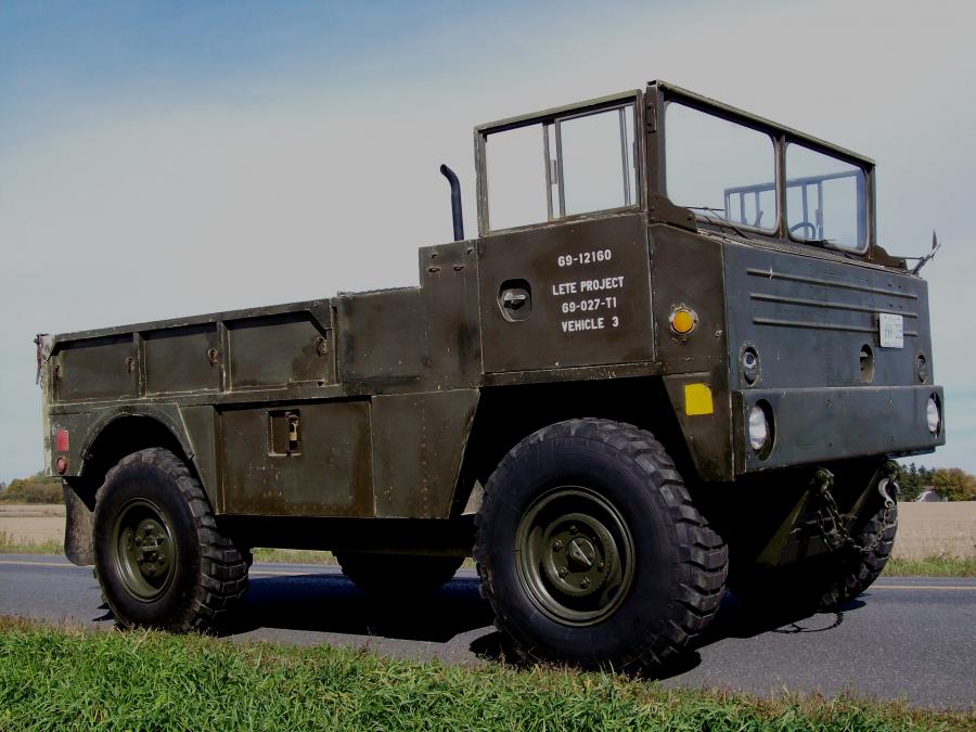

Update on RAM progress; New-ish tires now installed & conservation painting done. The graphics were barely visible but readable - the new stencils were cut to be an exact duplicate of the originals.

Gorgeous. That vehicle has been on my must have list since I was a young Private in Borden.
