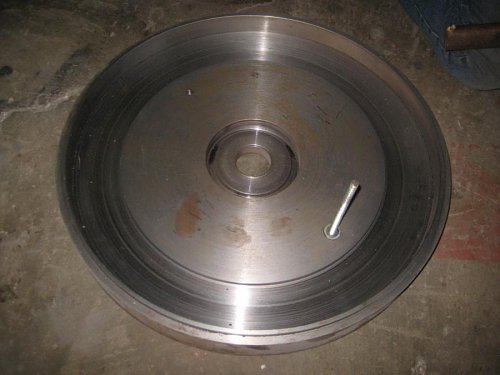

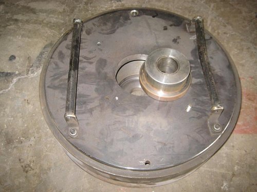

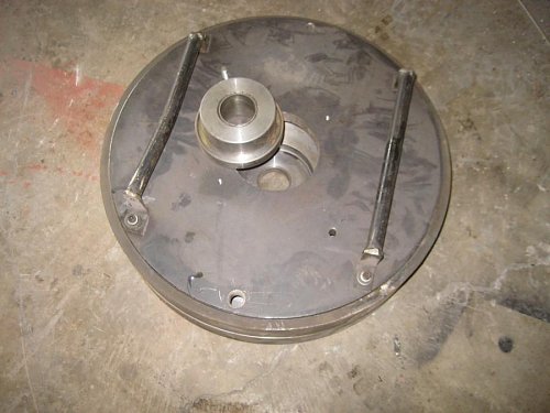

Here is the mold without the insert for the track adjustment wheel
Name:	photo mold 3.jpg
ID:	69040 Click image for larger version
ID:	69041 Click image for larger version

I have tried to upload picture of the completed wheel with a little more than 100 miles on them but they must be to may pixels they will not upload
Sorry but wheels look and work better and are a lot cheaper than going the forklift route
