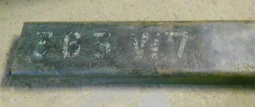

Posts: 14,970
Originally Posted by Jacek Nitkiewicz View Post
Vehicle was painted three times: original factory green paint, later in all accessible parts this paint was removed and truck was painted outside dark blue by auto workshop "Garage M. Chatelier" in Bretany. Someone repainted it grey inside and outside at last but without cleaning, so this layer can be removed very easy. So far I couldn’t find any military markings on the truck except WD mark on one of the tires.
Jacek,
Over on HMVF I saw you posted a picture of the number found on the bumper. I guess "363 W7" is a civilian registration number?
I was asking about any military markings because I wonder if this C15 was one supplied to France after WW2, or if it was one of many captured in 1940 by the German Army, used by them during the occupation of France, after which it was put to civilian use? If only trucks like this could tell their whole story!

Hanno, I couldn't find any military marks so far. I doubt it was one of the trucks left behind , it has inspection plate from GM dated 1945. Certificat D'Immatriculacion I have is for reg no 352CE35. It was issued in 1955. No idea where 363 W7 comes from. One thing for sure it was covered with paint, so must have been before 352CE35. I will be in Bretany next week I try to lern more about vehicle history.
