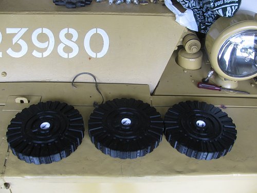

Attached are some pics of the prototype in the raw form off the printer and assembled, then cleaned up, spray puttied and primed and finally with the coat of colour on. I still have a little way to go with the relevant licencing authorities in my state regarding this, however it is a work in progress. As always, constructive criticism and comments welcome.

Hi Matt, they certainly came up a lot better than the blown plastic ones that I bought. Good job.

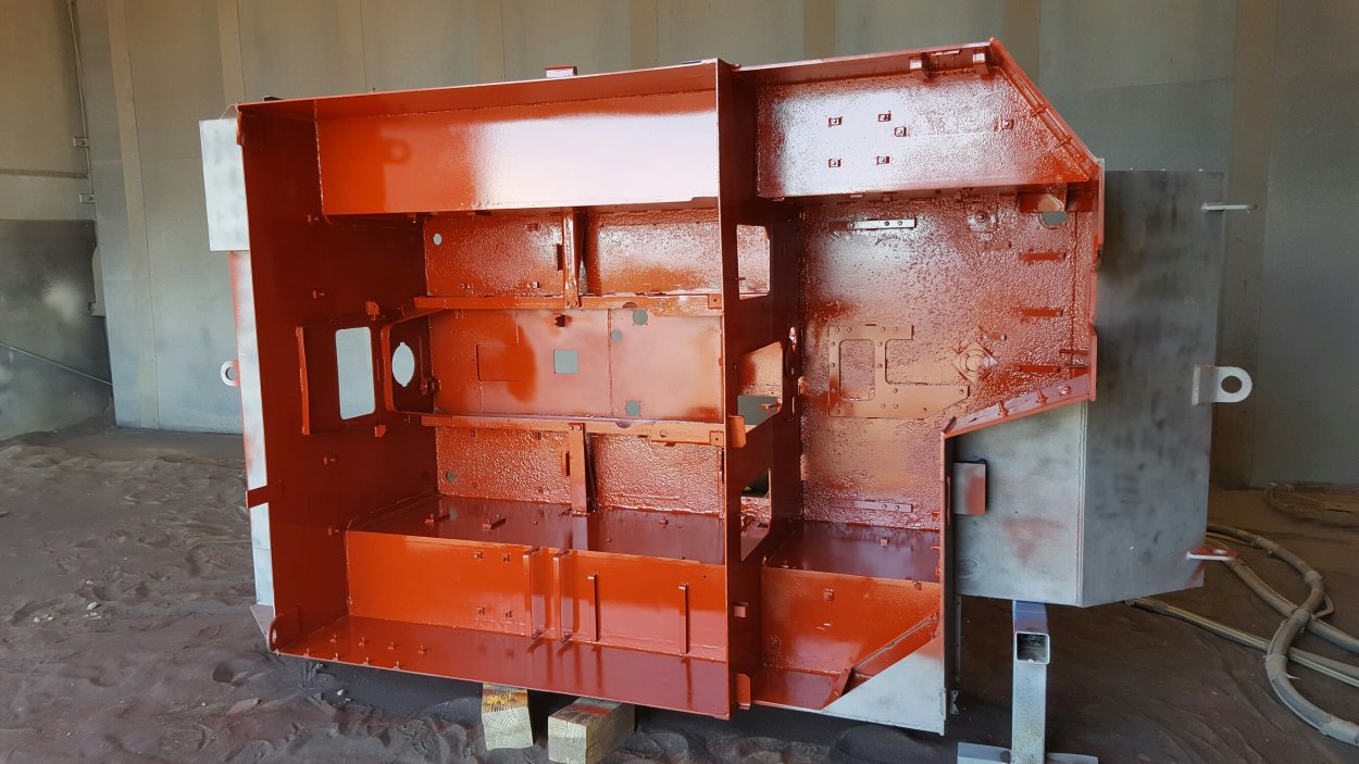

A recent update on the carrier restoration. Recently I've had some time available to me and some much needed cash to be able to make some progress with the restoration. So after a few weeks of work, and some very much appreciated assistance and guidance from a local fellow carrier owner I was able to have the hull stripped, sandblasted and primed in red oxide.
So what comes next? First of all I need to keep my kids out of it now that its clean and primed so that I can get it painted. Then I'll be working on all the other parts and begin to bolt things back in. Unfortunately the rubber on all the wheels has perished and is in an serviceable condition. I've already made a few enquiries about have new rubber tyres vulcanized onto the rims and so far I'm dreading what the missus will say when I tell her how much its going to cost......

Matt, you need to top coat it, Now!
Primer is generally porous and if it gets damp, rusting starts. you are fortunate to be on a fairly low humidity, bit of the planet.
Keep your eyes open for better wheels.
Try getting hold of Ron Winfer. He had quite a few a while back.

Looks Great Matt well done . When I painted the Green I used a small flat brush and cut in around all the hardware e.g. floor fittings, inside dash cut out,
underneath engine rails , also I gave a good coating along all the seams inside the hull , this way when your spraying the big flat panels your not trying to get coverage around things in hard to get places . best to paint up under the drivers compartment first , then fire wall behind you , lower inside walls , floor then panniers then work your way out . Second coat you can take your time and spray away .. I think I used about 25 litres of KG green enamel , 20 litres of primer 1 x 20 litres of enamel thinners 1 x 20 GP thinners best to buy thinners in 20 litres with tap . These numbers are for the complete carrier not just the hull . hope this helps . Dale

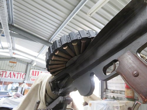

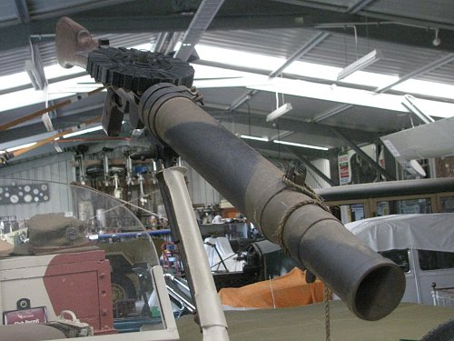

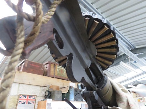

I have three similar 3D printed Lewis mags and this is how mine ended up on the imitation Lewis on the 1940 LRDP WB Chev.

Yes the .303 rounds are empty cases with the projectiles refitted.
