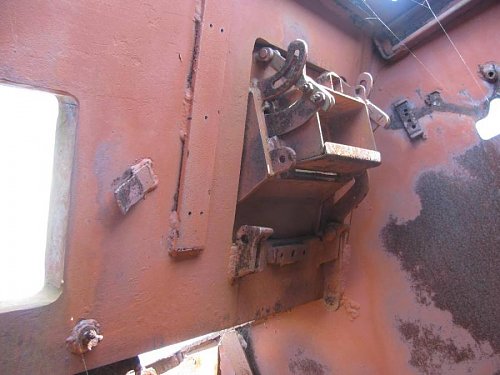

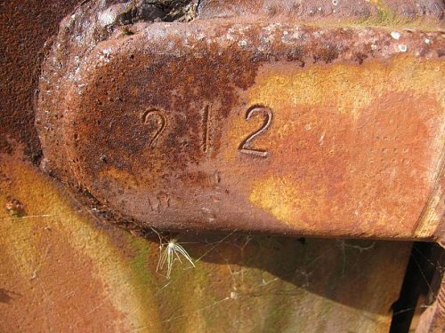

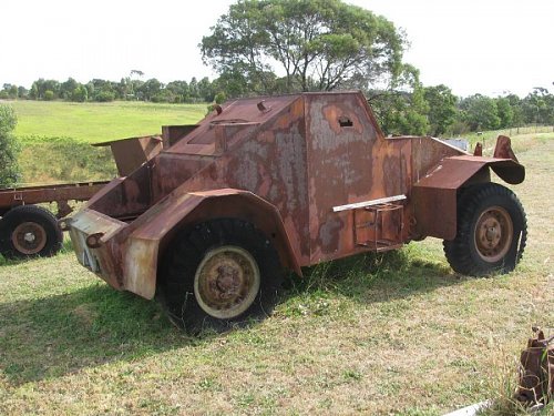

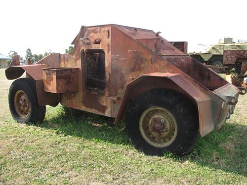

The Australian Ford Marmon-Herrington 'Dingo" Scout Car was made with Australian made armour plate and was fully welded with non stainless rods. I do not know what the composition was but here are some photos of mine (No.77212) for you to compare. It does have the armour test indentations in a couple of places.
Regards Rick.
