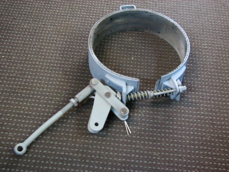

The photos show the flare box, breech shield, more map clips, and the handbrake assembly cleaned up. The steering box and steering wheel are all ready to install. The propellor shafts and pillow block are done. What is the small propeller shaft? It looks like White Scout car to me. I cleaned it up anyway.

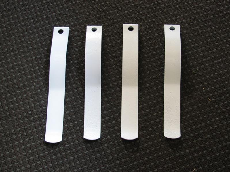

Work on the M8 has continued in the background. I have the five combat rims blasted and primed with new tires on them. The sixth rim is still in Belgium coming over with some other parts.

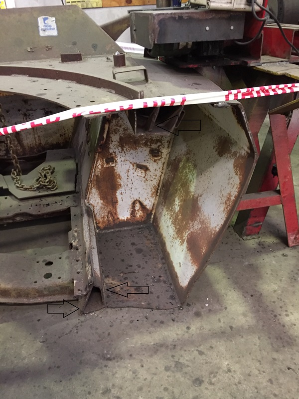

We have gone to a Plan B with the hull welding. The guys in the engineering workshop have removed what was left of the sponsons on the rear hull piece only by way of carbon-arc air gouging. The removal of these pieces looks like it will give sufficient access to the main inner sections of the chassis/hull so that decent repair welds can be done on both sides.
The inner channelling for the cabling etc in the sponsons was stitch welded on both sides and so was a bit hard to get out. These were obviously put in place before the sponsons were fitted when the vehicles were manufactured. New pieces will be folded and welded into place to replace these.
The plan is that the guys will do a vertical cut from top plate to bottom plate on the end of the side sponson plates on the front hull pieces. Once the inner chassis/hull sections are joined they will cut pieces to fit the gap between that vertical cut on the front hull piece to the end of the sponson box on the rear hull piece, replicating the original welding.
Of course, we’ll need to fit the repaired ring gear in the hull first before that is all finalised!

Here are a few more pictures showing some more work on the hull.
The ring gear is in its jig just awaiting the water cut parts to be produced which will be spliced into it.
The vertical cuts have been done on the sponson sides on the front part of the hull. This has given good access to the internals and all the rough edges have been tidied up ready for the two pieces to be mated together.
New pieces of plate are being cut to replace the section cut off from the sponsons on both sides of the rear hull piece.
The bolted pieces of steel shown have been put in place to enable the hull to be quickly brought back into the roughly correct position once the ring gear is ready to go back in.
Progress….
