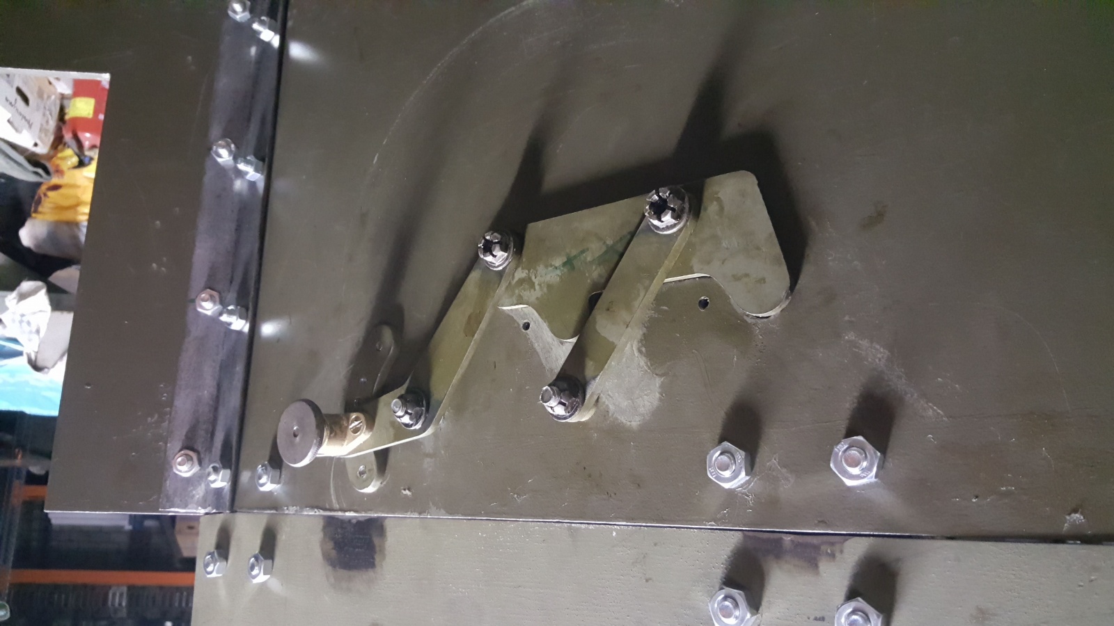

I had make a start with the replacement of the upper armour at my carrier.
At first i mount all the parts with bolt and nut and later with rivets.
My wheels are also done with new rubber.
I had try to upload some photo's of the progress but unfortunately
after resized the photo's and uploaden the photo's are turned upside down.
Marcel.

Join Date: Jun 2011
Posts: 1,171
Greasy side down
0FFAD541-A3A1-49A7-8FFB-7D16E8214AFC.jpeg   C78F560B-EEFF-45DB-AF3C-1CEC04F51222.jpeg
Old 26-12-18, 23:47
marcel both marcel both is offline
Join Date: Sep 2015
Location: the netherlands
Posts: 54
Thanks a lot Michael.
