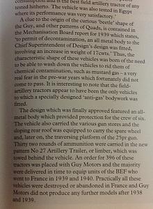

Reference to the design shape is contained in a Mechanisation Board minute featured in Ventham and Fletcher’s Moving the guns : the mechanisation of the Royal Artillery, 1854-1939, p81. shown above.

Originally Posted by Tony Mathers View Post
This should answer a few questions.
Attachment 79801
I would suggest that the anti-gas feature was simply making the body all metal, as opposed to it's "beetle" shape. In the end, the vast majority of CMPs were of all metal construction.
I note the author also has the evolution of the spare tire and platform mounted on the back in their reversed order of occurrence. Mounting the tires onto the back came later, after the run-flat tires were replaced with regular tires to conserve rubber. I think you would need all six men to get a 20" runflat up onto that back, and I'm not sure the weight would have been good for the truck nor the operators having to lift it.
Perhaps this was the wrong book to quote for the museum's interpretive panel.

Your first para. Rob, is how I read it as well. Tin body for anti gas as opposed to wood / canvas.

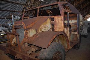

I notice Australian Armour and Artillery Museum have ARN 46425, which suggests another "Refugee" block was opened. Do we have any record of this one Mike?
Name:	Ford Cab 12 FAT ARN 46425  Australian Armour and Artillery Museum  formerly Sid Beck Mareeba.jpg

Actually, Tony, I don't believe you can 'mix and match' the individual requirements as listed under each heading - I think each stands alone - which leads me to conclude that therein is the basis of the difference between how we each see MECH314, but that's just me.
46425 is an easy one: the front shell is off a 3 ton 4x4 GS cab 12, chassis/engine number 2G44509F, part of UK Order 889. It is ex-The Beck collection (where I think the image was taken), now residing at the Cairns A&A Museum. Syd was always keen to add the missing bits when he could.

Default 46425
Not only was it a cab 12 front from a F60L, the whole lot was sitting on a cab 13 F15A chassis. You can see the centre mount for the cab 13 front shell.

Old 28-02-16, 20:49
Nobody would believe you if you turned up in something looking like that!
But it's genuine and looks pretty interesting.
It all looks quite Heath-Robinsonesque, doesn't it?
Hanno, how can it be a FAT? It's a GAQ (that's never going to go viral)
You mean GQA?
For other readers: FAT stands for Field Artillery Tractor, the name of the type of vehicle. Chevrolet built the CGT, Ford the FGT, etc., etc., all FAT's.
Thanks Tony for the scan of the book.
I concur with Rob's remarks above. Sorry to see the esteemed writers clearly missed the bat on this one!
