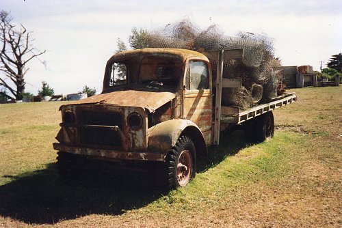

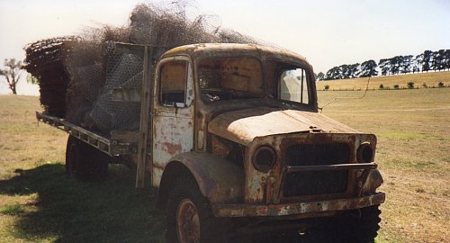

Here are some photos of the OY the day I first saw it in 1996/7. The farmer told me it was either 1942 or 1943.
I was far more interested in what was hiding up in the stack of old rain water tanks at the top of the hill, seen here top left in the back ground. It was the remains of a Canadian Scout Car Ford Lynx Mk.III*.
ID:	82501 Click image for larger version
Anyway we recovered the old girl and as I said, passed it on to Tony L. in SA. who passed it on to Richmond G. and then it went on to Matt L.
Regards Rick.

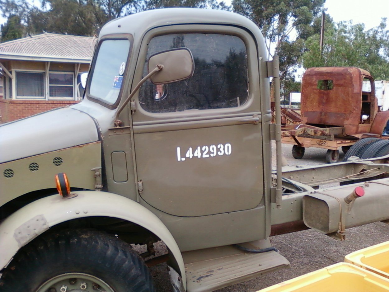

Hi Sorry for not posting photos,, now that I think what I am doing I'll try some general photos of the truck.

Hi Matt,
I think you will find that roof hatch, or cupola was not added until late 1943. Does it have sling plates on the wheel hubs? The engine number that Rick C quoted sounds like a 43/44 build, also noted it appears to be painted black, in the event that it had never been overhauled this could be the original factory finish.
Now I know how to load a photo here's the hub.
