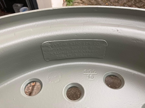

Default visible maker's stamp
Canadian made rims have the valve stem opening to the left of the bolt. Two of the eight bolts are longer than the other six.
This example has no maker or date stamp, only "6.00 / 16".
Triggered by Jacques’ photo and on closer scrutiny of this Canadian made rim, it does have a vaguely visible maker's stamp "General Motors Canada 1941".

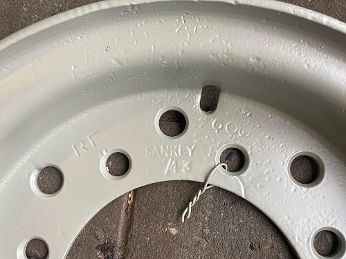

Nice to see stampings coming to light after blasting and coating:
General Motors Canada 1941 (Canadian made)
Sankey 1943 (British made)

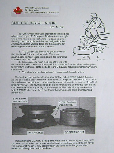

Default CMP tire installation - Jim Ritchie
Lynn posted this link also, upon actually reading Kurt Laughlin's article I found an interesting drawing.
The US 16" rim was 15.965" in diameter and had 5 deg. bead angle.
Worth a read if you want to turn down your rims to fit new tyres currently available.
The 16” divided rim has plenty of thickness to allow machining 0.125” off:
Old 22-05-22, 01:09
Posts: 567
In the article Jim describes his modification as not attempting to machine the 5 degree taper used on the Dodge rim but instead to machine the new seating area parallel and about the same diameter as the mid point of the bead contact area of the Dodge rim. I would have thought that any lathe capable of this machining could have just as easily reproduced the 5 degree taper and exact start and outside diameters of the American standard. This would provide a better seat for the bead and make dismounting easier if needed. It really is not hard to change the angle of the compound slide and turn the handwheel manually on any lathe !
Old 22-05-22, 23:58
One thing that would concern me about turning a taper would be to minimize the loss to the rim near the join line. In other words: if turning a taper, just put it in the area nearest the flange, then turn a parallel section further inward to maintain thickness/strength.

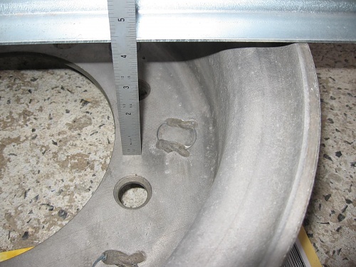

here is the link below.
I was replying to a 2019 query by Philippe Junneau about "backspace" on 16" Chevrolet wheels.
Photo in question is a 1943 Kelsey 16" wheel from a Ford CMP.
Recently on Facebook a question was asked about wheel offset on CMP trucks and I used the same photo and dimensions to obtain the offset.
As we all measure things differently, here is how I measured the PCD of the wheel mounting studs:
Put the ruler exactly on 10" on the edge of the hole on the centre line to get a sharp starting point. corresponding position on opposite hole is at 20-13/16" -10" = 10-13/16" Even allowing for minor discrepancies it is neither 10-3/4" nor 10-7/8" Holes are not flogged out of round either to affect the measurement.
Hope this clears the confusion.
http://www.mapleleafup.net/forums/sh...ad.php?t=29968
