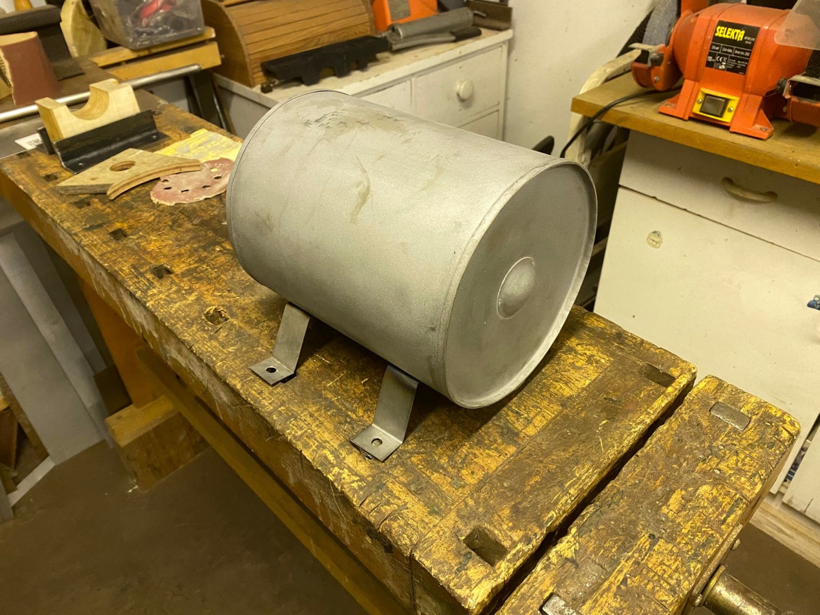

Based on the drawing, it is actually not to difficult to recreate a condenser can with simple tools and small adjustments to the design

Cool little project, Niels!
Old 02-11-22, 14:46
Posts: 4,190
Nicely done. Would it be possible for you to explain a bit more in detail how you made the edge around the can?

Hi Jordan
I cheated, compared with the original design.
I experimented to started with trying to do it correctly, but I simply could not get the metal moved first one way and then back around without everything bulging out. I found I really need a Shrinker/Stretcher for that.
I opted to make each end in "three" pieces, a central lid, the wall and then a outstrip, and then spotwelded everything together, then a lot of filing and griding, to remove excess material and creating the shape of a folded edge.

Thanks for the further explanation. It looks great

Fitted and connected
