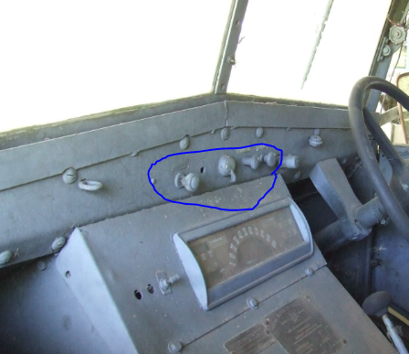

Dash switches Im missing also missing shift plates of the enginge tin wear.

Somebody has added a odd looking extra panel under the windscreen. The fuel gauge tank switch is missing, I got one from Brian Asbury. New choke , throttle cables are available , civvy ones, with the rose tan knobs , light switch has the rose tan knob too

As Mike says, the choke, throttle and light switch are all standard 1940 Chevy civilian truck parts; quite often available on Fleabay, or via one of the classic Chevy dealers. Choke & Throttle knobs are embossed 'C' and 'T', whereas the light knob is plain. The 'shift' and 'lubrication' plates are available as reproduction from LWD parts in the Netherlands (http://www.lwdparts.com). LWD also have the ignition switch/coil assembly.
Looks from your photos like the 'dash jewel' is missing too. No functional benefit; just looks cool!

Sorry might have confused the issue there this is the Dash in my truck the over Photo was one I found on another site but I used it to show the buttons I was missing. does any one have a good photo of the full set of Dash buttons?

Bobs pic shows incorrect types of choke, throttle, IG. Switch and fuel tank gauge switch. The choke and throttle knobs should be the squarish shaped Rose Tan coloured type
