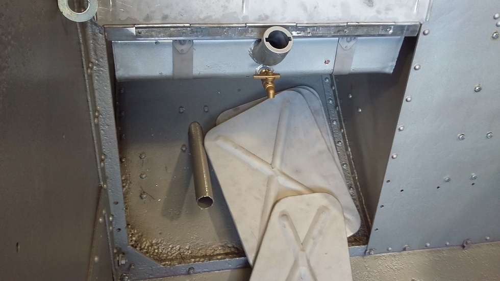

Both fuel tanks are completed and test fitted.

Would there have been baffles, in them originally?

Hi Neil, yes the baffle I made is the same as the original tank I have. I would like to use the original but it is just too far gone with the bottom and rear eaten out but it does give me a look inside to see what is there.

How, or were, the tanks secured, Colin?
I thought I saw an angle iron strip along either the base or back, but that might just have been a form of standoff to keep the tank separated from the hull. Or my eyes playing tricks on me.

Hi David, there are a number of brackets inside the rear well with felt padding that holds the tank in place and another one on the rear plate that when bolted down holds downward pressure on the tank which holds it securely in place. I think the strap you may have seen in some other photos would be one of two straps that hold the water tank in place in the adjoining compartment.

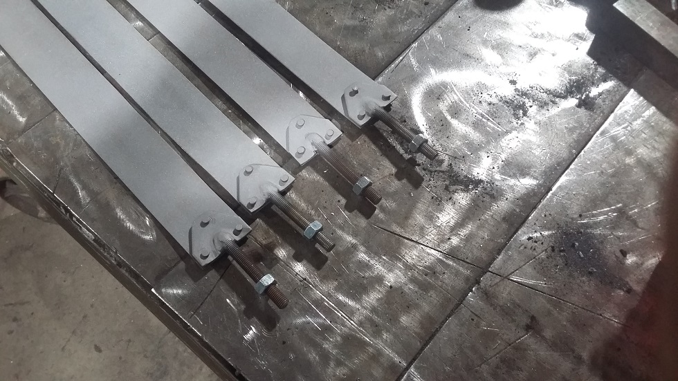

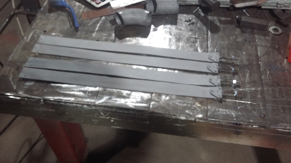

I have also done the water tanks that are strapped at the back.

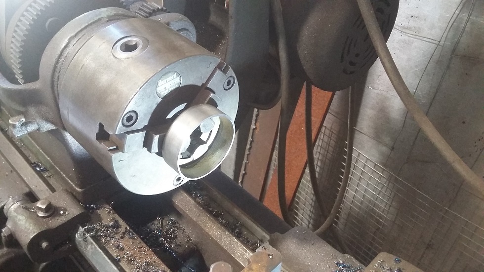

I had to make a couple of spouts which were made from an old exhaust for the bends and I machined up the tops for the caps.

Once again you just can't fold from one end as the shape requires a sequence and some had bending as well.

Looks great and I love following along. I jus have a technique question for you. In post 611, photo 4 what are you using the bead roller for? Is it for adding the hem? Just curious as trying to do that type of edge has been difficult for me in the past.

Hi Jordan, yes I am, I folded as far as I can go on the panbrake which is about 120deg and then through the bead roller to flatten completely and it does a great job.

Thanks. Any special dies to use?

No nothing special, just two flat ones.

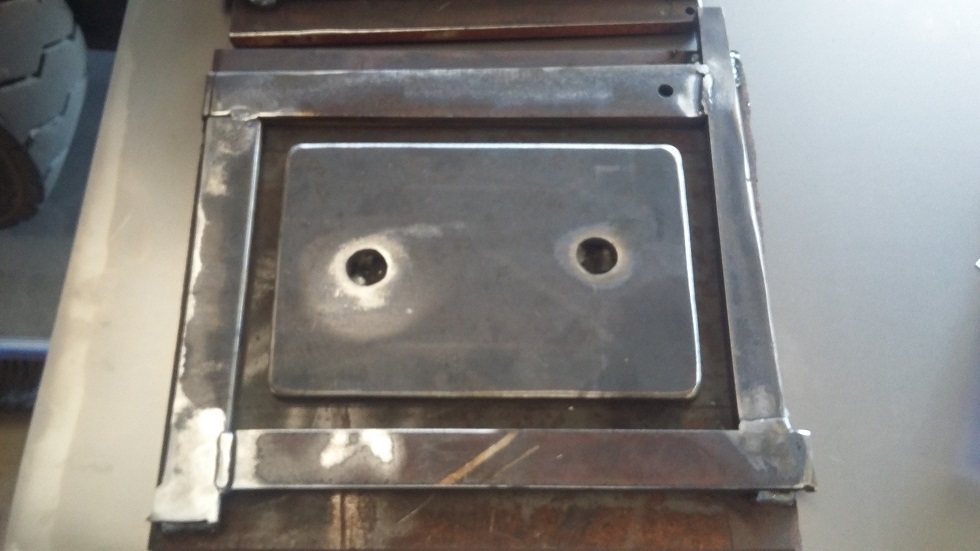

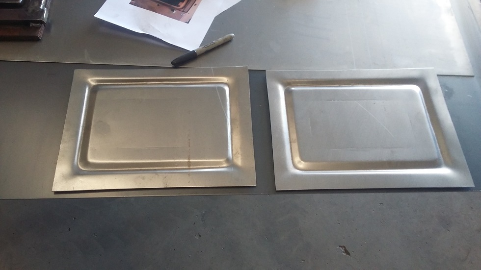

The press tooling I made is for the fuel tank cover. It has a dished recess for I assume a soft rubber compound to sit in under the lid. As I only need two of these I never put too much weld on them so I can easily disassemble and reuse the material again, much like most of my tooling. I will get them both completed within the next 2-3 days.
