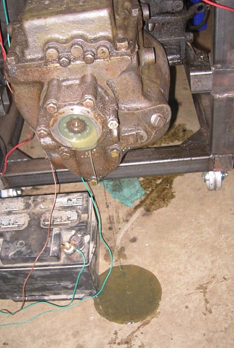

Default Output flange and test run trans
Hi Jordan
Observation if you run the engine on the test stand with the transmission in gear the output flange needs to be in place, or you will have puddle of gear lube on the floor. Yup I found this out first hand.
Edit--Found the picture.
Name:	Trans Lube Leak.jpg
I was surprised at how quickly it tried to basically pump the gear lube out of the transmission sort of explains why this rear seal is a source of leaks. My output shaft had a grove worn it to so it got a speedisleeve. Also the special washer and nut that hold the output flange in place got a little gasket cement.

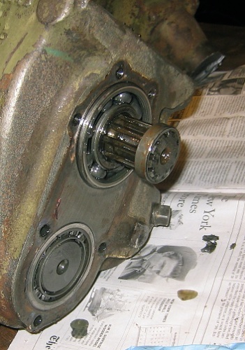

Old 10-11-19, 18:42
Default Spacer
Hi Jordan
Here is the spacer I think is at issue. It goes between the output flange and the rear bearing. It slides along the splines to be pushed in all the way.
Name:	Trans spacer.jpg

Default Transmission ring
Exactly that ring Phil. I couldn't find the old posting I made about that very subject. and You must put the correct bolts on the flange before tightening it up to the output shaft. if you put them in the other way you will smash the bearing retainer all to hell.
  #680
Old 11-11-19, 02:17
Posts: 4,185
Yes it has the spacer ring already installed. I did the other year when I rebuilt the transmission. The bolts fit in just fine with the flange installed in the transmission.

Default clearance
this shows how close the clearance is and the other shows the ring and a bearing retainer after either leaving the ring out or installing the bolts rear to front.
  #682
Old 11-11-19, 17:21
Posts: 2,323
The bolts holding the universal to the pinion can give grief either way round. If installed with head toward transmission and they loosen a bit the head can strike the bolt holding the rear cover in place and cause the damage shown. If installed head to the rear, the nut can strike if it works a bit loose. There is no perfect solution. Just use good bolts, well torqued with new lock washers, Loctite, self locking nuts (distorted type, not nylon locking) (maybe Loctite plus a mechanical lock - you can always use heat or other violence to take it apart).
There are a lot of damaged rear transmission covers / bearing retainers out there.
