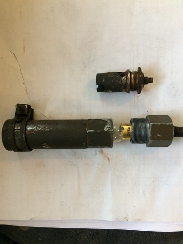

Guys,
Thanks for your positive words. I brought the Lynx home with the intent of restoring a tribute to those that have served our country and to provide a challenge for myself in my later years. It has certainly done the latter.
I mocked up the original bracket as it was found and discovered that when I went to mock up the light that the diameter of the remnants of the original light measured 11/16" and my replacement NOS convoy lights are 15/16". It also raised the question, did the light shine on the differential or was it orientated by 90 degrees to shine to the rear? The lack of documentation on the subject in my Lynx manuals compounds the issue.
I would welcome any suggestions or better yet some pictures.
Thanks, Peter

  #693
Old 14-01-19, 05:19
I'd be very surprised if the lamp shone to the back instead of on the white painted dif. Every other vehicle shines on the dif so why confuse the troops?
The thread size difference takes some explaining however.
  #694
Old 14-01-19, 05:40
Posts: 3,682
Peter.
Prior to your taking possession of the Lynx, it may very well be the last person to service that rear differential put the convoy lamp bracket back on the differential incorrectly.
Looking at your new photo of the mockup, the lamp points straight up and is on the opposite side from where the white paint target is located.
What if you rotate the bracket 180 degrees counterclockwise, so the lamp is now pointing straight down and move it to the left side (bolt head side) and up two bolts. It looks as if in that higher position on the left side of the differential, the beam of light from the lamp would then be on, or very close to the target area.
  #695
Old 14-01-19, 05:48
Posts: 4,188
I was looking over the wiring diagram that is posted elsewhere on the forum and I can’t seem to find a convoy light.
Is there a chance that bracket could be mounted somewhere else under the body. Perhaps try playing around with the light pointing towards the white on an downward slop. The other end might line up to something.
  #696
Old 14-01-19, 05:54
I find it hard to believe Lynx didn't use he same convoy light as all other CMP vehicles.
  #697
Old 14-01-19, 11:09
Would it have had the early rubber light? That would satisfy the smaller size of 11/16".
If that bracket was taken off and fitted on the other side, on the 2nd bolt up, then the light would maybe shine down on the white paint.
  #698
Old 14-01-19, 12:45
My thoughts exactly!
  #699
Old 14-01-19, 13:24
Posts: 566
Is there any evidence that reinforces the idea that the convoy light was mounted to the diff other than that is where it was on Peter's Lynx ? I still think that it is a crazy idea as the vibration would have made the bulb life very short.
  #700
Old 14-01-19, 16:45
Posts: 3,682
David.
I was wondering about that also. Any other convoy light bracket I have seen was frame mounted and punched/formed from heavy guage sheet steel. This one on the Lynx looks to be made from far heavier bar stock.
If this mount and location are correct, could it be that the Engineers at Ford anticipated the vibration problem and went with heavier bracket material to dampen out the vibration. The earlier, rubber convoy lamp may also have been chosen as an aid to reduce vibration as well.
Another consideration would be what the actual wiring harness has to tell us. Does it include a line for a convoy lamp? Where does the harness run on the vehicle for the back half of the vehicle feeding the tail lamps? What locations would any existing convoy lamp wire reach, or not reach, to connect with the convoy lamp.
An interesting mystery!

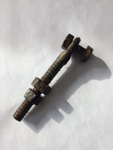

Guys,
There are two heavy duty (1/2") eye bolts on the sides of the hull and while I can find them on illustrations in the maintenance and parts manuals, there is no part number for them. My question is - what purpose do they serve ? My old LH slanted bin also has a lighter eye bolt on the front side and I have photographic evidence of two additional eye bolts of the front storage bin. Again, does anyone out there know what purpose these eye bolts serve ?
Thanks, Peter

  #717
Old 23-01-19, 19:25
Posts: 2,323
This is a guess, not founded on any evidence - to provide securing points for lashing a tarp?
  #718
Old 23-01-19, 19:32
Posts: 566
My first thought was lashing points but why not just weld a loop on instead. The fact that they are adjustable might suggest that fixed length metal hooks latch into them and they must be positioned just right to serve their purpose.
  #719
Old 23-01-19, 20:40
Location: Burnaby B.C. Canada
Posts: 1,130
Default Antenna anchor
Thats the hook under the aerial that springloads it so it bends under obstacles.
