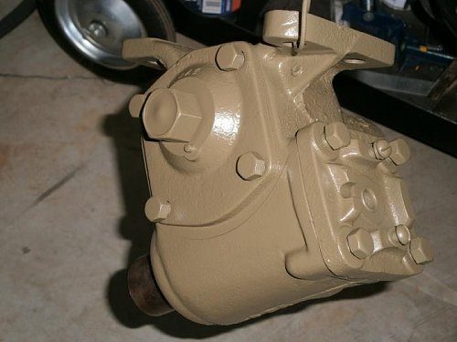

Old 08-10-12, 10:47
Default Work of last Sunday

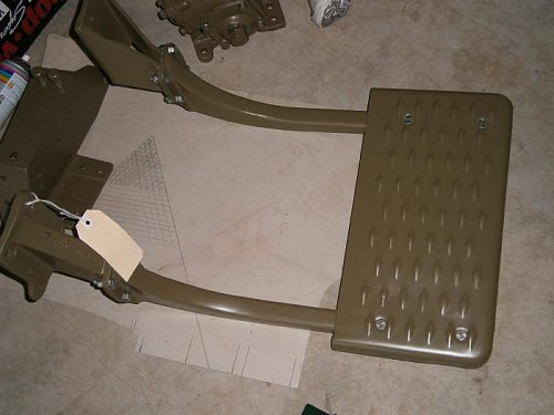

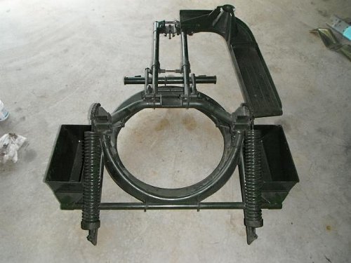

At the risk of sounding like a broken record, chassis still not home, BUT will be blasted during this week and I will be going there on Saturday to reassemble the bits that will need to be in place prior to the making of the new crossmember for rear. That will be manufactured next week.
Name:	Passenger step 1.jpg

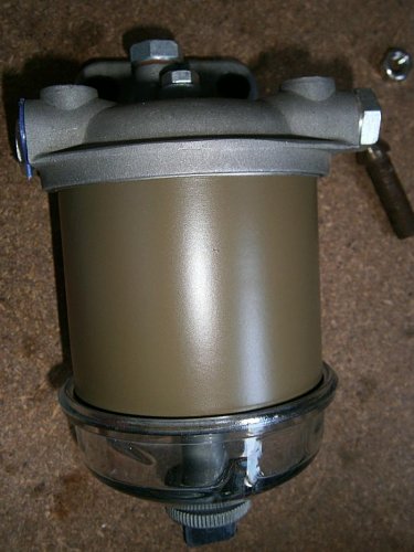

So, once again, I go on with other parts for now, including finally finishing the passenger side step assembly. This step tread not quite as good as driver side, and i'm not greatly impressed with the finished product, but there you have it!
Name:	New fuel filter.jpg

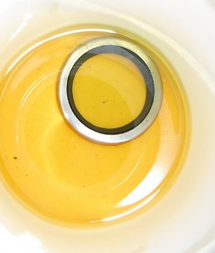

This is the new fuel filter finished. Remember it will be hidden on inside of the chassis, with an original but non-functioning filter in place on the driver step assembly behind the battery. At least if anyone does see the new one, it will be in the right color.
Name:	Booster actuator clip.jpg
I stumbled across another old booster I had forgotten I had, and found the exact part I was needing for securing the actuator piece. Yaaaay!
Name:	Steering box painted 1.jpg

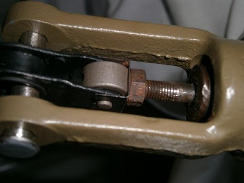

Also got the sector shaft seal out of the steering box and then got the thing painted. It's now awaiting new seal, bearing and shims/gaskets from MacsAuto. Those should arrive around mid week. Box will be reassembled this weekend, all going well.
Name:	Drag link painted 1.jpg
Drag link is now finished also, requiring replacement of only one of the ball cups (and new grease nipples of course).

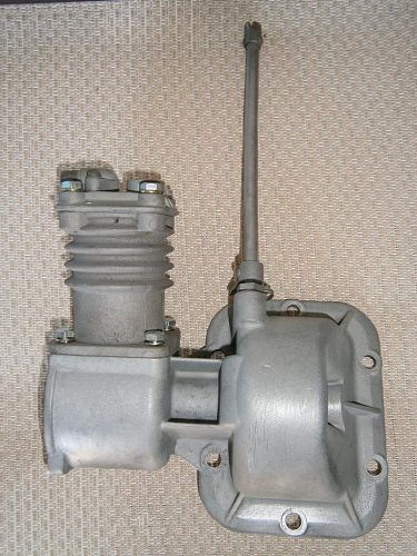

Default Gearbox mounted air compresor - PARTS NEEDED
Name:	Tyre Pump 1.jpg
Started tidying up the gearbox mounted tyre pump. This was given to me by a good friend who didn't want it.
Name:	Tyre Pump 2.jpg
I am looking for the bushing that goes on the piston connecting rod, and also the cover that goes over this assembly. If you have either of these to sell, please send me a message and i'll be happy to buy it/them from you.
Cheers!
  #733
Old 10-10-12, 13:33
Euan McDonald's Avatar
V.M.V.C Member
Posts: 627
Default tyre pump
Hi Tony,
If you can wait till next week i'm sure I have a NOS piston and rod with bush.
May even have the cover plate as well.
Euan McDonald

Old 10-10-12, 13:51
Posts: 6,003
Attachment 52589
Attachment 52590
Cheers!
Tony
If it's a bronze bush you are after , you can buy them in standard imperial sizes at most industrial bearing suppliers .

  #736
Old 10-10-12, 14:59
Default Tyre pump
Tony
Thanks Mike!

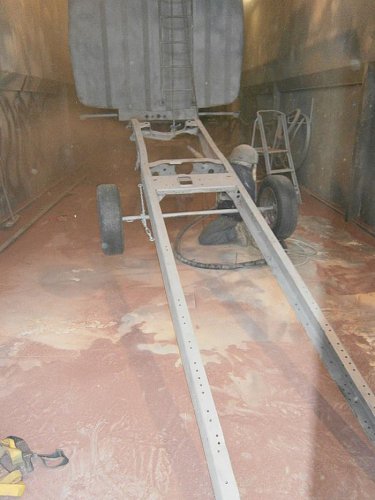

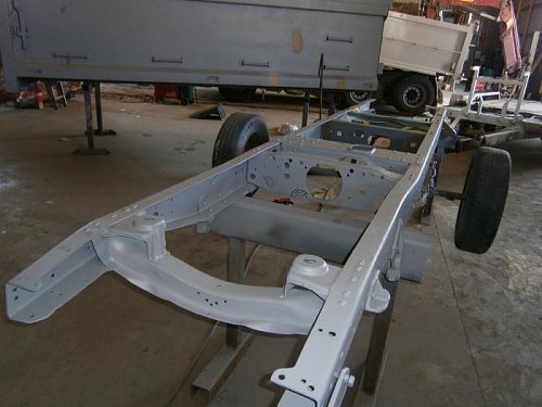

Old 13-10-12, 12:36
Default Happy, Happy, Happy!

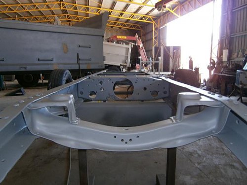

Name:	Chassis blasting.jpg
ID:	52657 Click image for larger version
Name:	Chassis blasted.jpg
ID:	52658 Click image for larger version
Name:	Chassis primed.jpg
ID:	52659 Click image for larger version
Name:	Chassis primed 1.jpg
ID:	52660 Click image for larger version
Name:	Chassis primed & x members bolted on.jpg

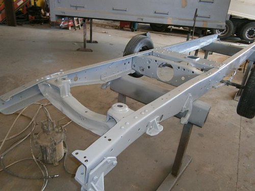

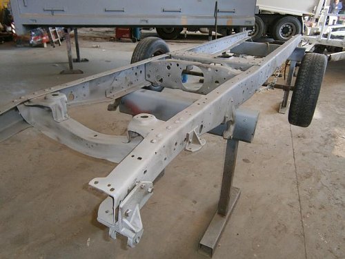

It's finally happened!
The chassis is blasted and etch primed.
The job was achieved this morning, being a joint effort between the Engineering Manager and myself. He did the blasting. I did the spraying (after Brad, the Manager, mixed the paint), and then spent quite some time bolting the parts on when etch had dried. Only bolted the parts that are needed to maintain the dimensions for measuring and attaching the new rear cross member.
Yes, I do know there are two plates missing from the current aft most x-member. Because the chassis is shortened, the height of chassis wall is greater, meaning the standard brackets will not fit. A problem for another day.
It's now safe to state that the serious concern I had some weeks ago is NOT an eventuality. I had heard rumors (from two sources) that the engineering works was actually going broke, and due to shut down on either the week I posted or early part of following week. It wasn't sporting to indicate that sort of thing here, at a time of uncertainty. As it turns out, they are going strong, with more work than ever. In fact that's been the delay with my chassis. Their regular money comes from the sort of thing you see in the first photo, above. That's a truck mounted water tank, completely fabricated on site. My stuff has had to wait until they could spare the time to 'play around' with it.
Hope to have the chassis back home within next 2/52. Wouldn't be bringing it home next weekend even if it was ready. That's the Military Jeep Club of Queensland' Canungra meet and swap. Won't be missing that!
I'll be satisfied, so long as chassis is painted before end of November. It can sit and harden further while i'm on holiday.

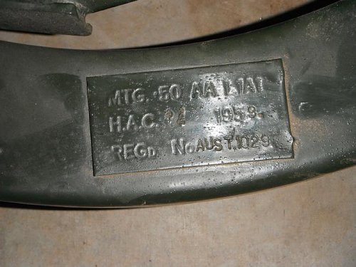

Old 20-10-12, 12:18
Default Great Day had at MJCQ Canungra annual meet

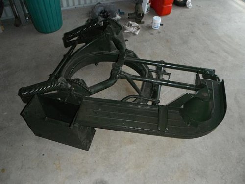

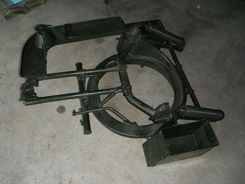

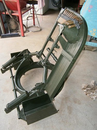

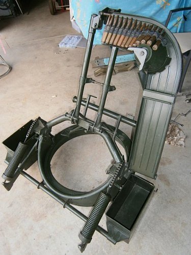

I'll post a series of vehicle photos on a new thread, but here is my major purchase.
I just couldn't resist this 1950s Machine Gun AA Turret. It had been taken out of it's box only recently, and while my pal (Andy) and I took the side bins off to get it in back of my sons car, I saw the ball-bearings in the traverse mechanism did not even have a scratch on the military paint sprayed on them when constructed. It's a heavy bastard. Two of us required to get it into the hatch of the lads Ford Focus. Wish I had taken a photo of it in there, but don't want any evidence to be found.

It works beautifully, and once home, I found the springs for elevating the weapon have a great deal of adjustment, so I can attach a lighter replica without it being facing straight up in the air.
I love the ammunition belt track! Can't wait to try a chain of cartridges I have.........somewhere
There were 4 of these available for sale. Well, actually 3 when I left.
I now have the steering box sector shaft seal, and it's having a little swim tonight. Will get the box reassembled tomorrow afternoon.
Name:	steering box seal new.jpg

Tony, These were made by the Howard Rotavator Co. and I think were an experimental .50cal. mount. to go on the roof of the Mk1. International 4x4.
They were not adopted by the army, although there are a few photos of the up on the cabin roof around. (A previous thread has them.)
Regards Rick

Here is a pic that I acquired from the Proof & Experimental Range at Monageetta, Vic.
This should be your mount....

Thanks for the information and photo, guys!
So if not adopted, does that make em an unusual find...........or dirt common because the army disposed of the lot.
If mounted as the photo Darrin posted, wouldn't it be a bugger to use? Where does the gunner hold onto? There is a thick metal tube that has a complex two part release catch, and in the 'stored' or locked position it is sitting right down against the traverse ring. I originally thought it was a release catch for the locking mech. but I looked closer today and it has absolutely nothing to do with the locking catch. Could this actually be the piece that gunner holds onto, with the two handed release catch being the firing trigger?????
In the first of the following two photo, you can easily see the part I mean. It is the thick tube running across behind the two shafts that run parallel to the gun itself. The two part lock system can be seen too and it would be roughly where the hands might be if placed like in your photo, Darrin.

I guess I start searching for more 50 cal shells now! These were enough to fill the top row of an ammo box with some to hang out of the box with lid ajar. Majority of the ammo box was foam padding. I don't remember exactly why I did this, but it was about 10 years ago now, at least.

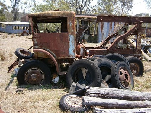

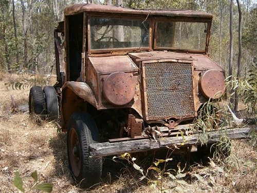

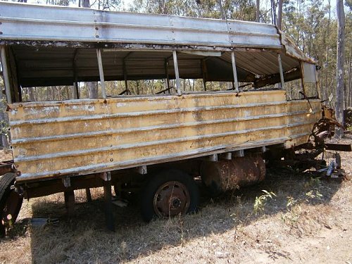

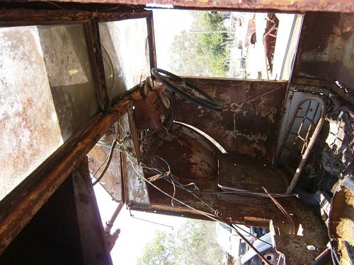

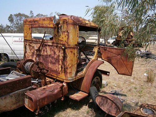

While at Canungra yesterday, I was given some very bad news relating to a lovely old gentleman (well, only 70yrs old) who had been a source of mine for a range of CMP parts. I was shocked to hear that this fellow had passed away a couple of weeks ago. For more than 6 months I had been passively trying to find the time to re-visit and show photos of my progress so far, and point out the particular parts I had purchased from him. While he has not been a very well man, I had no idea that he had recently been diagnosed with liver cancer. I believe he was in denial of his prognosis, right to the end.
A kind & friendly old fella, and he will be greatly missed. Don't put off visiting distant friends or family, they may not be there when you finally get around to the visit. to you old mate.

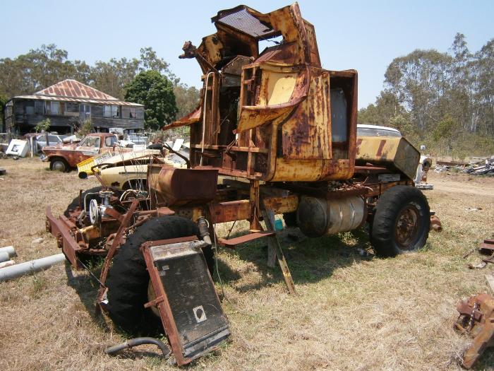

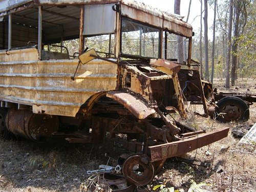

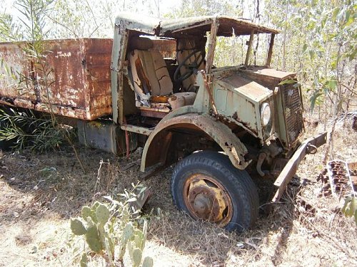

Hearing the sad news, I went to go see his brother today. He actually lives on an ajoining property. Over a cup of coffee, I was told that an auction was being considered for the remaining blitz wrecks that remained on the property. There are one or two that still run, but are rough to look at. The rest would donate parts, though none of those would be restorers in their own right.
Two of the trucks still have the doors on em, and those doors are in VERY good shape. Two are about the same condition as the set I restored for my truck, and the other two (there may be more I didn't see today) are in superior condition. I think this pair were Ford too!
I will post 5 sets of photos, starting here, to show these trucks and some other items which may be of interest. I hope some of the rare bits like doors etc end up surfacing for purchase, but thats not been decided as yet.

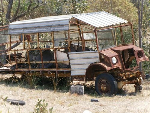

ID:	52849 Click image for larger version
ID:	52850 Click image for larger version
ID:	52851 Click image for larger version
ID:	52852 Click image for larger version

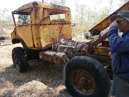

  #748
Old 21-10-12, 13:24
Default Rural CMP wrecks & stuff

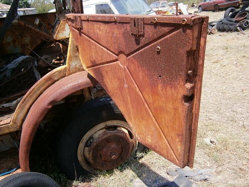

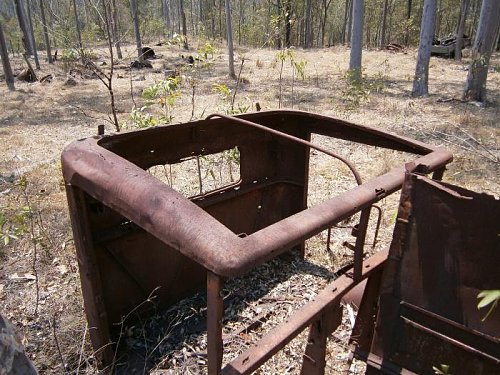

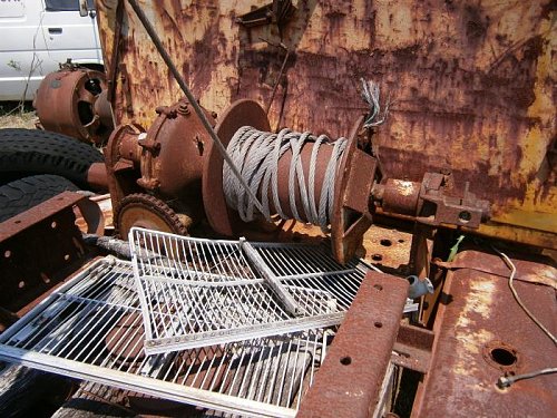

This place has so many bits & pieces that you come across. The stuff is just laying in the grass, ready to bust a toe on.
ID:	52854 Click image for larger version
ID:	52855 Click image for larger version
ID:	52856 Click image for larger version
ID:	52857 Click image for larger version

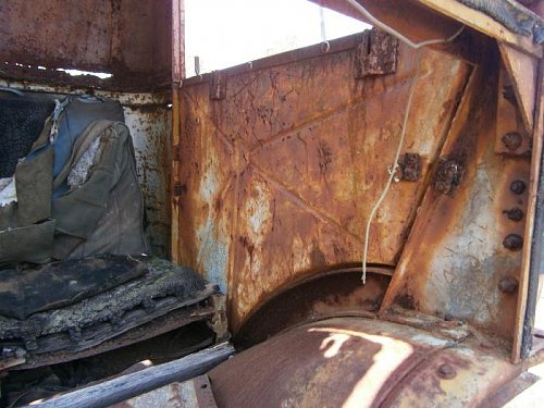

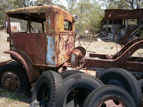

  #749
Old 21-10-12, 13:34
ID:	52859 Click image for larger version
ID:	52860 Click image for larger version
ID:	52861 Click image for larger version
ID:	52862 Click image for larger version
