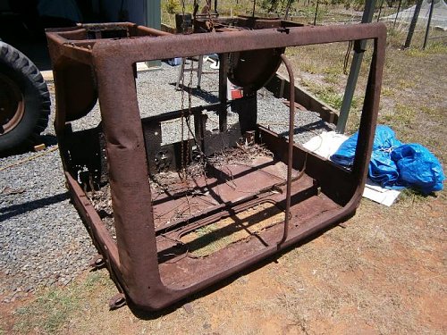

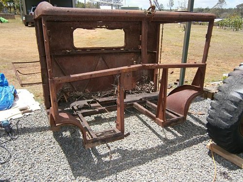

Took the scrap cab I got yesterday off the trailer this morning and started removing the sunshine roof frame, Bren Gun mount thingy and some other little but potentially useful parts.
Name:	Sunshine Cab 1.jpg
The roof frame is in excellent condition. It cleaned up very well, with the wire brush, and I will take it in for blasting later this week.

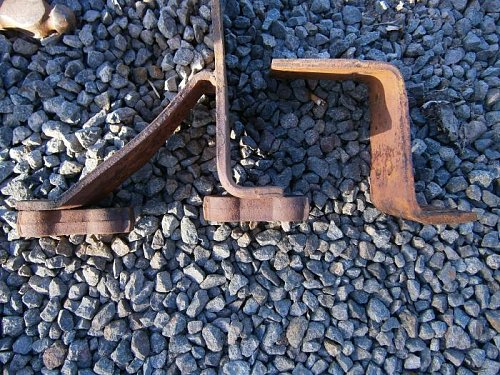

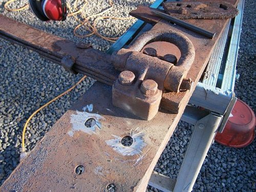

Default Ford Bumper parts.
Name:	Bumper tow brackets.jpg
Got a ratty bumper bar yesterday, I wanted it for the two towing loop brackets that also secure the sprung bumper frame. That spring frame is not bad either, and will be kept. The bar itself is bent like a banana. Useless except for scrap value.

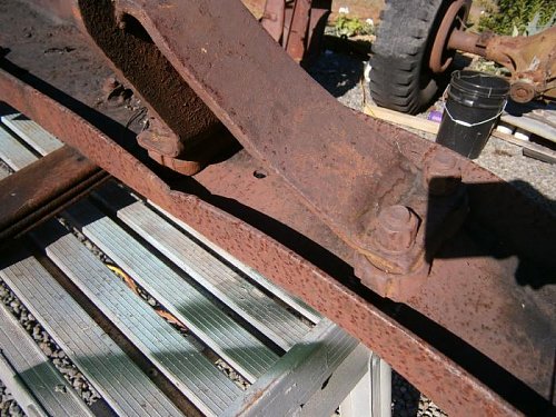

The bumper bar brackets are worth keeping, but I don't understand why the larger one (with Y piece) has thick metal spacers between bar and bracket. The other bracket does not. They don't look to have been butchered, and look as if they may have been there from original production?!?!?

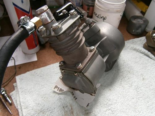

Name:	Tyre pump assembled 1.jpg
Reassembled the tyre pump, last Saturday, for something different to do.
Hi Tony,
Those spacers are correct according to quite a few Blitzes I have seen including mine.
Without them they bumper would be cocked off perpendicular to the frame.
Why they are there is the big question? Perhaps a design mistake on the dimensions of the Y bracket from day one fixed with a relatively inexpensive cast iron "dog bone". Maybe someone has the definitive answer out there, but they are correct and do belong there.
Brgds,
Jacques

Yes, they belong there and I think you're right Jacques, but as to why they didn't just modify the brackets to make it fit is a mystery to me.
That bumper is a 44/45 pattern one with the spring bumper (as it's called in the publications of the time) mounted in front rather than behind the bar. It should also have small holes at the ends where the jewels (green reflectors) normally go.

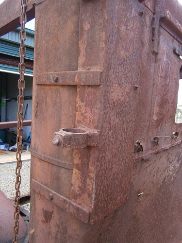

When you scraped the roof remains did you notice the remains of a bracket protruding from the front of the roof? This was a sun compass mount found on sunshine roof's. The sunshine roof's were only found on C15A, F15A and the odd C/FGT#6.
Do you have the angle bracket that secures the canvas inside the front of the roof? (I have repo’s available).
You are correct regarding the shovel bracket inside the rear of the cab. I have also see them mounted off the rear of the step / corner of cab.

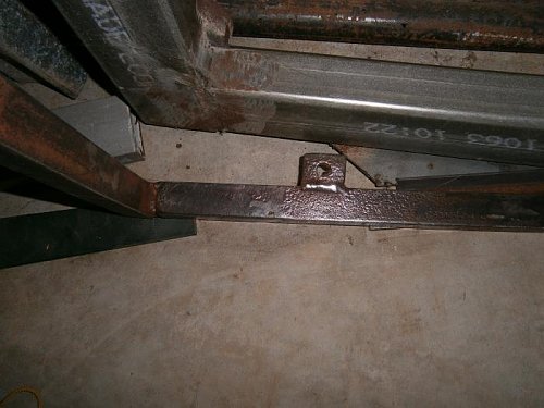

Didn't see any hint of bracket on front outside cab, but there are the two places where canvas attaches inside cab front. At least, I think that is the same thing. I'll get a photo to show you what I have. If it is the same thing, the bolt part is gone on both. I did see a large wing nut amongst the folliage on cab floor. Wished I had kept it now.
I did find a bracket on right side which Has a little piece attached that would hold a sun visor. I'll take photo of that too.

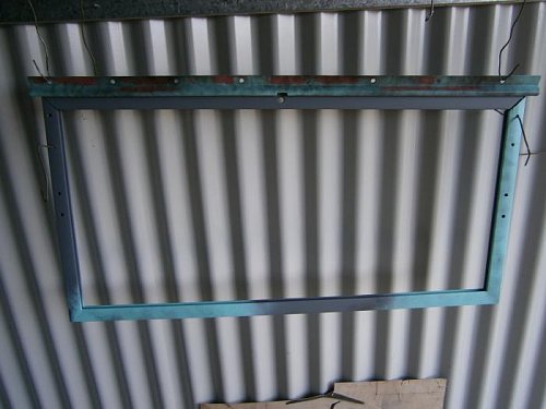

Default Sunshine Roof Details
Euan,
Name:	Sunshine roof frame 1.jpg
ID:	53262 Click image for larger version
Name:	Sunshine roof frame 2.jpg
Assuming I have photographed the correct piece, this is how the brackets on mine look. Not exactly like your posted photo. I like yours better. Would be keen to see the repro pieces you have. Though this type of roof is not indigenous to my truck, I really like the look and will install one. I have several cab rooves, so I can do one with a hatch as well......later.

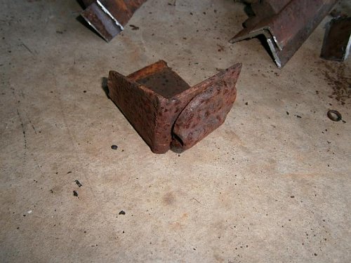

Name:	Shovel holder parts.jpg
These are the shovel holder parts I saved.

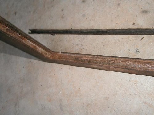

Default Driver side window frame

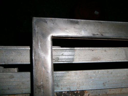

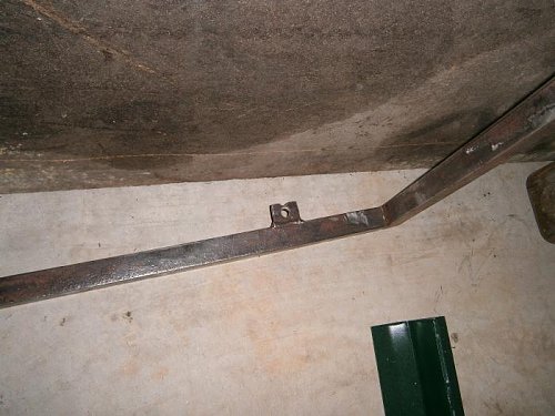

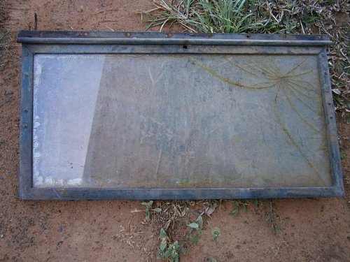

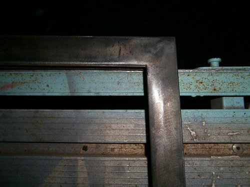

Just before stumps, I made a start on disassembling the passenger side window frame that I intend to reverse, effectively making the driver side.
Name:	Driver side frame without glass.jpg
ID:	53268 Click image for larger version
Name:	Driver side frame without glass 1.jpg

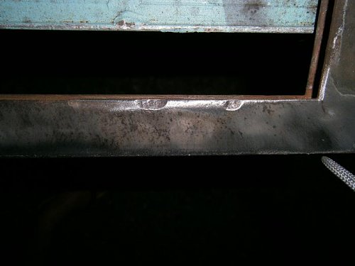

The original bolts that hold the two pieces together were intact but would not budge, and needed to be drilled out. Today was the day that my drill decided to drop dead. I was given this drill by my Father on my 16th birthday. I didn't think this tool would ever fail. It's given faultless & faithful service for many a year, and it saddens me that I have lost this piece of history! I will find an identical one some day & fix it!
Name:	Driver side frame stripped 1.jpg
ID:	53270 Click image for larger version
Name:	Driver side frame stripped 2.jpg
Ran the wire cup over the frame quickly, in the now twilight, using mostly 'The Force' to know when I had removed all the paint. This frame has only ever had the one layer of paint. Olive Drab, and tough as nails. What did they know about paint 70 years ago that we don't know now?
Name:	Driver side frame worst rust.jpg

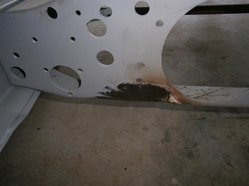

I previously described this frame as 'entirely without rust'. That was not exactly correct. This is the patch of rot I found on what will now be the outside of the frame. A tiny smear of filler and a lick of sandpaper will see it to rights. All the rubber seal came away, and didn't put up much of a fight against a screwdriver blade. The glass channel still had the fibre bead bed intact. I couldn't save it all, and wouldn't have used it even if I could get it out undamaged. You can see lengths of that beading in the first two photos.

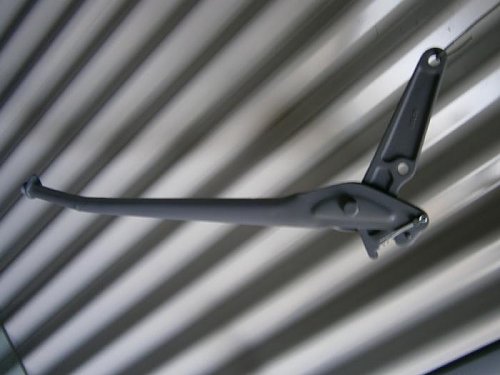

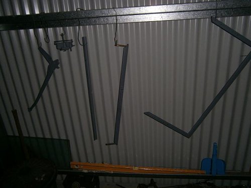

I spent the A.M in workshop (actually outside in the sun) stripping and priming the windscreen frame. Some may recall that when I did the passenger side window, I had trouble getting the hinge to allow window frame back to the closed position. No such problem this time. I beat the snot out of top part of the hinge, effectively allowing easier 'closed' movement. Hope it still opens more that 1/4" now.

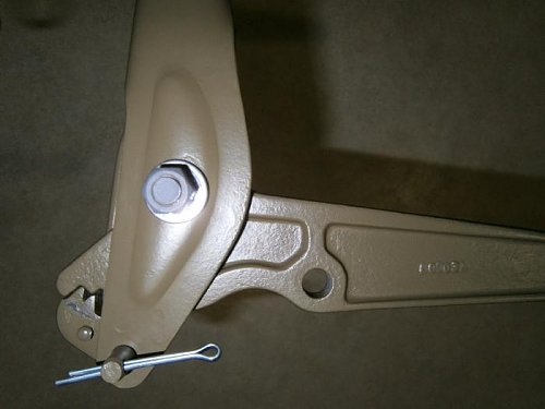

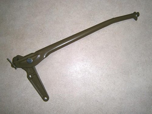

Andy, if you are reading this, I have made one very good handbrake lever & ratchet/ratshit from one we got Sunday & stuff I had in stores.
I'll take photos of todays work when I can. This evening is my Sons graduation, so work ceased early.

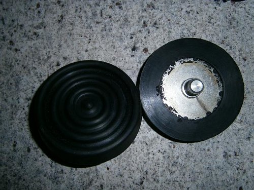

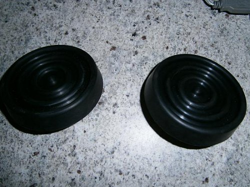

I had ordered a pair of brake & clutch pedals (Ford) through ebay on Tuesday. They arrived this afternoon, and are a perfect fit!
Initially, I was unsure what style the rubber should be, but saw two vehicles last weekend that still had their originals, albeit badly decomposed and dried rubber. Both matched the pads I have bought.
Name:	Pedal pads 1.jpg
ID:	53331 Click image for larger version
Name:	Pedal pads 2.jpg
These cost me $12AUD each, and both were shipped from interstate Australia for $9AUD. So for $33 I now have perfect pedals.
I'll be spending this evening modifying (cutting) a length of rubber windscreen seal that will be installed on the driver side. Didn't get a chance to do anything today, but should have the window frame sanded, reprimed, and possibly even painted tomorrow. Having said that, weather forcasts foretell heavy thinderstorms over weekend, so these plans may change.

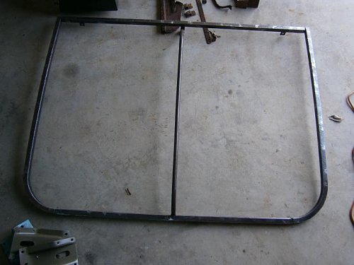

Default Windscreen frame
Name:	Driver side frame primed 1.jpg
ID:	53367 Click image for larger version
Name:	Driver side frame ready for top coat 1.jpg
Windscreen frame for driver side is now ready for painting. Sanded the putty yesterday afternoon, and reprimed a single light coat for protection from elements until painting gets done.

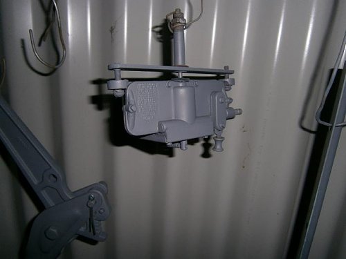

Name:	Wiper motor driver side primed.jpg
I had forgotten what a pain it was removing all the paint from wiper motor body. It was original military dark green color, but had to come off as areas were flaking from 70 years of aging. Painting over this, even if I could have sanded edges, would be a very poor decision. For all painted surfaces, my preference is to remove ALL previous paint, no matter how sound it first looks. Some very unusual things can (and do) occur days, weeks, months and even years after finished. Painting is easy, preparation is a pain in the sphincter!
Name:	Hand brake lever primed.jpg
Hand brake lever assembly has been stripped, cleaned out and primed, to be painted with the windscreen frame. The lever assembly is a mox of parts from two vehicles. Some of those parts came from last weekends pilgramage to CMP wreck mecca.
The new windscreen rubber is now ready. It was created on Saturday night, by modifying an over the counter piece of Ll shaped seal, removing one of the two 'sides', making it an L shape instead. the long side of the 'L' goes on the outside, with butly mastic sealing the inner edge. Gives quite a neat look, but I would remove it in a heart-beat if I could get my hands on some of the original fibre seal. Now that I know what original jointing for screen glass looked like, i'm not surprised the glass channels rusted heavily. I expect the fibrous, almost cardboard, original screen seal would hold moisture very nicely, brining on the oxidising process+++. Still, as the original item, I would prefer it, but have never seen any!
I am hoping to get the parts painting done today, but that may not happen if weather does not change. There has been light rain all through the night, and lots of lightning. If not too much rain, it's a good day for mowing. Very little rain has fallen in many weeks and now is best chance to avoid the cloud of dust normally associated with mowing over dry ground.

Name:	Hand brake lever finished 1.jpg
ID:	53452 Click image for larger version
Name:	Hand brake lever finished 2.jpg
ID:	53453 Click image for larger version
Name:	Hand brake lever finished 3.jpg
That hand brake lever came up fairly good.
Certainly a little better than when you saw it last, I hope. Finished it while doing the windscreen frame painting, to make mixing the paint worthwhile.
Yet another part to store carefully until needed in months/years.
I reassembled the driver side windscreen this evening. Hmmmm, it's OK I guess, but not perfect. Temporarily installed the outer seal and cut the corners, ready to glue tomorrow afternoon. It's funny to see so many restored vehicles which don't have the outer seal parts joined together, just all sitting there seperately. All for the want of a 'bees' of super glue. Just leave a slight bit more length than minimum. The rubber may shrink over time. From my experiments, the glue wouldn't break though. I did a test on a scrap piece before I did passenger side, and flexed the joint back & forth for a couple of days, until I got sick of that and pulled the bits apart. Glue remained, rubber broke apart.
I have booked the car transporter trailer for 0800hrs Saturday A.M, so I am going to get the chassis, one way or another. Not losing my rental money! It better be ready for me, or.........."Don't make me angry, you wouldn't like me when i'm angry"

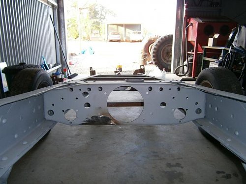

Saturday morning I got the chassis back. As usual, it wasnt ready when I arrived to get it. One weld repair, and the holes for the two pintle brackets were not done. Despite me providing a photo, the guy that made the cross member fabricated it the way they do for large trucks and not as per the clear photo I had supplied.
I am grateful that all the holes line up, and after I did an awful lot of cleaning, smoothing and etch priming, I tightened the bolts and checked the chassis alignment. Almost dead straight!
Photos will follow when I get back to my computer. This portable device doesnt shrink the photo size easily.

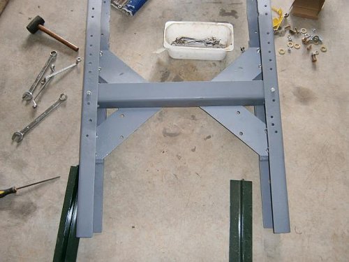

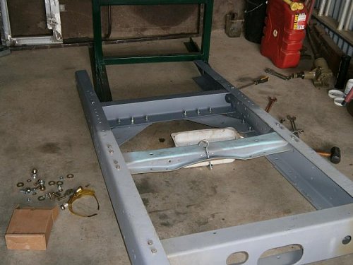

Default Chassis Work

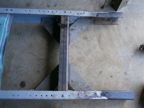

Name:	Chassis repair 1.jpg
ID:	53520 Click image for larger version
Name:	Chassis repair 2.jpg
ID:	53521 Click image for larger version
Name:	Chassis repair 3.jpg
ID:	53522 Click image for larger version
Name:	Chassis repair 4.jpg
ID:	53523 Click image for larger version
Name:	Chassis repair 5.jpg
Finally back on the computer again. Here are the photos showing current state of chassis. Waited 2 hours while they finished the work that was 'ready' for me to pick up. It did give me opportunity to see how they drill holes, and how they cut larger round holes using the Oxy-Acetyline torch. That was quite impressive to see actually. I took the pintle brackets off before I attempted to trailer the chassis home. They would have been too heavy for me to safely 'wheel' the chassis around on the axle I have temporarily chanied, for mobility.
I kept a real good watch on the rail alignment as I torqued each of the bolts around the rear member etc. Pleased to say it wouldn't be more than 2mm out of true! Yay!!
You will note that the rear cross member has a cut-out section at each end, unlike original. This annoys me, but in reviewing the photo I had given them, the ends of the rear member are actually VERY difficult to see in the photo, not that I believe the photo ever was shown to the guy that did the work! This method is how they do all replacement cross members for the heavy vehicles they do. It's supposed to give greater ability to flex. I have no plans to alter this now. I will be putting a second bolt on top surface of the cross member, and will need to add another hole underneath, where the spring hanger bolts through chassis base.
The new sections of chassis rails look good, too good really, because it's the only part of the chassis that doesn't have a surplus of holes along it.
It is ironic that I finally get the bloody thing home, just days before we all depart for annual holiday, so no work will be done for roughly the next 2 weeks. The new security system and neighbour with 12ga will deter would-be thieves in our absence.
I will have my tablet device with me on holiday, and hope to be able to post from a 'historically significant' location.....or two
