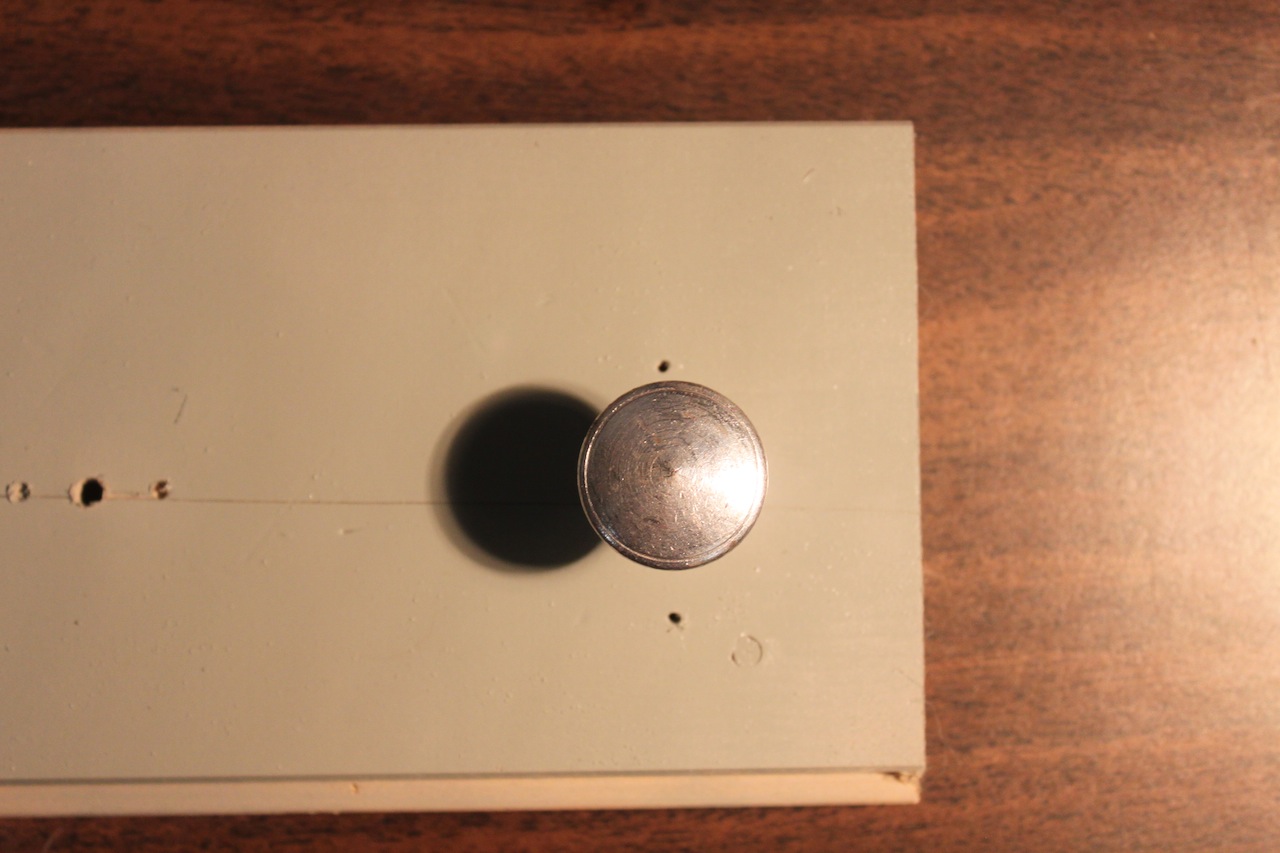

The Knobs, Metal from the front panel of the Vibratory Supply has now been cleaned of all its old paint and is now ready for a coast of its galvanized metal primer.
Notice the ring cast into the zinc around the rim of the Knob. With all the 52-Set components I now have on hand, there are a total of 11 Knobs, Metal to look at and this is the only one to have this ring. All the others have a smooth front face. It is possible Canadian Marconi was contracting with two suppliers for these Knobs, but if that were the case, one would expect to see more of these ringed examples, particularly given the random locations throughout the 52-Set production run that all the serial numbers on the components fall.
Then I recalled the Philco stamp on top of the Power Transformer in the Vibratory Supply. At the time I found it, the simple assumption was Philco was contracted to make these transformers for Canadian Marconi, but is it possible Philco was actually a sub-contractor for the entire Vibratory Supply assembly, and they in turn had a different company casting the zinc Knobs, Metal they needed to fulfill their contact?

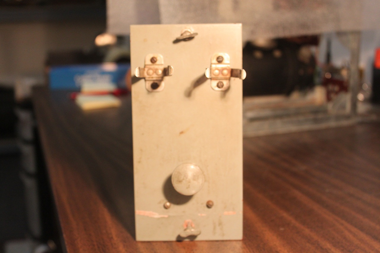

Default SUPPLY UNITS, Vibratory, No. 52 ZA/CAN 4354
The two SEMS screws that fasten the front panel to the Vibratory Supply chassis have now been cleaned up. A couple of photos showing just the left one cleaned, and then both on them.
Everything is now ready to go for the reassembly of the Vibratory Supply next weekend.
The week will come in handy, as there are a number of options I have to consider regarding how best to proceed with work on the main Supply Unit assembly.
A startling -47 degrees Wind Chill here this morning. It wasn’t just a couple of Sun Dogs surrounding the Sun today, it was a whole freaking wolf pack! A good morning to stay in and think, however.
There are a few things with the Supply Unit of this 52-Set that need to be looked at and fixed. The big one, eventually will be the removal of the front panel so it can be repaired, repainted and a new set of water slide transfer decals applied. This latter task will be huge, taking a while and requiring we get a new computer and the necessary software to do the job easily and well, as far as making the decals is concerned. So that huge task has to wait a bit yet.
My thought process is to first check the two Rotary Transformers to see if they are still working correctly. Having had a look at one set of end bearings on each of these items now I am comfortable the bearings are in good shape and will be OK for the duration of running time they will go through to get reliable output readings from them. This exercise will provide very useful information, both now and down the road when they are removed from the Supply Unit for repacking the bearings.
The second thing that came to mind was the hardware issue that is causing the Vibratory Supply Case to bind when being inserted or removed. This hardware is located on the left front corner of the AF Choke (L28A) in the MG1A Secondary Circuit where it is serving as the Smoothing Filter.
In the attached photo, you can see this Choke directly under the Blower Motor. The left side of the choke passed roughly half way between the right end on the Blower Motor capacitor and its cotton lacing and the errant hardware set is sitting pretty much under the front rim of the metal grommet on top of the Blower Motor where its two leads exit.
On the bright side, there is only one lead that needs to be unsoldered leading to the blower assembly. The rest is just hardware: four hex nuts to release the COVERS, Metal, from the front panel and then three large screw to release the Blower assembly, which should then just swing out the right side of the Supply Unit chassis. That should expose the AF Choke hardware that needs fixing and also allow me to clean the Blower Motor and more importantly its fan, which is filthy. And with that all done, I can reinstall the blower for the time being and more importantly, I can reinstall the restored Vibratory Supply assembly and keep it out of harms way.

There was wee bit of a challenge in the very first step of fitting new cross pins to the two Shakeproof No. 18 Cowl Fasteners. I was able to seat them with the Cross Pin Setting Tool, but the resistance was too high when I tried getting then centered so I ended up having to tap them home with a small hammer. An interesting exercise I am glad is over.
Once the two cowl fasteners were reattached to the front panel, the next step was putting the panel back on the front of the Vibratory Supply. Since there is a significant overhang of the bottom of the panel, I set the Vibratory Supply up on a pair of small wooden blocks to clear the bottom of the panel from the surface of the bench. Then, after the Knobs, Metal was loosely fitted, I installed the two SEMS Screws, also to a loose fit. The three holes in the front panel for these pieces of hardware are slightly oversized. This allows one to ensure the bottom edge of the front panel is square to the surface the Vibratory Supply is resting on. In that way it will also be square to the front panel of the Supply Unit when reinstalled in it. This hardware was then given its yellow lacquer on the inside and the two Clips, Metal U-Shape for the drop cords were put back on. Again, there is just enough wiggle room with this hardware to allow one to ensure the outer edges of the clips are parallel to the outer edges of the front panel before carefully tightening them down. With this hardware given its yellow lacquer, another small bit of the project done.
WS No. 52 Supply Unit 53.JPG   WS No. 52 Supply Unit 54.JPG   WS No. 52 Supply Unit 55.JPG   WS No. 52 Supply Unit 56.JPG   WS No. 52 Supply Unit 57.JPG

Back in Posts #765 and #766, when I first decided to tackle some of the work on the Supply Unit, I had discovered a small patch that had fallen off the upper rear corner of the left side of the case for the Vibratory Supply. It had been lacquered in place to serve as insulation to shield some wiring on the main supply unit from accidentally contacting the side of the case.
At the time, this small piece looked either made of a thin’ plastic, or thick manila sheet. On closer inspection now, I am pretty certain it is a thin plastic. Over time, it had developed a few ripples in it and was proving difficult to get to lay flat again on the side of the case.
I decided to use some old clear nail polish my lovely Wife had donated to the cause, due to the polish having turned a light amber, to reattach the patch. As soon as that was done, I set one of my hydraulic jacks on top of the patch to weight it down and fired up my heat gun on low heat (350 degrees F) and directed the airflow into the back corner of the case, under the jack. I did that for almost two minutes. At that point, the rear sheet metal of the case was uncomfortable to the touch and the base of the jack was warmer than room temperature. The heat gun was then turned off and the entire assembly allowed to cool down for 6 hours. Quite pleased with the result.
Now there are a couple of items to address on the Supply Unit itself, related to the Vibratory Supply.
WS No. 52 Supply Unit 60.JPG   WS No. 52 Supply Unit 61.JPG   WS No. 52 Supply Unit 62.JPG
