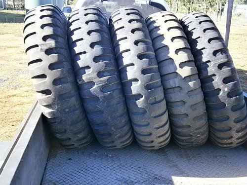

Tyres bought

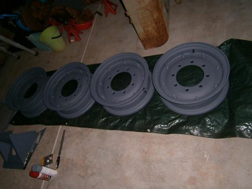

Wheels blasted & etch primed

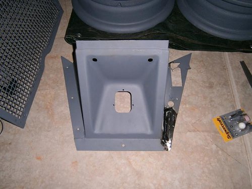

Lower engine hatch blasted & repaired

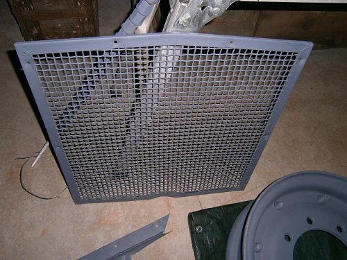

Grille blasted, following previous reworking of mesh.

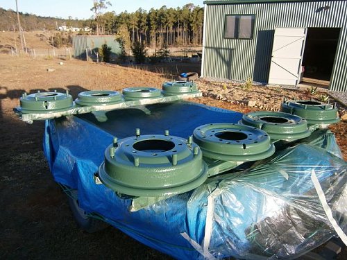

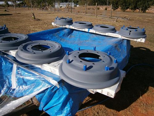

Spent 60min masking my trailer, ready to paint insides of wheel halves.
Wanted to do the insides first to test paint spraying technique and finish. Learnt many years ago, you always do the bits you don't see first when spraying in 'unfamiliar' territory.

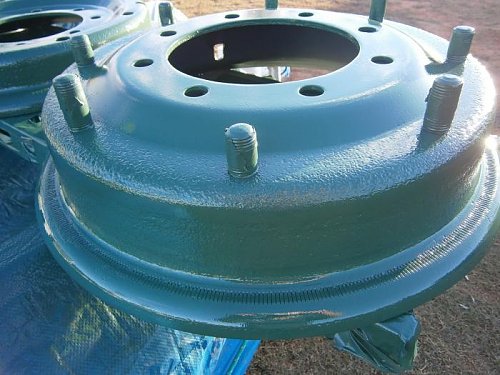

Lovelly shiny finish isn't it? Pity it's bloody well meant to be almost flat finish!!!

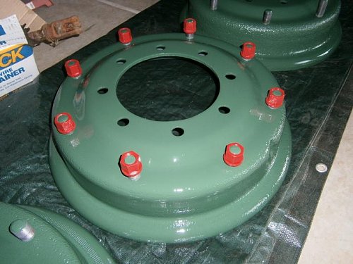

I have had the same problem that Lloyd McCarthy had encountered with his Cab 12, Gun Tractor. Being that the flattening base for mixing with gloss paint does not provide much flattening when used at specified strength of 5%. Before I attempt the outside of the wheels, I will ring Lloyd for his final strength of base. His truck looked sooo good, and has the precise look I want. Lloyd is a perfectionist.
Fellow MLU'er, Andy Cusworth dropped by this afternoon, while in the area for a local historical Steam Rally. He helped me to get the final two wheel nuts loose and the wheels will be coming off in near future while axles are worked on. Rear first. I never had any hope of removing the stuck nuts before today, because only last night did I consider the possibility of studs being replaced with wrong thread direction. I checked today......and yep......thats whats been done, so I'm very glad I didn't force the issue and wind up with busted threads. If I end up using this rear axle (I have another, good one) I will write to Dirk at LWD and have him send replacements.
I couldn't resist threading the 'danger' nuts on, just to admire the two colors together!
Has anyone realised what color the green I chose is?
The answer is in one of the photos ;-)

They do actually do a 2 pack ADF system . It's called BARRIER PU 601 ...$70 for 4 litres and $30 for the hardener
The stuff your thinking of is 342 Camoflage enamel .
Mike,
I spent 90 min at the auto paint shop this morning/afternoon. The formula Bob supplied was apparently unable to be replicated in the Automotive 2 pack I wanted. This is the paint I used and was impressed with last weekend, when to insides of wheel halves were sprayed. In fact they said they didn't have a "yellow base" to start formula. Also, the mixing formula letter combination confused them, so no good with that, apparently. Couldn't get their head around the whole timber VS auto side of the process either.
If you read my recent postings here, you will recall Protec email responder stating they do NOT supply 601 without ADF approval. My local paint shop did not have ADF in 601, and couldn't find it in their database. They did feel it could be restricted, but will check for me. So TBA.
On the other hand, 342 Camoflage paint, enamel, is a standard pre mixed "lustreless" formula in three colors (they think). As fortune would have it, they actually had a 1L can in back room. This I have bought, in addition to a compatable hardener, effectively and literally turning this enamel into 2 Pack. The hardener is urethane! And NO FLATTENER NEEDED for mixing. I will study tech sheets tonight & trial this paint tomorrow, painting outside of the wheels. The insides will then be of darker color, which is regrettable, but being insides won't make a lick of difference, except I will know......and now you too.
Depending on whether I can deal with the color difference, I may even respray insides at later date. On the other hand, if the 342 is not satisfactory finish or quality, i will have wheels re-sandblasted and start from scratch. The enamel / 2 pack '342' paint will probably NOT allow recoating with another type of paint.
The 324 is considerably cheaper than 609 but is still around $45 a litre. At least they think so, couldn't actually find a price for this on the computer either, because it is used so rarely that they deleted it from sales files.
