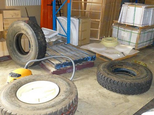

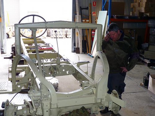

Posts: 206

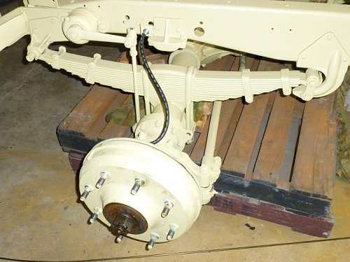

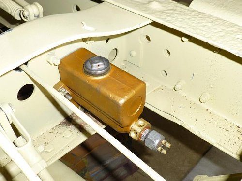

Here is Hugh talking to Keith about my truck and the brakes.
We got a lot done in one day but we were held back by a leaking hub
Happy to get this done today.
Got all tyres on the rims as well thanks to Hugh showing me how.
lWell this is me very happy with the progress so far
F60L Cab 12
  #63
Old 31-07-13, 14:39
Default Ahah...
So that's what Hugh looks like when he's talking to me.
Has anyone else seen this brake hose setup on a Ford 3 toner? Usually the first hose goes to the diff, then there are pipes to each steering end then a hose to each wheel cylinder from there, making 3 in all for the front.
The two hose setup I have seen on the F15...
On Chevrolets it is more a case of early trucks went from the frame direct to the wheel cylinders and later was frame to differential and then out to the wheels. There was a Chevrolet Service Bulletin listing the process to convert from the early setup to the later one. I don't know if the same thing applied to Fords. I haven't seen original documentation of the reason for the change but believe it is to do with the original long hoses being more vulnerable to damage.

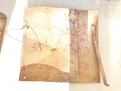

So does anyone know if this would fit the cab 12?????

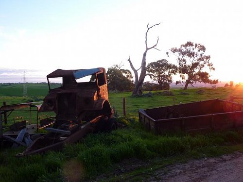

  #66
Old 31-07-13, 16:21
Ganmain Tony's Avatar
Join Date: Jul 2009
Posts: 1,246
Default Wow!
Its the later box Shane usually seen on Cab 13's.
But grab it quick, it'll fit. I ve got one one the back of mine...
QUICK!!! GO!!!! GO GET IT!!!! NOW!!!!
  #67
Old 31-07-13, 18:44
Default Drop Side Cargo Box the Cats Meow
Hi Shane
As Tony says grab the drop side if it is in restorable or useable condition. As body swapping was common, using it on an earlier chassis would not be out of place. Take a look at the pictures on my web page (link below) showing drop sides on Pat 11 or 12 in use in North Africa and else where. These photos were posted on MLU over the years. Besides it will serve until you find the perfect body.
Hi Keith I have a cab 12 in my shed with that brake pipe set up.

Default Strange brake lines set up....
On all the early Chev C15a cab 11 that I have seen they had the long rubber flex line go from a hole in the frame directly to the wheel cylinder..... with a funny spring holding the rubber brake line up out of harms way. I actually found a full box of these springs at the Weare rally in New Hampshire. The end of the spring is tied to one of the inner fender bolts.
I have taken precaution to restore my cab 11 in the same fashion. I have other later Chevy cab 12 that have a shorter flex rubber line going to a bracket to the centre of the front axle.... a steel tube then goes to a bracket, on each side, on one of the bolts of the egg cup mounting flange and a short rubber line to the wheel cylinder.
A cab 11 with chains on the early set up front axle would have had very vulnerable brake lines......

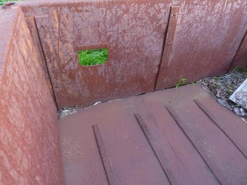

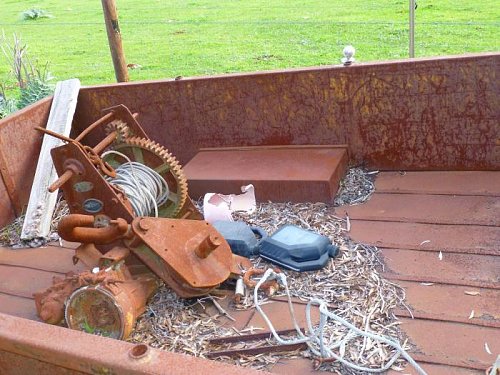

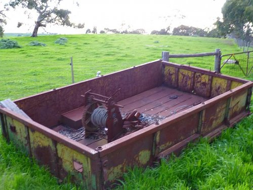

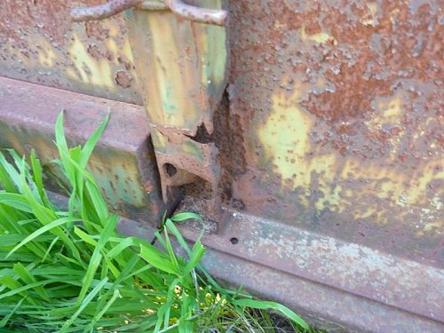

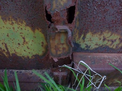

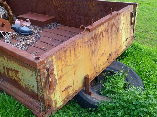

Ok lads here are more photos of the tray, still a go for me and prefer this to the original timber tray.
ID:	59227 Click image for larger version
ID:	59228 Click image for larger version
ID:	59229 Click image for larger version
ID:	59230 Click image for larger version
So let me know what you think of the tray.
F60L Cab 12
  #73
Old 01-08-13, 15:31
hrpearce's Avatar
hrpearce hrpearce is offline
WO8 C15A 142736
Posts: 1,958
It's no worse than mine and I think half the fun is working out how to fix things with what resources you can muster.
Robert Pearce.
  #74
Old 01-08-13, 17:18
Default Looks good....
Nuthin' a good body man could not fix in 15 or 20 minutes.
Bob C.
  #75
Old 01-08-13, 19:40
Join Date: Jul 2009
Posts: 1,246
Default Great find
You wont find another Shane, its well worth repairing. Having the tailgate intact is a major bonus.
Bob C - I've sent you a PM...
  #76

Ok lads here are more photos of the tray, still a go for me and prefer this to the original timber tray.Attachment 59227 Attachment 59228
Attachment 59229 Attachment 59230
Attachment 59231 So let me know what you think of the tray.
As Ganmain Tony can tell you this type of body was used to replace the body on some of the 2pdr portee cab 12s during the war. It will look great.

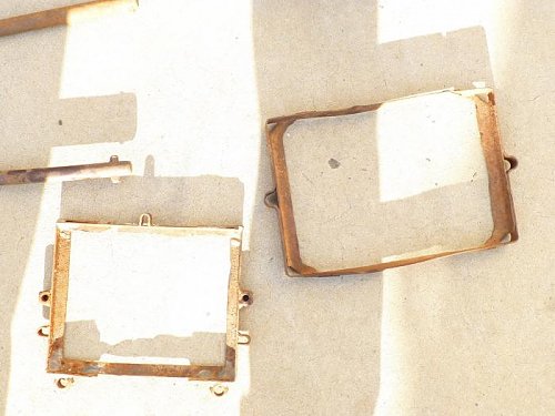

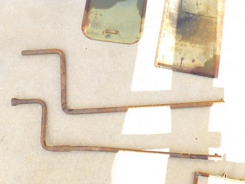

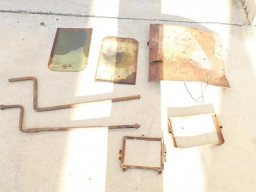

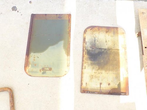

Hi lads.
These bits came in a box with the truck so i dont know if any belong with the cab 12 Any ideas
ID:	59300 Click image for larger version
ID:	59301 Click image for larger version
ID:	59302Click image for larger version
F60L Cab 12
  #83
Old 05-08-13, 13:34
Default Ideas
Hi lads.
Attachment 59300 Attachment 59301 Attachment 59302Attachment 59306
Attachment 59308
Looks like the sliding window pieces for the rear window in the cab, a crank handle (not the one with the socket), rear mudguards and battery clamp (the one on the right).
  #84
Old 06-08-13, 01:15
Shane Shane is offline
Shane Rayner
Join Date: May 2013
Posts: 206
Default Bits
Thanks Keith.
So does that mean there was no glass in the rear window or just plates? The mud guards seem to be bolted together for some reason, is the crank handle the correct one for the cab 12? Thanks again for the feed back
F60L Cab 12
  #85
Old 06-08-13, 01:47
Default Plates
Thanks Keith.
Yes, that's right but not all cab 12s had even that.
You'd need to try the crank handle and then see if the mudguards fit the body from Hugh.

Default window
Keith when you say some didnt even have that what do you mean? What no slide or glass?
F60L Cab 12
  #87
Old 06-08-13, 06:21
Default Sliders
I don't know whether they all had steel sliding panels or only some were equipped... I have never seen glass there as an original factory fitment, but sometimes this was done in civvy life.
Shane My cab 13 didn't have the sliding plates it was fitted with a canvas flap screwed to the back of the cab above the window. There is no evidence left on the cab to show how it was tied down, there are two hooks where the canvas was screwed to the cab that straps were hooked to too hold the rolled canvas up. Eventually I will fit glass.
Robert, I think all the Australian cab 13 Chevs had canvas as did Fords.

Gday all,
Shane, my (unrestored) 12 cab F15 has a glass window, as does GT's F60L (and did before restoration), also the remains of a cab 12F60L that I have, has the glass frame.
My old man told me the F15 had glass for a long as he can remember.
Of the two 13 cab fords that I have, one has the sliding covers, and the other seems like it may have had the sliding covers, too.
I know of at least one unrestored 12 cab F60L that has the sliders, too.
As with a lot of things cmp, it seems that there isn't a right and wrong answer. These things were bolted together in a hurry with whatever was available, and then modified in the field probably more than once, and then modified post-service using, again, whatever was available.
From my observations, and point of view, your truck could have originally had either. And you should fit whichever you feel you'd like to have. Don't get too worried about the finer details. It is not a GT falcon, and no body it's going to have a go at you about such details. Just get her on the road and running right, looking presentable, and you will have a lot of fans.
