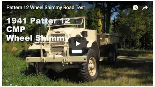

Default Little Video of C60L Shimmy
Hi All
Been working on this for awhile takes almost as much time to upload as to shoot the video. This is my 1941 Pattern 12 C60L road test video shimmy between 35 & 40 MPH. Since then I've reduced the shimmy and raised its threshold to 45+ MPH. Comments please.
Name:	Screen Shot 2017-11-05 at 8.02.54 PM.jpg
Click here for video I can't get the embed to work correctly
https://youtu.be/vTPqSBq9klA

Excellent video Phil.
All seems very familiar to me!
I jacked up each axle and set up a pointer and ran each axle static. I had found one of my wheels to have a significant variation at the rim edge. changed that wheel with a spare I managed to obtain.
In the first two years of ownership, I had these split rims apart and together more times than I like to think about (good exercise I suppose). I made sure the mating faces of the two halves were clean and that they were bolting together correctly as I appreciate that a small error here will cause the rim movement we are seeing.
All 4 wheels are now reasonably straight in that there is only slightly movement at the rim on each one, certainly less than on you truck.
Tyres do have some "out of round" movement when run static, but am not sure how much of that is from sitting for a month between giving them some exercise.
Still, As I said at 25mph the truck runs well, and that is not a problem in the areas in tend to use it.

Phil, the wheels are forged and I think that "eccentric" extra bit, is commonplace. The military Dodge rim was factory balanced. (welded on steel weight) I assume CMP wheels were as well.
I noticed the brake drum is not running exactly true. An out of round drum can be a culprit.

Phil, excellent video, however once you start on you tube difficult to stop, liked the HUP going out in the snow too.
Once those wheels start to go shimmy, it takes everything with it.
I did notice a little movement on the pitman arm draglink, (tighten screw all the way in, then back off half turn, fill with grease, sorry sucking eggs etc.) but from that view the temptation is to say the wheels start the shimmy and it just gets bigger till centrifugal force wins and pulls the shimmy back out like a gyroscope.
I will still follow the engineering principal of 1 item at a time, then I will know.
So, will get the springs done, then balance the wheels, and try to post a video like you have done, might take longer for me to do that than strip the truck!
Should be out for a roadtest this coming weekend, if all goes as promised.

Phil,
Some other points,
truck sounds real good, accelerates well, gear changes, wow, so smooth and quiet.
The following are random thoughts that may get me somewhere, or not.
I am tempted to try something a bit different.
What if a weight was placed, of a significant size, on the wheel and then run again. If the shimmy was worse or better, then wheel/drum imbalance is the cause. It is a theory, if it can be made worse, then the opposite should make it better.
I have a box of stick on weights, will try, 100g strips, a couple should do something.
Then using the logic of the on car balancer, using the tyre valve as a starting point, should be able to do on road balancing. Problem though, is one wheel at a time is the best way, some more thought perhaps.
Not overly keen on testing one wheel at a time on axle stands, the way it shakes could be a bit more excitement than I need.
The welded steel weights on the 3/4 ton Dodge wheels (I think supplied by Budd) seem to be a standard weight in a standard position to compensate for the valve stem cutout. I suspect they were not individually balanced though I have not compared wheels to confirm this. It would be an oddity if they were as I don't know of ex factory weights on Jeep or GMC/Stude wheels etc.
