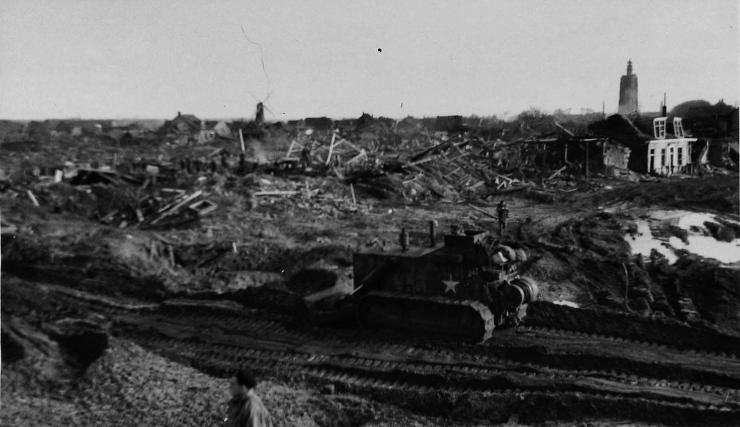

Invasion Scenes Europe: British Troops: https://britishpathe.com/video/invas...itish-troops-2
E.g. Armoured Dozer on White Beach North
Name:	Armoured Dozer white beach.jpg

Default On a busy beach
This picture was taken at the north end of TARE WHITE, which was only a small part of the landing zone where it proved possible to go onshore successfully.
Left: Armoured Dozer
Centre: Sherman V gun tank, T-148829(?) "WOLF OF BADENOCH" Turret No. 10, 1LBH "A" Sqn HQ, disembarked from LCT "5 BRAMBLE".
Right: Sherman V gun tank, T-147976 "COCK O'THE NORTH" Turret No. 11, 1LBH "A" Sqn HQ, disembarked from LCT "6 CHERRY". It still has its wading trunks fitted.

That dozer is a D7. You can tell by the position of the air cleaner intake (centred, just in front of the driver Vs RHS just behind the radiator on a D6) The exhaust is in a different position too but that is much less obvious.

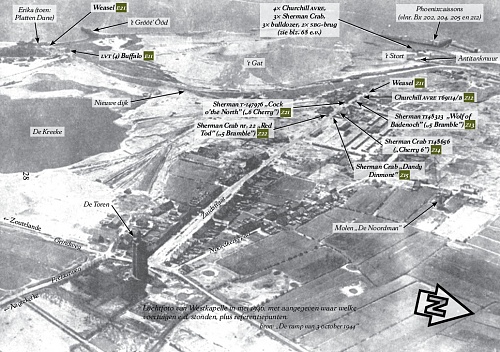

For the last two years or so I’ve been working (on and off) on what will be a PDF net.book covering the vehicles left behind at Westkapelle after the war. Interesting to see that this thread began around the time I also started digging into this very subject. Some good stuff here that I hadn’t discovered or worked out on my own yet, and also a lot of conclusions that I had also drawn independently
Let me begin by saying I’ve been assigning letter-number codes to keep vehicles straight. With four AVREs, three Crabs and three bulldozers on the beach alone, I felt this was pretty much a necessity, to avoid having to repeat things like “the AVRE facing the sea” or “the bulldozer by the end of the antitank wall” all the time. Let me show you what I mean:
Name:	Tankwrakken op Westkapelle 2020-04-15 kaart.jpg
ID:	113266 Click image for larger version
Name:	Tankwrakken op Westkapelle 2020-04-15 luchtfoto 1946.jpg
These are JPEGs exported from the net.book as I have it in Adobe InDesign at the moment (yes, they’re in Dutch; I’ll do an English translation when I’m done writing the text). On the colour map, the pale lines represent the village during the war, based on a 1942 energy company map and a 1944 British map as used in the landings. White boxes point out the 1940s situation, yellow boxes the modern one.
On to some specifics:
The (as of yet) unidentified Sherman V Crab on LCT 1005 was commanded by Lieutenant S.A. Miller
I do not know its name or Turret number, but it has a WD census number ending with “...53”:
I make it T-14…53 but I can’t make out the middle two numbers.

It’s this area that I’m currently trying to figure out too, by the way. There’s little material to go on, though.

Was the land flooded out subsequent to the wartime landing, never diked back off and reclaimed, or am I just getting the information wrong from the two photos?
You’ve got it exactly right: the old dyke ran as the pale lines show, then curved more to the southeast just below the map until it got to the dune now known as Erika; from there it continued on to the southeast. When the dyke was reconstructed after the war, it was built in a big curve the other way — the footpath along the top is clear on the aerial photo, and pretty much follows the curve of the new dyke — to connect the remaining part of the old dyke to Erika. A sandy beach then formed at the foot of the new dyke. (The lake marked “De Kreeke” at the lower right also didn’t exist before 1945 — that area was farmland back then.)
If you want to see how the coastline changed because of the RAF’s actions, http://topotijdreis.nl is a good resource: type “Westkapelle” into the search box at the top right, then play with the date slider along the left.
“’t Gat”, BTW, translates as “the Gap” — the reason for that name is probably obvious
I cannot help think some of that armour did more travelling in town after the war than they managed during the landing.
Crab T148656 certainly did

At least four Armoured Dozers could be found as spoils of war on the beaches for many years after the fighting
I found most of the remaining ones
Let’s begin on the southern side, near Erika. You identified one bulldozer there, labelled “D”; a second one stood nearby, but I’ve never seen a photo of one. However, I do have a photocopy of a map of this area made (most likely) by Rijkswaterstaat as a plan for the construction of the new dyke, which was given to me about 15 years ago when I was involved in the construction of a large 1:150 scale diorama of the construction of the new dyke, for which I supplied scratchbuilt models of two armoured bulldozers and two LVT (4)s. I recently managed to find it again, and it is what seems to be an accurate map of the situation at the time, with four “tanks” marked on it. An annotation by the man who gave me the map indicates two were Buffalos and two were bulldozers:
ID:	113888 (north is to the right)
The bulldozer Hanno labelled “D” is the one on the left (south) on the map, and the Buffalo nearby is then obviously the one also shown in the photo of bulldozer “D”. Though I’m not sure where he got the data what the other two vehicles were exactly, and because he passed away last year I can’t go and ask, given that he had extensive knowledge relating to the war and the works on the dyke, and had spent his whole working life at Rijkswaterstaat, I’m confident this is correct.
(By the way, Landingsvaartuig means “landing craft”. These were three LCT (3)s left behind, two of which are in the background on the same photo.)
Then there’s the one I think was on the beach — see a previous post by me above. Though it’s really just a silhouette, it looks like an armoured bulldozer to me,
That gives us, what, six present and accounted for? Oh yeah, and one bulldozer was on board LCT 513 that turned back, so that’s seven. Let’s find the remaining two …
Name:	Bulldozer on dyke.jpeg
ID:	113889 Click image for larger version
Name:	Bulldozer behind dyke.jpg
(both photos by Neeltje Flipse-Roelse, courtesy of Polderhuis Westkapelle)
I don’t think I’d ever seen these two photos until yesterday night, or if I had, then I hadn’t really looked at them. After double-checking the location of the first one, it’s clearly on top of the old dyke and not one of the three left on the beach, because those are a long way behind the big wall in front of/below it — which is the antitank wall the Germans built on the landward side of the dyke (it wasn’t freestanding, the foot of the dyke was dug away and the wall built into it so there was a sheer drop off the dyke). In the second photo, which is older because there’s no new dyke yet, you can see the same dozer in the background, plus one drowned in the sea just south of the village proper.
From the knowledge I picked up in this thread, I take it the second photo is of a D6? The other one looks to me like it could be a D7. I’m wondering if it’s the same one shown in the better-known photo of a bulldozer actually at work in Westkapelle:
Name:	D7A (Sgt. C. Crocker, Beeldbank Zeeland 40022).jpg
  #87
Old 06-05-20, 12:51
Posts: 567
Jakko,
I see the drowned dozer in your second photo above as a D6 and the working one in your last photo as a D7. This is based solely on the position of the air intakes.
