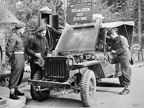

"An unidentified officer of The Lorne Scots (Peel, Dufferin and Halton Regiment) stencilling the regiment's identification number on a jeep, England, ca. 30 May-1 June 1943" ( source ).
Nice picture showing W-LU 440-M-PERS-1 details:
- rear lifting ring behind bumperette
- three stud spare tire carrier
- "WILLYS" script
- no Jerrycan carrier
- no safety rings for pintle hook
- no trailer socket for electrical connection
- note white painted rear differential cover, so British lighting is most likely fitted
Does this make it a CDLV 242 contract jeep?
Thanks,

Hanno, the Lorne Scots Jeep I would say is definitely 242 contract. Please note the body male fittings for some sort of enclosure. Mine also has this, but not all Canadian contract ones have them.
The second photo I have seen before and is captioned as Monty in General Crerars Jeep. The hood number is unusual as it seems to be 116102 - not a 421 or 423 prefix. My slat grill is drilled for headlamp guards on both sides but most photos show one only on left and bridge plate on right. This probably fits with the original 241/242 contract ordered late 41 "for 2000 vehicles delivered by 15th Feb 42, which stated "Two thousand "Defence Aid" blackout lighting equipment, hooded type, in accordance with the specifications referred to in Article 5 hereof. The equipment will be installed on the cars covered by Items 1 and 3 above"
Items 1 and 3 relate to order for 1500 and 500 Jeeps. Article 5 is a full list of specifications "in accordance with the United States Quartermaster Corps Specifications L.P./91/997A, subject to all changes to said specifications.......up to and including October 22 1941"
Specifically the "Defence Aid" lights orders a single front headlamp mounted on the left side but with a pigtail sufficiently long enough to mount the lamp on the right if needed. Radiator grill extensions provided on both sides and rear tail lamps (2) will be duplicates of the right hand tail light provided for in the US Blackout specification.
If anyone has a copy of the USQMC Specification above, we may be getting somewhere.

Lorne Scots jeep in photo earlier in this discussion: Could be either CDLV-242 or early CDLV-505. They are the same at the rear. Early production CDLV-505 were script WILLYS (April and July production). I used to own MB 155796 CDLV 505 and it was script.
Some jeeps were fitted with both headlights as blackout. Note there was a special headlight used in that case (I have one NOS). One survived with both guards in place and was rescued from a farm in England though back of jeep had been cutaway. As it was only used on farm, the blackout headlight guards remained in place all those years! I have a photo of it. Here is data on that jeep from my data base of WWII jeeps.

Interesting stuff Colin. I based my opinion of Lorne Scots being 242 as the Jeep in the background (assuming these are all Lorne Scots vehicles)has the early one piece wheels which pre-date the 505s and the Jeep does seem to have had some wear.
Do you know what type of enclosure the studs on the body were for?
Colin, could it look like this? Or does anybody else recognise this type of headlight, please?
Note marker light on top, and improvised mud flap on front of the mudguard.
Could it be only (later) vehicles intended for overseas use had one guard omitted to be fitted with a bridge classification plate?
Indeed some pictures show jeeps with the headlight and bridge classification sign swapped over. Why would they switch the headlight over to the right hand side?

I have found no orders or instructions to moving the blackout headlights and bridge plates to the opposite side from where they were placed when assembled. I have seen various photos with one or the other missing or on the opposite side. Generally these photos were taken once the vehicle had left Britain.
War Department number do not generally coincide with the Jeep contract.

I anybody able to explain the number on the classification bridge 5 . I believed that this number was for 15 CWT class.
From http://milifax2003.tripod.com/bridgi...gs_part_1.html
"(a) Vehicles will be classified and marked according to the equivalent loads which they impose on a bridge. The classes are in multiplicity of one ton, from one ton upwards.
Vehicles can cross any bridge bearing a classification number with is the same or greater than its own classification. For example, a vehicle of class 12 can cross safely any bridge marked 12, 18 or 24. It cannot cross a bridge marked 5 or 9"
Although being much lighter, Jeeps and other light vehicles could be marked as a class 5 vehicle as they can cross a class 5 bridge (the lowest bridge class rating during WW2).
The attached pics show one jeep with a "2" on it's bridge classification sign, as when loaded it weighs 2 tons (more than 1, but less than or equal to 2), the other sports a "5" as it weighs no more than a class 5 bridge can carry!
A confusing subject, indeed. . .
