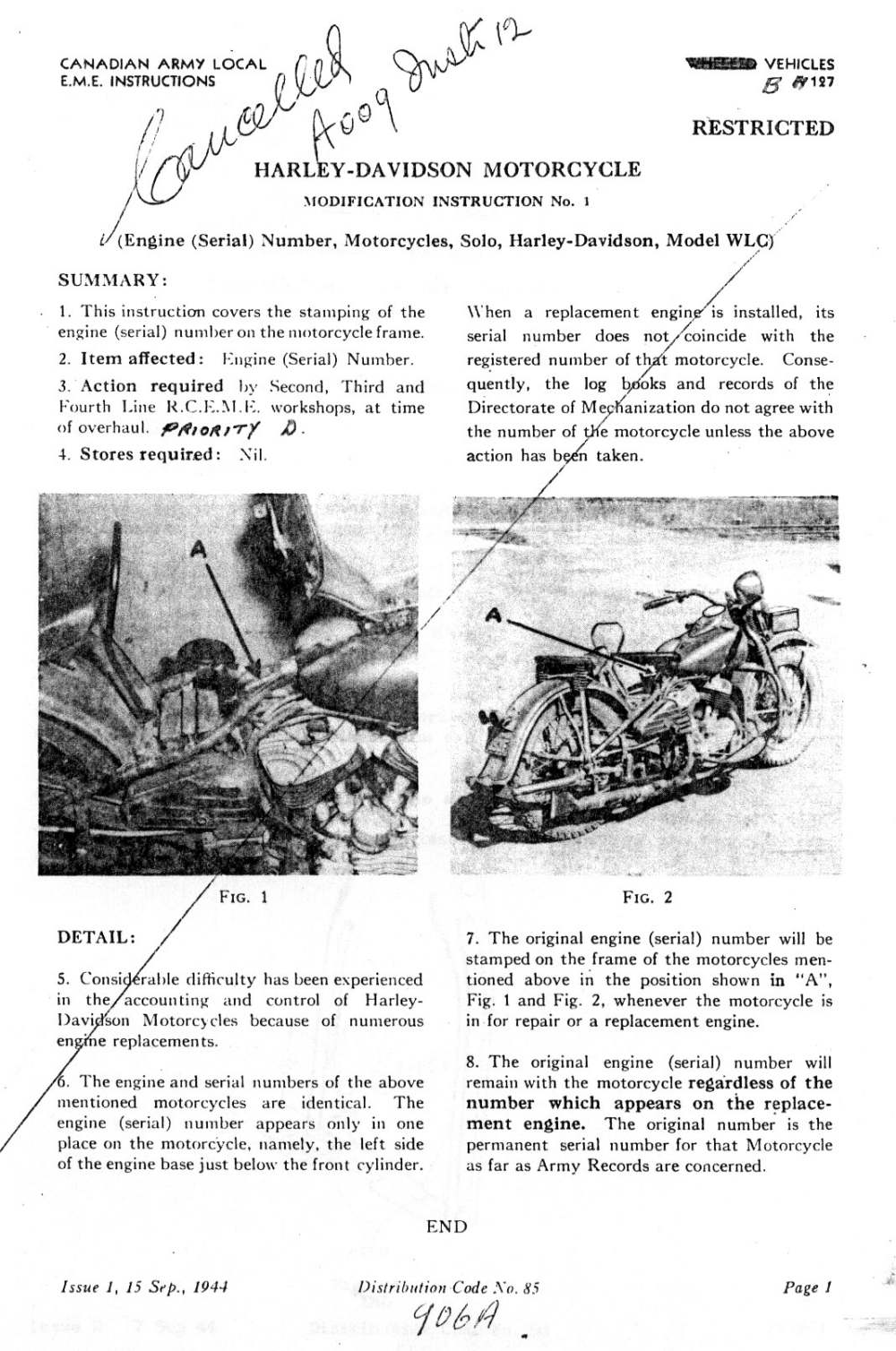

Default WLC mod sheets
More to come

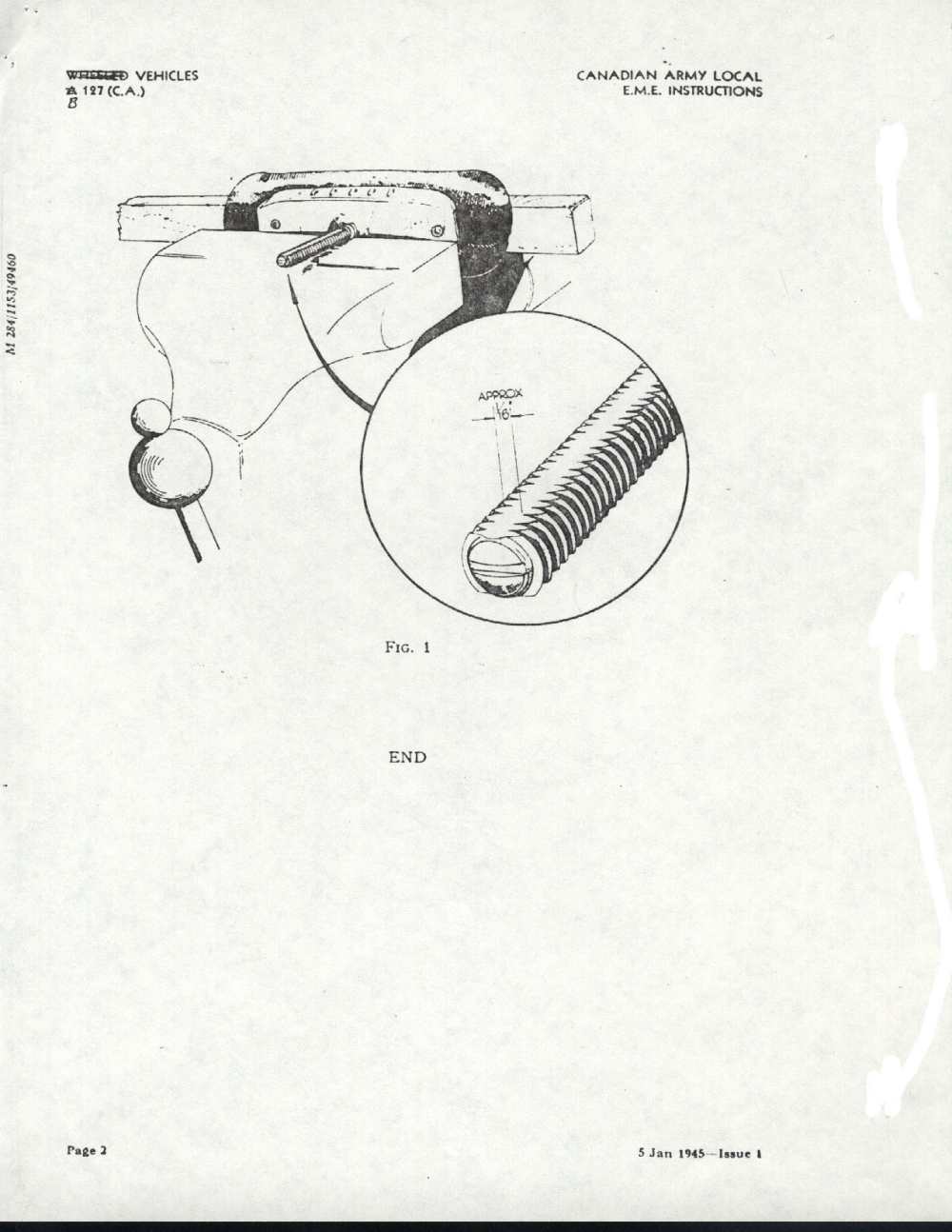

WLCModificationInstruction1.jpg   WLCModificationInstruction2.jpg   WLCModificationInstruction3.jpg   WLCModificationInstruction4.jpg   WLCModificationInstruction5a.jpg
