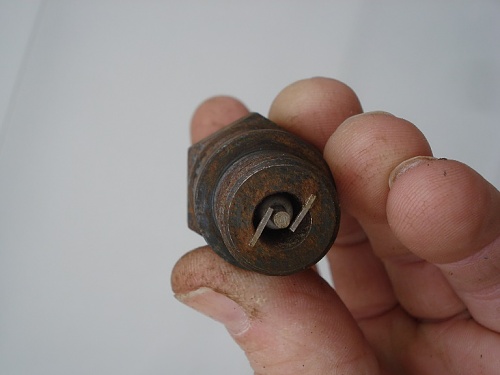

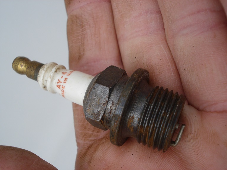

Just a footnote to this discussions on sparkplugs. I was out rooting through one of my trailer, looking in boxes I put away 25 years ago and I found some more, radial/aviation style engine sparkplugs. The first another Champion C63, but with a twist. check out the twin electrodes. It the first one I remember seeing.
Second I found a couple of cartons of plugs for the Light Tank (Locust with Lycoming air cooled aviation engine) which are also Champion plugs. Note they are single electrode and unshielded.
Here are a few pictures.

If anyone finds spark plugs with electrodes like the above, single or double, the thin piece welded to the threaded portion is platinum. Do not try to change the gap as they will fall off. However if the plugs are scrap it makes it easy to separate the platinum which is well worth doing - check the price !
$25.000/ kilo, here

You have a helluva stash of parts, Bob!
The Brits liked those "fine wire" plugs shown in your third photo. Ive seen them on Ferrets and an FV432. Like David said, the pins are platinum or ididium and they are a high-end plug for aviation use. Good for burning off lead deposits, which I found out aviation gas still has, much to my surprise.
Nowadays they cost over $100 each, so $1000 for a four-banger aircraft engine! Total overkill for a museum vehicle.

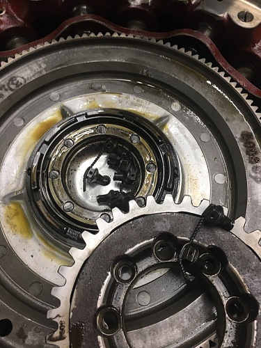

I would like to revive this discussion of radial engines. The forum has covered a wide variety of topics from history and , identification of different engines, to common problems even fuel grades. In post 31 Dave Hebert mentioned that one issue was the failure of the 8 bolts holding on the crankshaft gear, meaning the rear gear case drive was disconnected from the front section. Thats what this new addition is about. I would appreciate input from forum members as I am looking for solutions to this problem. Anyway here is the story.
ABout a month ago, one of our fellow MV enthusiasts had his C4 equipped M18 out for a number of successful drives. At the end of the day when he went to restart it to garage it for the night, it would not start. The starter would run but the engine would not turn over. The engine could be turned using the cooling fan but there was no connection back to front. A magneto was pulled off and the fan rotated but the mag drive did not turn. So the engine had to come out and the rear case removed for a look see. It had, as Dave had pointed out, sheared off bolts otherwise fairly clean and had no apparent collateral damage. The bolts were removed without difficulty and the gear seemed to good enough to reuse. pictures enclosed.

Note the unusual shape of the sheared bolts, they are essentially a tapered shoulder cap screw with a square driving head on top with holes to put through lock wires. The manual identifies C1 and C4 crankshaft bolts as
"Screw, machine, sq-hd, dld-f/1kg-wire, alloy -S, 5/16-24NF-2 (19/32) x 1 7/32 overall lgh" it is part number G104-0102120 or CO-200439 , also B206663. Not quite sure what all of the description means, can anybody translate ?
Now before I ask you for your respective opinions on how to repair this, lets look at the later -46 engine gears. The Wright R975 started out with much less power than the finished C4 version. It appears that one of the weak links remained the 8 bolts holding on the rear crank gear- a design unchanged since the mid 1930s?? By contrast, the late 1940s designed 975-46 was built much heavier to handle its boosted horsepower. Some of this has been previously referred to as we noted the heavier case construction, heavier rear main bearing etc. If you check out the next photo you will see a rear crankgear for a -46 and the much heavier method of attaching it. While it uses 8 capscrews, they are flat not tapered. The gear/crankshaft have an aligning dowel on one side. Most importantly, there is a heavy metal projection attached to the gear which is drawn into the rear of the crankshaft witha heavy bolt. A LOT stronger than the C1 and C4 version!

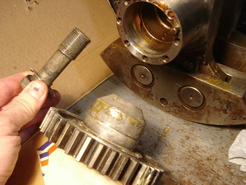

So if I do this correctly you should see two pictures of a C1/C4 type gear out of the engine and without the view obstructed by the camshaft. You will see the gear bolts up tight against the rear of the crank. It has a small projecting ring on the back which helps align it in the crankshaft. No other attachment ot dowels etc. The -46 in the third photo is much heavier.

So here is the problem. I am unable to locate any of the original type bolts. If you have any or recognize these, or know of a source I would like to hear from you. Have already checked aircraft supply places and engine rebuilders who declined to sell parts.
So option two..given the fact that the gear is designed to use a tapered shoulder bolt, could we not use conventional tapered socket cap screws in grade 8? They are readily available. They should be just as strong. They would not have the square top and tie wire holes but why not use locktite to hold them in? That would prevent any movement or shifting of the bolts, and the only downside I can see is if the bolts were to shear off it might be a pain to get out the broken bolts. What do you the readership think of this suggestion? All opinions welcome.
Another question has to do with the cause of the failure. The owner checked the detached gearcase to see if there were any obvious bearing failures, or increased resistance to account for the breakage. Everything seemed as normal. Could it just be fatigue in 75 year old engine rebuilt 20 years ago? Aside from checking the gear case, cleaning the sump and putting in clean oil in the engine what other things need to be checked out? Again all opinions welcome.

From the photos, it looks like a classic fatigue failure to me, affecting all the bolts. If so, it is an age-related failure as it takes a certain number of stress cycles to grow the fatigue crack across the bolt to the point the remaining intact area is not strong enough to withstand the tensile load and the bolt fails.
A characteristic of fatigue failure is the fracture surface shows a relatively smooth area with fine, often crescent-shaped lines spread across it. The remainder of the fracture surface has a rougher crystalline appearance, which is caused by the sudden final tensile failure.
Bob, can you post a close-up photo of the fracture surface, the closer the better?

My personal opinion is that the failures are fatigue failures caused by the bolts flexing over a long period and not that they acted as a safety device. This could be due to them being wrongly torqued when the engine is built up (allowing a small angular movement of the gear) or that they were not really suitable for the constantly changing engine speed in an AFV and that this was not addressed until the '46' version. I wonder if one could fit a '46' crank and gear into a C4 ?
