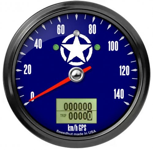

The speedo in my grey CMP gathers speed data by a magnet on the tailshaft, apparently. This has proven to vary wildly, and I do not trust it. Adjustment may make it better, but I still don't trust it.
I went searching for alternatives. Non-standard alternatives. Came across this gauge supplier http://www.speedhut.com They sell a wide range of instruments, and prices not extortionary. Of interest to me, is their selection of GPS driven speedos, which do not require ANY speed calibration data and arithmetic to obtain extremely close speed tolerences. Naturally, if in an underground carpark or tunnel, your speedo goes dead until you resurface again.
The thing I found REALLY cool with this supplier, is that you can custom make instruments to your own design. I had a little play, and came up with this design with an 'aged' invasion star logo. There are sooooo many areas which can be customised, including dial colors, number font, speed marker lines, speedo needle, bezel color, etc.......

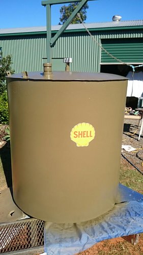

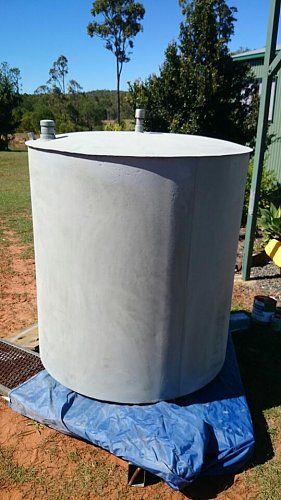

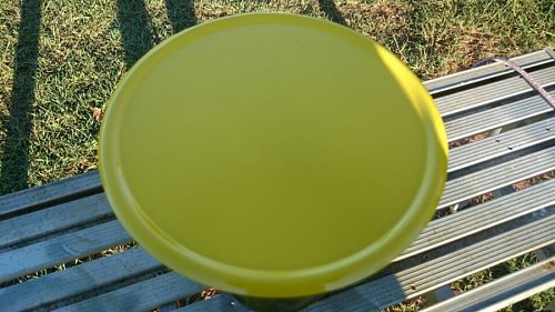

I'm starting to get excited! The weather is finally cooling down.
Won't be long before I can come out of my summer hibernation, and get some damn work done.
ID:	73338 Click image for larger version
ID:	73339 Click image for larger version
With all the discussion of spraypainting in recent week or so, I thought it would be a good time to finally get the fuel storage tank painted. It's not finished yet. The legs, ladder, and tank underside still need to be painted. I had a nice big Shell sign to put on, but because I had bought it many months ago, and it's been sitting in the shed, it went on all wrinkly and I took it off again. Used a much smaller one instead. Guess it doesn't look overly diminutive, but I would have preferred the big one. Lifes full of disappointments, eh.
Also repainted a Bridge Plate I bought a week ago. The original paint was in poor condition, and could not be saved. The number for this plate should arrive during the coming week. This plate is for the grey truck. It's about the only thing that will not require repainting later on. When I get the RAEME history book I have ordered, it may give me the epiphany I'm hoping for, so I can then start on a WW2 correct AEME TAC sign.

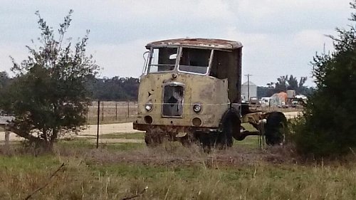

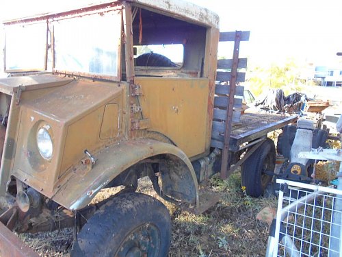

How's this for a find? A friend of mine came across this Sunshine Cab roof, and contacted me. I had told him I was wanting one of these for the grey truck, but really didn't have any expectation that one would be found intact, let alone the nearly perfect one that this is. To my eye, it appears to have all the bits that it should have, and they all look to be in very good condition. What is the flat strip which goes across the front of the roof opening? Is this the thing that the canvas is attached to? If so, that is a real bonus. Never seen one so intact and unmolested. I can't see a single dent or rust hole, only surface rust. As you would expect, I jumped at the opportunity to buy it. I won't upset everyone by saying what price I paid. That would just be cruel. I have also purchased a full cab that takes the canvas covered doors. Another friend and MLU member has taken some photos and measurements of the steel frame for canvas doors, and my thanks to him for all his efforts in doing so. Without the help of people like you, restoration would be sooooo much more difficult, if not impossible. Thanks Rob

The chap selling me the roof has option to buy these trucks. They also are in remarkable condition. Look closely, you can see they still have a number of the original military items. I believe he will purchase them both. There is a significant cache of other CMPs he has located, but I will not speak about them yet.

That sunshine roof is really nice, looks like the original piece for the front canvas too - it should have a grab handle (same as the ones in front of the hatch) to help open and close it. The F15A in the lower pic looks to have the ARN on a diagonal.

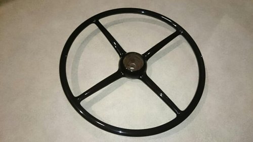

Had to make a steering wheel puller. The wheel in the grey truck required a lot of care to restore to original condition. Wait, I take that back. The once barely discernible grooves around the top surface are now gone completely, so not that original now. Bloody lot cleaner than before though! I will give the wheel a second going over with finer grade glass paper I will buy tomorrow. Used 240 grit first, then 600 grit, and next one will be 1000 grit. Burnishing cream will bring the final sand to a very nice finish. With any luck I will still be able to hold it while driving. The degree of shine seen, is after polishing with Brasso, which doesn't work all that well. Brasso stinks too, and as a result of doing the polishing on lounge room floor while Mrs B watches TV, I am not very popular. The lounge room has an aroma akin to old cats urine. You can read that both as old whizz, or whizz from an old cat. The smell would be the same, terrible! Yuck. My snoz will be running for days.

Almost looks like a picture from a sales catalogue ...... I always believed that they needed to be repainted to look good......never crossed my mind that they could be sanded and polished.
...and where did you gain your expertise in "old cat whiz???"
Bob C.
  #1469
Old 01-06-15, 22:11
G' Day Bob,
If there's no significant damage or cracks that need to be filled, a thorough sanding with progressively finer wet & dry sandpaper should bring a steering wheel up nicely. Note: I did need to sand to a degree that removed the ridges. Some folks may find that unacceptable. I had no problem doing that, personally. Someone with more patience than me might be able to fold the sandpaper doubled and run it through the groove to get a good finish without losing the detail, but man, you would REALLY need to want originality.
Oh, and the feline Urine? Simple, had a neighbour who seemed to be the pied piper of geriatric cats. Anti-social things they were. Give me a friendly old labrador, any day!
