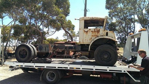

Here's a couple of photos of how it looked when it first arrived.
