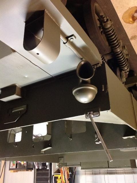

Picked up a nice 1935 horn the other week they are getting hard to find , and it works . I'm on two weeks holidays should have the conduit finished and air scoop fitted . I'm having a wiring harness made up next week then the drivers compartment can be finished off .. I gave the outside upper hull it's final coat of paint to blend it all together yesterday . This Time I up graded to Protec's 342 spraying enamel 30% flat khaki green No 3 much , much , better then the equipment enamel very easy to spray . It looks flat in the flesh but has an egg shell feel to it . Dale

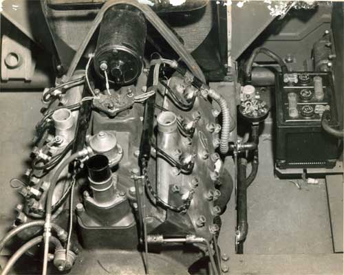

I've moved along a bit more with conduit layout can some one tell me if this is correct ?? before I add the loom . Dale

Hi Dale this is the only photo I have and it's not my carrier but it looks like you have it right.
Robert Pearce.

Thanks for the photo Robert it all helps . Today Finished the conduit layout much bigger job then I thought !!! took a long time lots of bending of pipes and climbing in and out of the carrier test fitting each peace , all's good now just need to paint and add the wiring loom hope the photos help others . Dale PS can some one tell me what the two holes are for in the rear bulkhead each side just below where the engine cover goes
