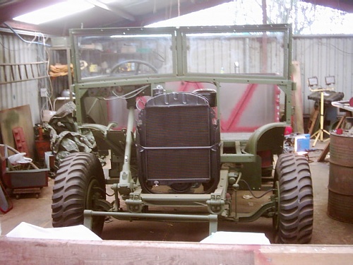

Tried fitting nose shell to my C15 last night and had some difficulty due to the fact that I think I had fitted the radiator too low down.
Can anyone tell me the height of spacer fitted between radiator and chasssis crossmember please ?
Cheers RR.

hello
the one on friends c15a is 1.5"
consists of 2flat plates with rubber spacer in between
not quite sure if it is original
if that helps
doing a great job on yours it looks a treat
congratulations
sorry correction on the rubber it is one solid steel piece
Have a good one
Andrew

Default Radiator Mount
Andy,
The twin bobin arrangement, made from steel on your friend's Chevy is correct.
R.R. From memory, it's about 1 1/2" deep, I'll see if I can measure mine tonight to confirm
Keith

Thumbs up thanks guys
Thanks for your help and pix will make something up to lift the rad by required amount.
Will post some pics tomo as the truck is being inspected by the dvla prior to it having an age related reg No. and being exempted from Mot
Cheers RR.

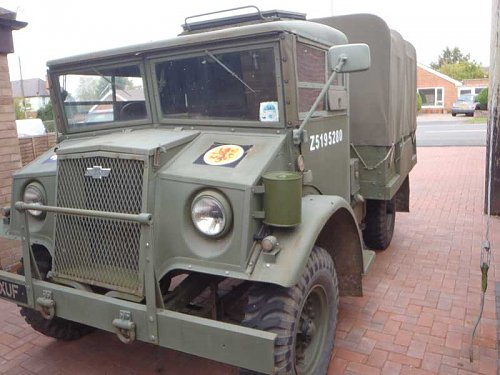

Default door number
At long last I am about to add the army number to the doors of my C15 and was wondering what was the correct size and position of the numbers.
Having carefully removed layers of paint to uncover the original identity I failed to take note of these details
Any help gratefully appreciated.
RR.
Old 22-06-08, 00:31
luke stone's Avatar
luke stone luke stone is offline
Join Date: Jul 2007
Location: oxford england
Posts: 28
Hi jeremy
Ive just measured the original markings on my f15 4x2 the top of the numbers are roughly 71/4 inches from the top of the door and there 3.5 inch in size
cheers
luke
