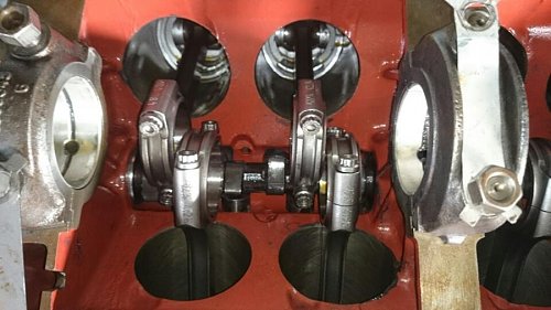

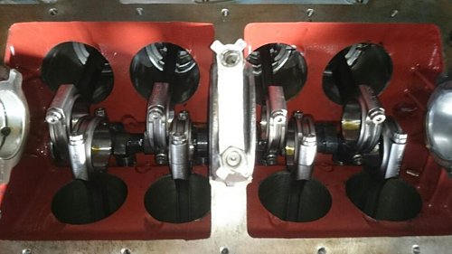

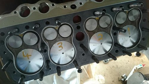

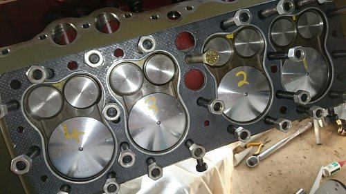

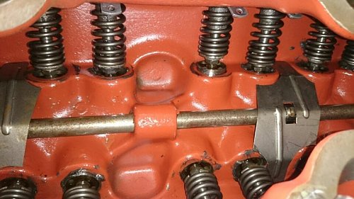

Today, I was determined, would be 'truck day'. I got my piston/rod sets back from the engine rebuild shop on Friday, and they did a rather good job. When I did initial assembly of oil pump to pickup I managed to strip a thread. Didn't know why, at the time, but the engine shop guys tell me it was because another bolt hole which intersected the one that stripped caused mangling of the thread I damaged. Apparently it was going to happen regardless. Thank you very much, Melling manufacturing folks.
As mentioned previously, due to the extra girth of the rod big ends (literally) I had to sink the pistons from the crank case side. This was not a bad idea anyway, because the relief between cylinder and valves meant that there would be a length of ring not compressed by the installation tool. The first piston I installed went in without a problem, and just as I was thinking things would go smoothly, I hit a major problem. Imagine my surprise when I tried to put the second piston in, only to discover that the additional metal that strengthened the crank bearing bosses made it absolutely IMPOSSIBLE for the piston to be dropped in from that side. Typical! The piston would have needed to go in at a 10-15 degree angle, and that wouldn't have been good! I took a closer look, and saw that every second piston would encounter this same issue. Bloody French! In light of the above, I now had 4 pistons which had to be seperated from their rod, put in from above, pushed through until the rod pin was clear, and attach the rod from below, paying VERY close attention to checking locking clips and compressing the bottom piston ring (now out of the cylinder again) prior to sliding the piston into the cylinder properly. Quite a sod of a job, I can tell you! Got em all done by tea time though. Those pistons are quite difficult to slide up & down by hand, despite lashings of assembly grease.

Very nearly carried on to put the crank back in, but thought better of it with light and motivation failing. Because of how the pistons & rods now sit, I will need the arms of an Indian god to keep em all out of the way of the crank, as I lower it in. I have a cunning plan for that little glimpse of hades. If my approach doesn't work, I'll wait until my Son comes home in a fortnights time. That will give me one person to mind each bank of rods, while I lower the crank into place. Sounds easy, don't it? Fingers will be scarred, tempers will be raised, words will be said.

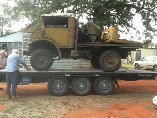

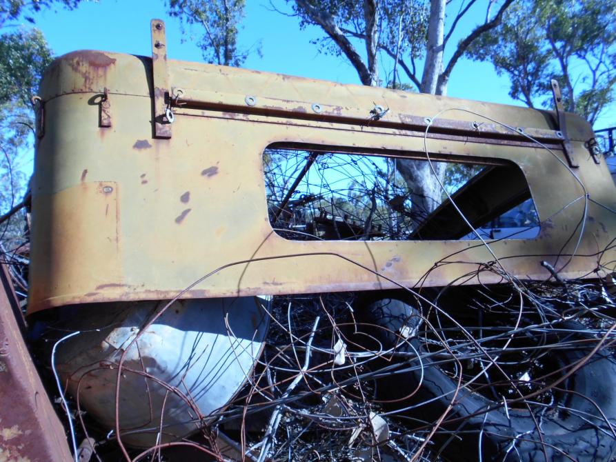

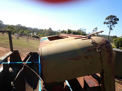

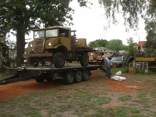

Just finished a phone conversation with the friend of mine who sourced and retrieved the sunshine roof I spoke about a while ago. He emailed me this morning, to say he is now back home from his trip to central QLD where he acquired my roof and a complete vehicle which he will be restoring for himself. In the email, he reported that my roof panel still had ALL the wing nuts intact and in place. In fact, everything is present, minus the canvas which had rotted away. I can't wait to go and get the thing, but will have to be patient for a few weeks. We had to fork out for another daily use vehicle, a couple of weeks ago, and it doesn't have a towbar yet.
ID:	74890 Click image for larger version
This is the truck my friend brought back from a 1500km round trip into the sticks. That truck still has all the original military side, tail, and diff lights. I REALLY want to get a close look at that vehicle, and will take as many photos as I can. That's my roof upside down on the rear tray.
The tri-axle trailer the truck is on, was manufactured by my friend in a week! It was made primarily for the retrieval of CMPs. Thats dedication to the cause. He is one of those rare people who can do anything he turns his hand to, and do it well.

That roof is a great find, Tony. Congratulations! Also keen to see more photos of your friends CMP. Hopefully the plates have survived as well to help tell it's story.

Thanks David. I will check what identification is present when I go there to pick up my roof panel and some other parts. Will also take photos of anything significant, including the original side and tail lights. I believe the diff light and changeover switch are still in place, and may be surplus to owners needs, so he may be selling the military lighting. Possibly to be sold as a complete set! Parts usually get sold via ebay.

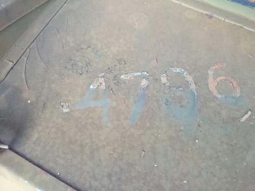

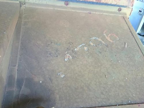

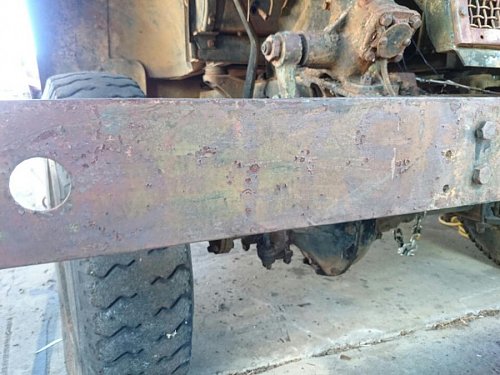

Today I made a trip to retrieve some parts from a friends place. While there, I had the chance to look at a very complete Ford he recently brought back from Western QLD.
ID:	75441 Click image for larger version
ID:	75439 Click image for larger version

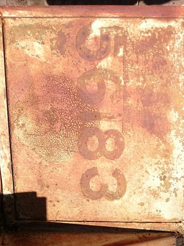

The vehicles serial number is partly visible on both sides of the nose panel (much easier to see on one side) and also seems to be repeated on the bumper. I think I have correctly deciphered the last 4 of the 5 digits, but cannot make out the first. Could be a 5, 6, or 9. Can anyone help identify what it may be? NB: THE third photo shows the numbers after I drew my finger over them, to finish the missing sections. I'm fairly confident I have those ones right.

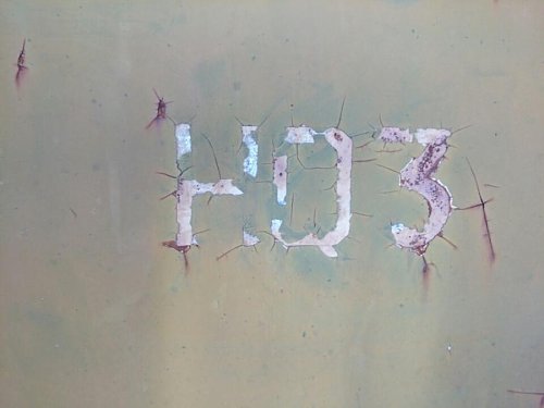

Another tantalising clue to this vehicles provenance, is the definate HQ3 clearly visible on the doors. The truck has had very few layers of paint applied over the years, and it looks like a latter application of color has reacted with the original (I hope) signwriting, and caused it to come away in a manner quite different to the rest of the now peeling paint. I will show some more general photos of this truck in a following post. It's retains some items usually lost in time, or thrown away due to deterioration. I'm very excited about how original and complete this truck is. My friend did well with acquiring this one!
The above photo is from the nose panel of another Ford CMP, vehicle number 56183. Is there any way to trace this vehicles history, and possibly the one at the top of this post. Alas, no chassis number has been found on vehicle '_4796'. It may yet be discovered, but my friend is thorough, and he says it's not there, he is probably correct. Looked in all the usual spots.

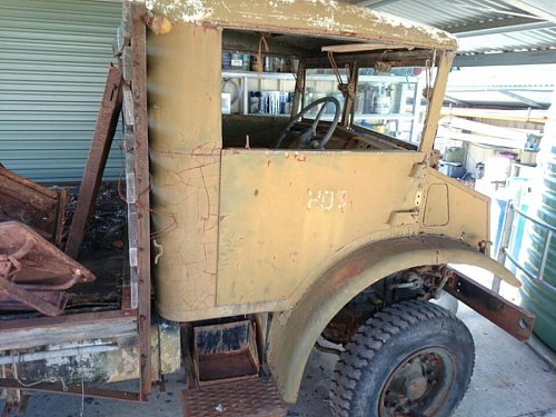

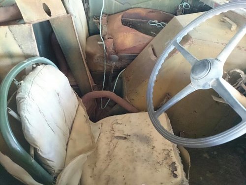

Here are more photos of the vehicle in my previous posting.
While the tray is not original, damn near everything else is, I suspect. Side lights are present. Bumper is about the straightest one I have ever seen. I didn't take a front-on photo, but the grille is there, and rot free. Nose panel is also rot free. The window frames are in perfect shape, nothing more than surface rust, and both sides swing cleanly.
Seat covers look to be the original ones, but badly broken down. Would be good for patterns though, and would have been nice and soft, as compared to the thinner version I have in mine. In reviewing this particular photo, I see an original fan shroud sitting on passenger seat. I know the owner is planning an engine swap, so must write him....quickly, and offer to buy the shroud.....quickly!

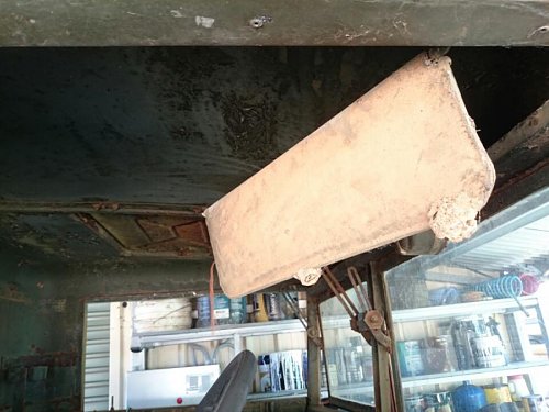

Not actually seen an original sun visor before. The sunshine roof I brought home today, has the bracket and a portion of the arm which would have held the visor, but visor itself is long gone. When I visit my friend again in a few weeks, I will take some measurements of the visor, and get one made for my vehicle. Will post the details if anyone is interested. Might even remove the wasps nests prior. They may cause incorrect dimensions if left insitu!

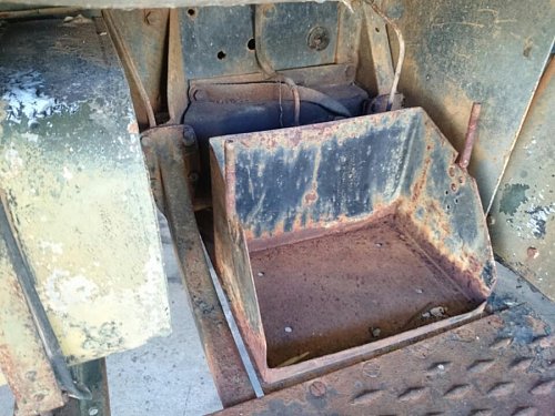

Now this was a REAL surprise. A genuine, unaltered, unbutchered, battery box. Minus hold down top and wing nuts, unfortunately, but a correct top piece can be sourced easily enough. Once again, my friend may not require this tray, so it could come up for sale in near future. He puts things for sale on ebay. The original fuel filter still sits behind the battery box. Just goes to show, some fairly good finds are still out there, waiting to be discovered.

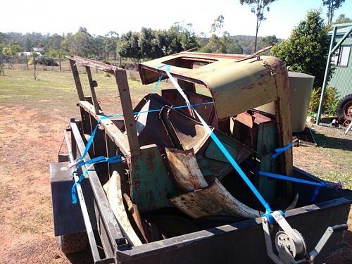

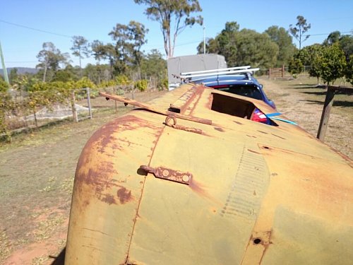

Yesterday was a great day out. Mrs B and I took an all day round trip to retrieve some parts I have been wanting to get home for a long time. Accompanying us was Andy Cusworth, another MLU member and friend of some years now. I think Andy and I talked the whole way there and back.
ID:	75475 Click image for larger version
ID:	75476 Click image for larger version
ID:	75477 Click image for larger version
Most desired amongst the treasures was of course the sunshine cab roof. Couldn't wait to finally see it with my own eyes, and I must say I wasn't disappointed. It is in very good shape. There will be minimal dent repair work needed, and no rust repairs at all. Sandblasting will be done. It's my preferred method of cleaning. I brought back a good set of 16" wheels as well, so they will also go for blasting. When painted, I have a set of NDT tyres to put on them, and the tyres/wheels on the grey truck now will be given back to the previous owner.
I will post a number of close up photos of the cab roof shortly. Does MLU have a thread or heading where people can post images of items they have which are known to be original? If not, maybe it would be a good idea. Then everyone can benefit from seeing how things SHOULD look. I'm absolutely sure everything on my cab roof is %100 original, so far as the hardware goes. There was still remains of canvas attached to the bar that goes to the front edge of the opening, so my photos might help someone else in the future. Just a thought!
