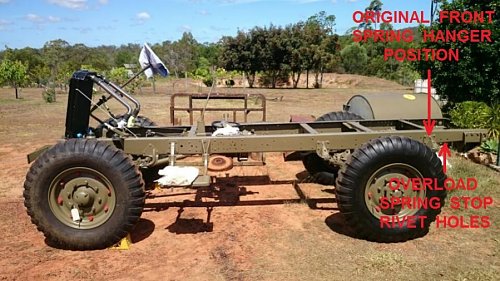

Sorry folks but it's just a shortened F60L chassis. As Hanno suggests it's been done by moving the axle forward and chopping off the excess rear chassis. Simplest and tidiest way to move the axle forward is to move the rear spring hanger to the front spring hanger position (they use the same rivet pattern on Fords) and move the front spring hanger forward correspondingly. This results in a wheelbase close to 115" which tends to play tricks with the mind! As Mike says - "the 115 inch wheel base seems too much of a coincidence for a farmer-shortened chassis." Of course, once you're familiar with this mod it's easy to detect the numerous inconsistencies resulting. For example, the triangular rivet pattern for the overload spring stops located curiously BEHIND the rear spring hanger!

  #1660
Old 10-01-16, 04:10
Thanks Tony,
That settles that question. I knew somebody would be able to make a definitive call.
Kind of a shame, but at least I don't feel guilty about removing the extra spring packs, and replacing the back 15-16" of rails. I think the person who did the chassis shortening would be honoured that his work was only able to be picked by chassis holes!

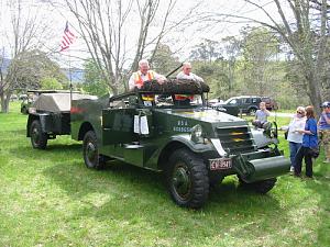

This is the trailer on the White:
  #1674
