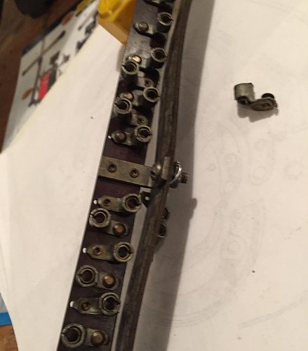

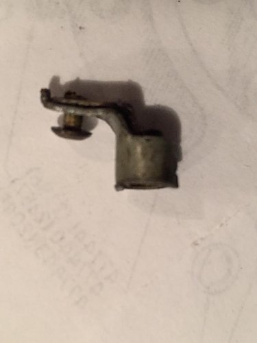

The Lynx has two main junction boxes, one in the crew compartment and one in the engine compartment. The one from the crew compartment is in pretty rough shape. I am trying to source some of the female connectors, without much luck.
Would anyone have some ideas where I could source some or better yet, have some they would be willing to part with ?
I was very lucky to acquire a full NOS loom from one JB to the other from Dirk L. . I am positively surprised at what is still available out there.
Here are some pictures of what I'm looking for.
Thanks again, Peter

Peter. You must be one big wiggle now waiting for the chassis to get back home! 😉
Not certain, but it would not surprise me at all if the junction box parts you need turn out to be common pre war Ford commercial items and if enough of the box itself has survived, it could be easily cloned. Might be worth a check with antique Ford parts suppliers or any of the companies out there doing repro vintage automotive wiring harnesses.
Just another thought. If the terminal strip itself is in good shape, maybe one of those wiring harness shops could rebuild it for you.

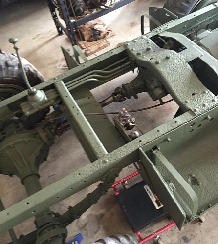

Got the rolling chassis back from paint, and I am quite pleased at the work that Dan Pearsoll did. Now I will mess it up adding parts.
Hard to believe that it was one year ago this month that the Lynx first entered the garage. It's been a great journey and the people and memories along the way have made it all worth while.
I have another order of electrical components coming from Dirk L., but I am still searching for the components to rebuild the junction boxes, so if anyone has any old Ford terminal strips lurking around their shops, please let me know.

I went through the same thing on the museum's lynx a couple years ago. I rewired it with bullet connectors, and also had a few of those bullet receptacles come off, or else work loose, causing heat.
In the end, any that were an issue I merely used unions to join the two applicable wires together. I had no luck in finding the proper terminal blocks. If you have any luck, let me know.

Looks right, but I am looking for the female connectors that mount to the terminal strip, not the male portion.
Thanks, Peter

After searching automotive parts shops on several continents for the missing connectors without any luck I decided to try out Minakers scrapyard which is just down the road from me. Randy, the current owner, went into the "inner sanctum" and in short order came out with some switches of an unknown origin, with the right connectors. Had to sacrifice the switches, but now have the right connectors. Nice to be able to rebuild the junction boxes and remain faithful to the original design.

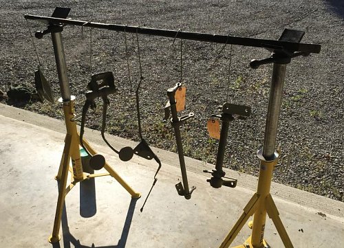

Peter

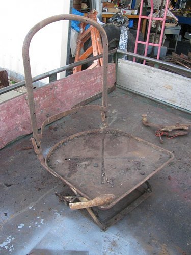

I'm attaching a picture of what I started with regarding the seats. Only one half of the drivers base pan was left. The observers/gunners seat is even worse.
You are correct, the rails under the seat are not correct to the Lynx and they will be removed once I have the scissor-lift type base repaired or replaced. The rest of the seat is correct.
I'm deliberately deferring the observers seat until the Lynx is actually running.
