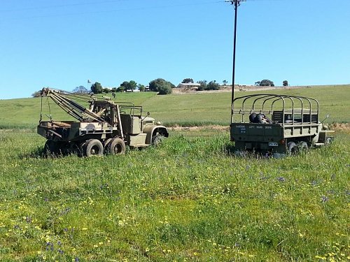

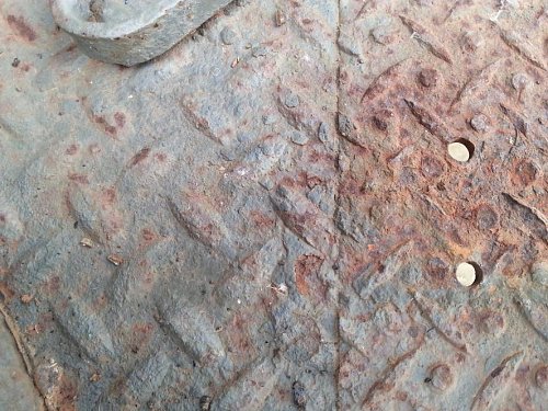

Hello all
Thanks again for all your comments lads, and of course Colin Jones for his work.
Without doubt i need help with parts on my new toy if anyone can help. There is a lot missing so give me a yell if you know of any parts laying around to fit the 2 pounder.

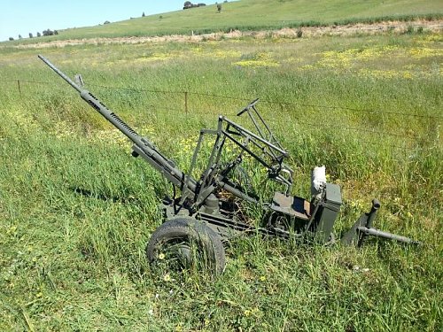

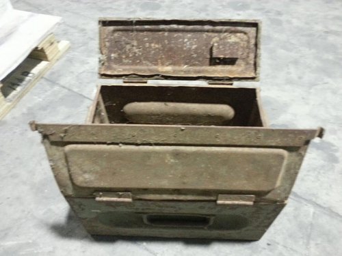

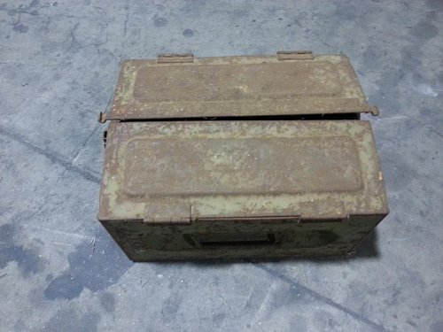

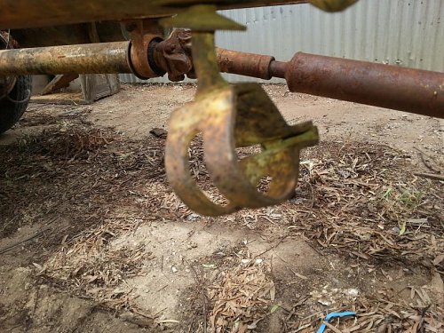

Also the museum wanted to know if anyone could identify this..
ID:	67424 Click image for larger version
Cheers Shane

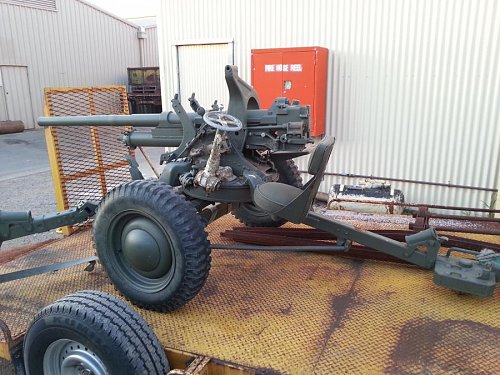

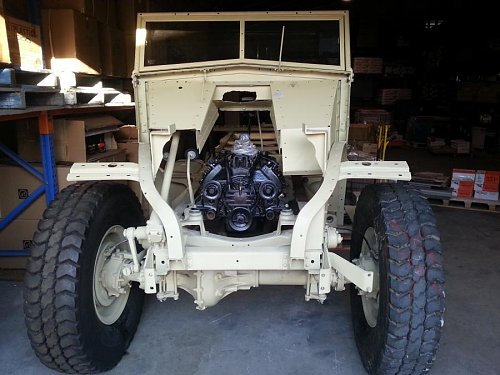

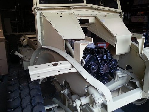

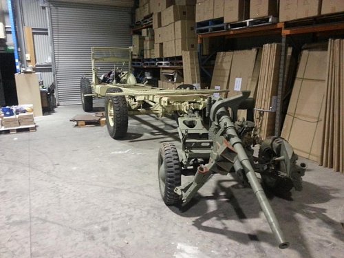

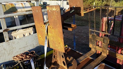

Just a quick update of the cab 12. I have decided to transform her into a 2 pounder anti tank portee might as well as i have the gun. Would like to see photos of the tray the gun sits on if anyone has any and also the layout of boxes etc. Anyway here is a couple of photos of the resto so far and the not to be done for a couple of years resto.

Bought this a few days ago, at least i know what im in for

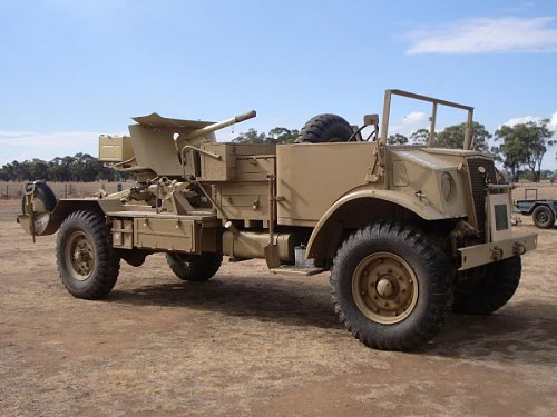

Hi Shane,
Tim Scrivens has a Cab13 2pdr. anti-tank portee. It looks to be much the same as the Cab12 from the back of the cab. You should be able to get the measurements of it.

Lovely work on the truck, Shane. I am looking forward to your updates on the conversion to portee!
Excellent work on the hinges Colin...I was looking at a cab11 recently and the hinges were absolutely terrible....probably suffered from corrosion, than mangled due to the weight of the door and than welded again.
Shanes hinges look very, very nice.

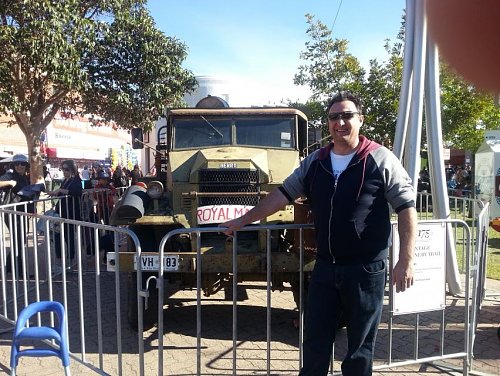

Now if this is not a sign from above that i should be working on my truck instead of pushing through thousands of people for over six hours i don't know what is

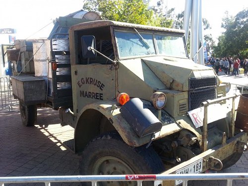

I mean what are the chances people..... Very tempting to go back after hours and get that drivers door for you Tony

Nice photos Shane.
Any idea what that flat black thing is on the driver's front fender...?
  #192
Old 07-09-14, 22:33
Default The Kruse Cab 12
That truck was rebuilt as a 'replica' of the one in the movie "The Back of Beyond".
It has a few modifications including an extended steering column. Not sure what the black thing is. It wasn't there when I last saw it in Alice Springs. That truck sure gets around!
It belongs to Brenton (I think) Kruse, one of Tom Kruse's grand nephews. He lives in Waterloo, S.A.

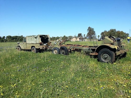

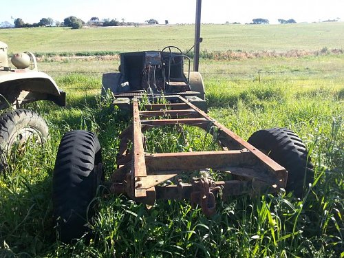

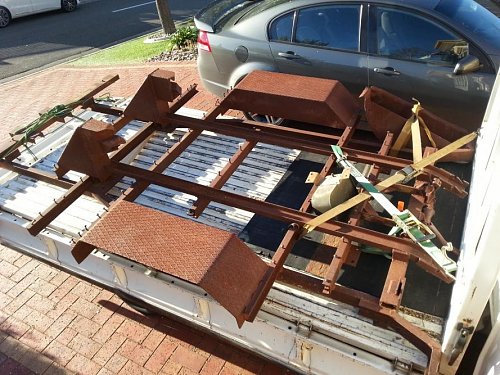

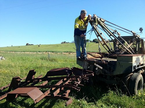

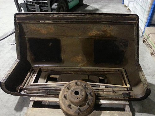

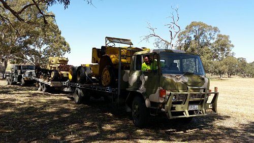

HI all
A few days ago obtained my NOS Cab 12 roof wood and metal all in great condition and will be used on the next project.
Today Hugh Davies and i went to pick up the Cab 12 but the tyres were stuffed so we were unable to tow. I guess another drive next week will get things sorted out..
However not all bad news got the Portee

Amazing to find a NOS Cab 12 roof! And also the Portee body. Congratulations!

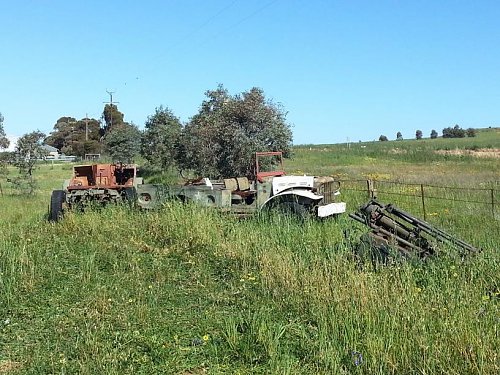

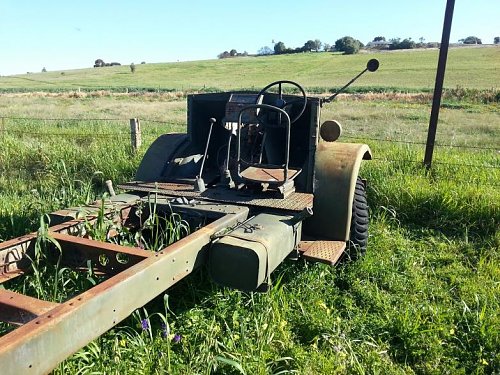

Thanks Keith you can get lucky sometimes mate. Does anyone know what kind of timber that was used on the portee floor? Has anyone restored one on the forum?

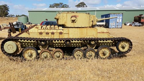

Here a few shots of other things laying around in the same paddock.

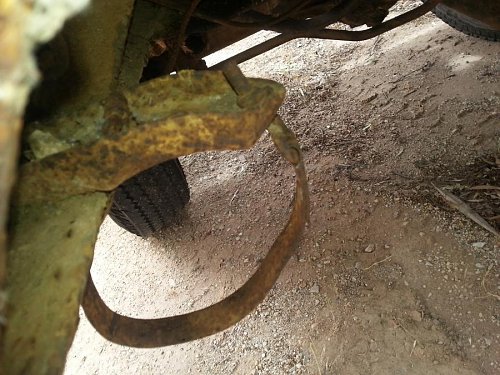

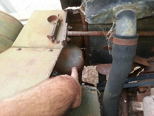

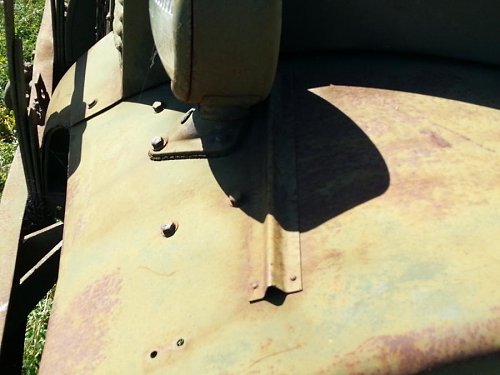

Is the thin metal part laying across the mud guard for wires and is it original?
Thanks in advance. Cheers Shane

Shane,
Well done on the roof and portee frame. Some nice projects in that paddock.
The strip on the cab12 fender is original and indeed used for the wires leading to the marker lights. The two small holes near the end of the strip is where the bracket was bolted on holding the Rubber marker light. These strips were discussed on the forum recently, but I can't seem to find in which thread. I seem to remember they are a cab12 feature, that was introduced somewhere during the cab12 assembly, as not all cab12's have them.
  #200
Old 14-09-14, 23:38
Default Pat 12 Chevs have tube
Hi
Pattern 12s Chevs have a metal tube running in the same location to protect the wire for the marker lights.
Portee body is a wonderful find.
  #201
Old 15-09-14, 05:50
Default Regarding the tube thing......
I believe the tube is more prevalent on Canadian cab 12 and the flat angle cover more a Holden/Australia design..... am I correct??
On cab 11...... were the fender rubber lights added later.... did the early production models with out the air vents have those lights...
and when cab 11 did get the fender lights where was the wiring routed.. ....inside the under fender bracket with the headlight wiring.....?
  #202
Old 15-09-14, 06:59
Default Flat angle
It's certainly not a GM-H thing as Australia only ordered Ford Cab 12s and the only thing we added to those cabs was a roof hatch.
The Chev ones here came in later mostly with the returning troops from the North Africa campaign.
In my experience some cab 12s here have them, but most don't.
  #203
Old 15-09-14, 12:15
I think Phil is right...Chev's use a tube and Fords seem to use an angled strip.
From what I have seen, the strip/tube doesn't show on any cab11's. In fact the Servicepub factory photo's CD only shows the strip/tube on a few cab 12's, but definately not all. I presume early CMP's didn't have marker lights up front at all(?). Maybe some were retrofitted, but I have seen a number of Cab 11's and 12's here which don't show any evidence of any marker light ever being fitted.

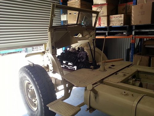

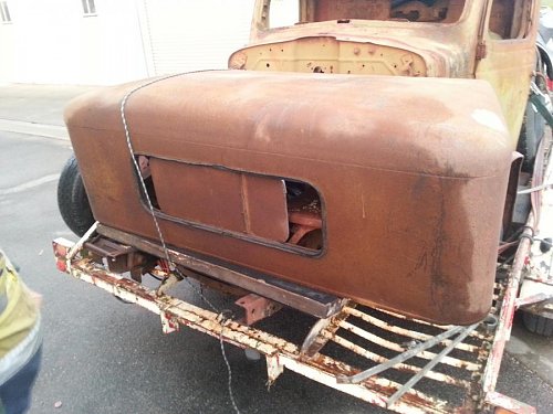

Does anyone know how you can tell the difference between a Cab 11 and Cab 12? I have noticed on my new truck that the horn is located near the front of the engine were on my old truck the horn is on the chassis, also the check plating is two different sizes on the new truck.
ID:	68441 Click image for larger version

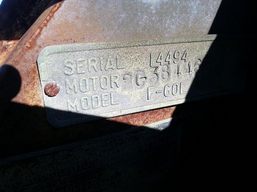

The id number on the new truck is..

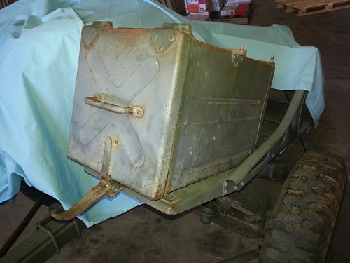

Also on another great note we have found a 2 pounder ammo box

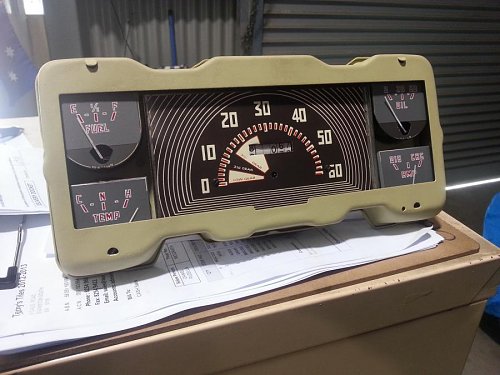

I am looking for a speedo needle if anyone could please help out that would be great. Cheers Shane
You have a cab 12
Cab 11 have a bolt down flat plate for a bonnet and a full 1 piece grille and surround
Cab 12 have lifting bonnet and 2 piece grille
Picture shows cab 11 in front and cab 12 2nd
Have a good one

The box you asked about many moons ago (with the twin swing lids), is an ammunition container for Polsten drum magazines. They appear to be of GM-H manufacture: never seen anything but.

Need to pick your brains again lads, are the following photos original to the Cab 12 or are they a farmers handy work?

Have started to do the cluster which is coming up well. It will only serve as a cosmetic feature as i will be putting in modern gauges. Have sent the generator away to be changed to 12 volt as this seems to be the general recommendation so all globes will have to be changed as well.

Have been given a speedo needle to replace the one i put in a safe place and now cant find
I don't think they are original. Looks like you need the parts book for the F60L. I have a spare!

Hi all.
A massive weekend and im happy to say we have saved quiet a few fantastic items. The photos never show the huge effort, cuts, and sweat but believe me it took a lot of work to save these and they are now in safe hands. This was all done with only three people Hugh, Ryan and myself on the first day and the help of a crane on the second.
ID:	68772 Click image for larger version
My only fourth time driving on my MR license and am over the moon im towing a WW2 tank.

All the items you see are for sale except the Hino that im in and the navy gun mount so if you want to buy let me know. Cheers Shane

Hi Shane, I know the perfect place for that Valentine
