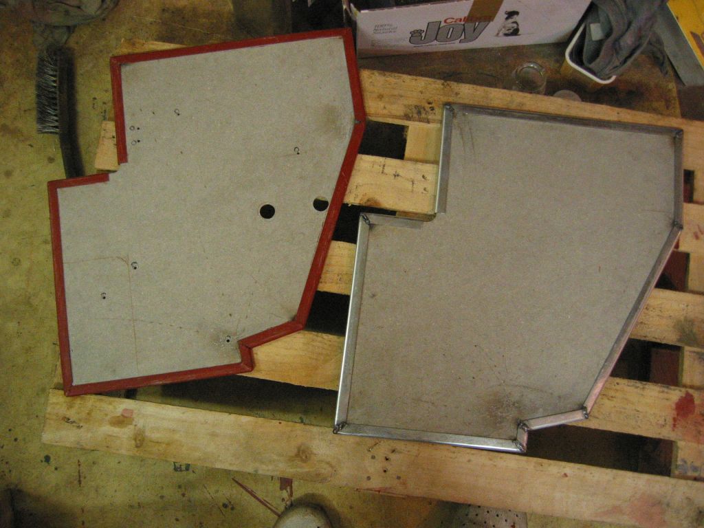

Finally finished the top plate.

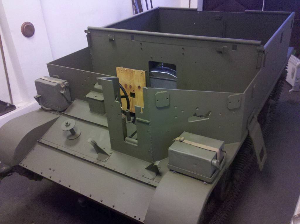

Four days of dirty job, but final paint completed. Now ready for mounting internals.

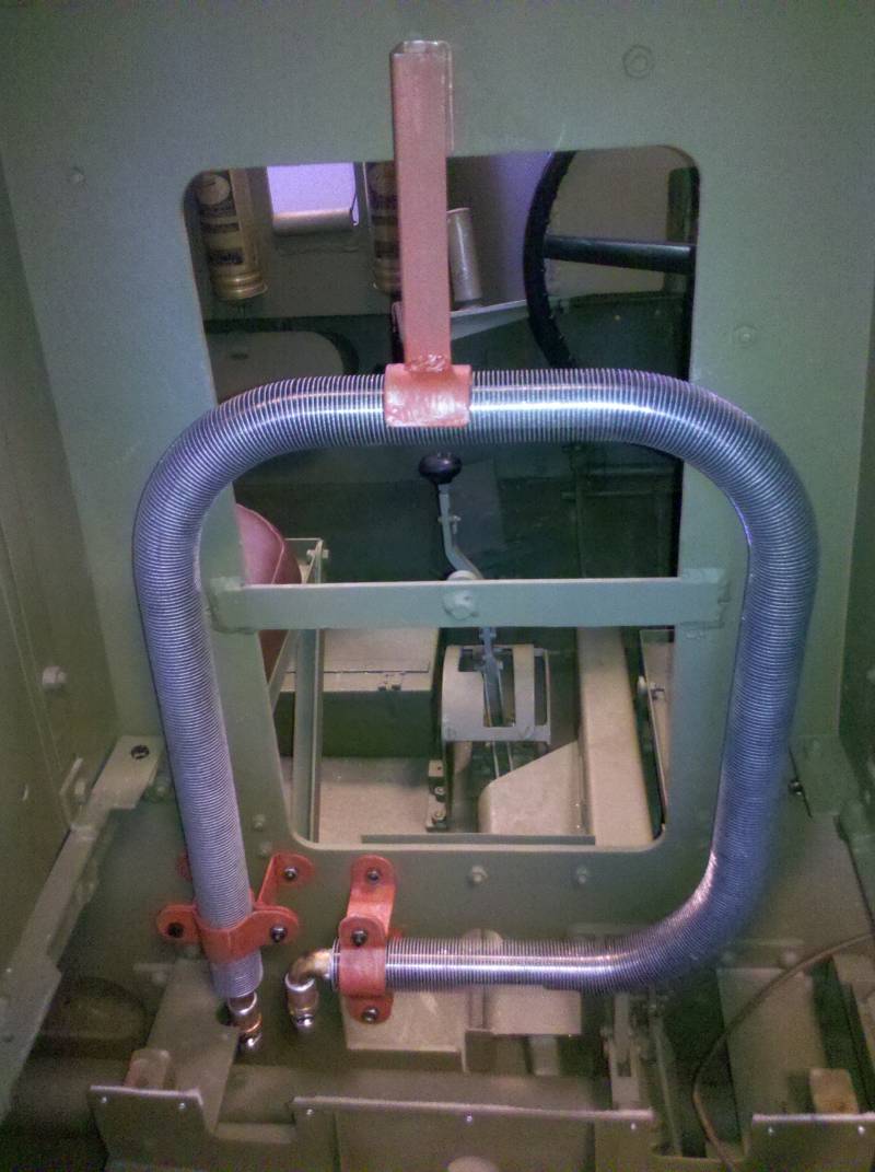

Thanks! Its definitely more fun now! Few more parts installed yesterday.

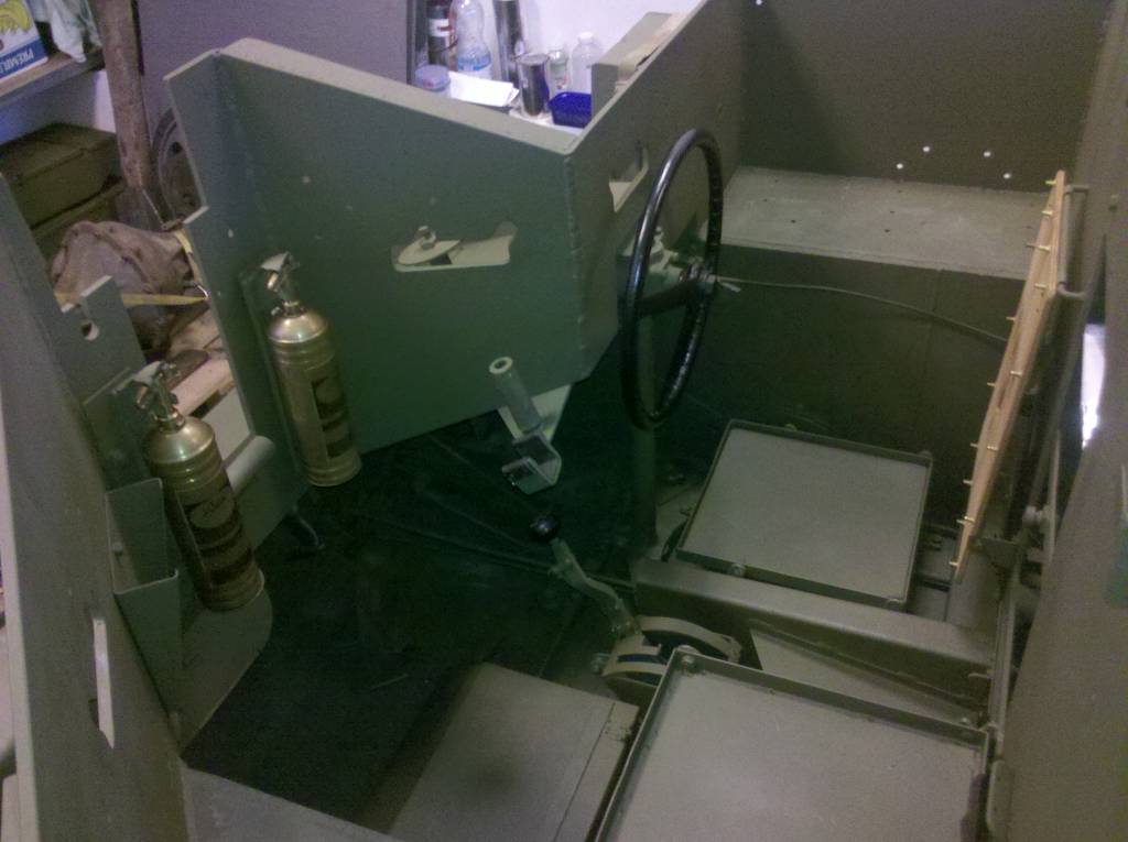

Front compartment seats finished!
UCw Mk.III

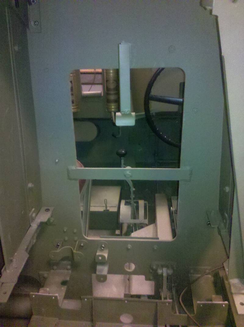

Petr, in you post #194 (engine mount photo) there are two holes under the brake rod. A leaf spring bolts in there to stop the rod slapping on the floor
(just in case you don't know)

Installed! Much more comfortable now

Just trying to help Petr. The next thing is that the seat cushions go around the other way, with the rounded corners to the front. (I used to think they should go in the way you put them)
Those anti slap springs are just a flat leaf that goes up slightly as it goes rearward from the bolts. they hold the rod above the bolt heads. The rear end flattens out.
A guess from my computer chair, I'd say they are about 120mm long x about 21mm wide, and possibly a little thinner than the throttle spring leaves.
I have a picture somewhere but not able to find it yet.
There are covers that go over the rods as well.

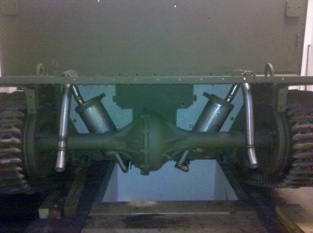

Exhaust mufflers are back on! Don't tell me they are ugly - I know that
Also replica oil cooler provisionally mounted - fits like a glove
