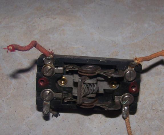

I was digging in my junk and came up with this switch. Judging by the schematic, this looks like the same kind of switch as they originally used.
It's off some telephone equipment.
