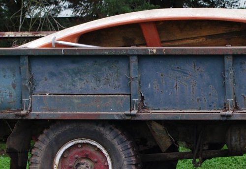

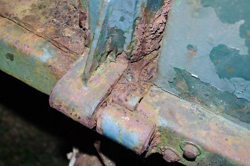

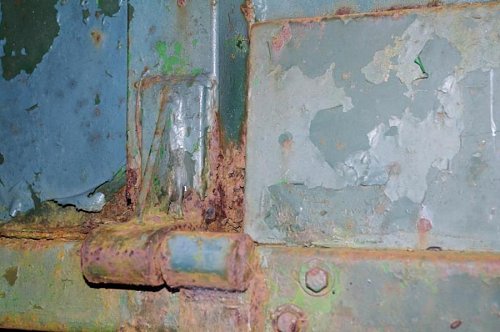

Question.... Does anyone have any photos of the drop side hinge in front of the wheel arch box - would like to know if it is welded to the box or the tray?
Tony, this one is on a Cab 13 F60L but may give some clues. Different height wheel arch but presumably same construction. Not the best pics I'm afraid but can take more if needed.

Thats what I was looking for Tony, it appears they are welded to the wheel arch box not the tray as well... makes sense if they made the box to be removable.
