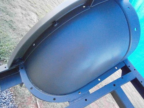

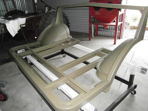

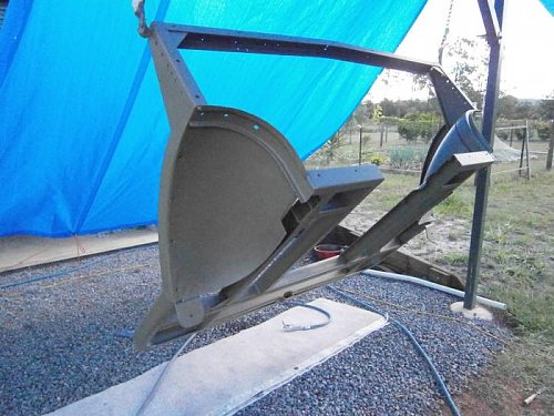

Default Cab frame is finally painted
ID:	47359 Click image for larger version
It took hours, and I had to put a tarpaulin over, so paint (and I) didn't cook too quickly, but it's finally painted. In hindsight, the painting was the easy bit. Getting a freshly painted, heavy, truck part into the workshop again without damaging the paint, THAT was the hard part. Managed to do it with help from my son. He should be helping too, we spent 90 minutes and a lot of money at a Ford dealer on Friday, buying his first car. He owes me until approximately 2045!

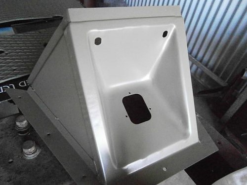

Frame now resting on the trolley again, ready to start assembling parts. That will wait until next weekend. Grease paper laid on the beams of trolley stops the paint from sticking!
ID:	47362 Click image for larger version
Instead of doing all the cleaning up then moving onto welding the rear panel, I decided to finish painting the floor plates and several other bits. Unless I damage them somehow, I can brush paint the bolt heads holding plates to frame, and I won't need to spray anything inside the workshop. The dust gets everywhere!
On my two weeks off, I hope to get the nose panel repaired (some dents need beating) and doors sandblasted. Maybe even get the doors painted. Windscreen frame won't need much sorting and should be finished and attached soon.
I don't know why my camera is taking worse quality photos every time I use it. Perhaps the heat is cooking it. I know it's cooking me!!!

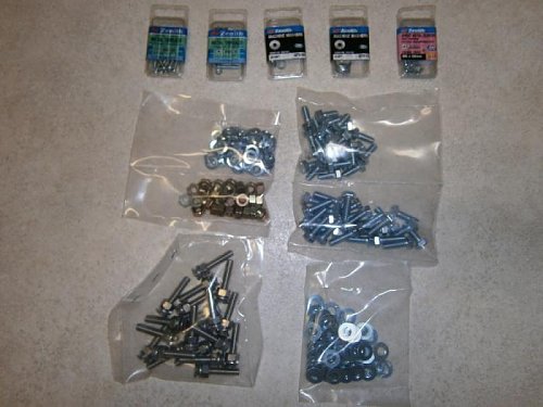

Name:	cab bolts.jpg
Just for laughs, anyone care to hazard a guess at the cost of these few bolts?
They are:
5/16 x 1" bolts G8 x 25
5/16 x 3/4" bolts G8 x 25
5/16 nuts G8 x 30
5/16 spring washers G8 x 60
5/16 flat washers HT x 60
5/16 SS nuts x 20
5/16 SS slot screw x 20
M8 SS spring washer x 20
Here's a little hint, The five little packets cost $1.00 between them.

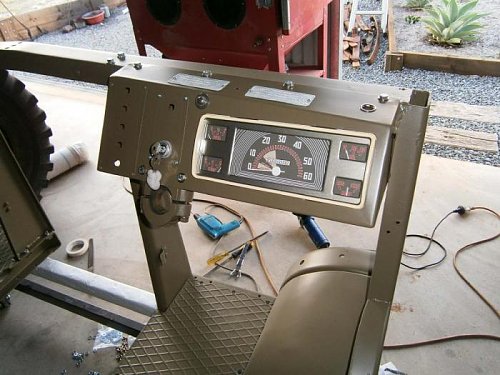

The dashboard was attached.

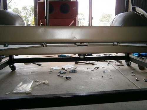

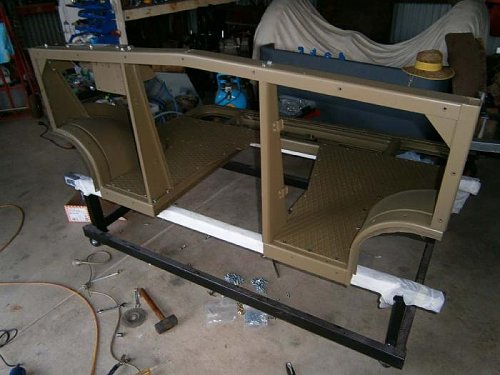

The two vertical bars that the engine hatch clip into were attached,
and cab rear frame mount assembled & bolted into place.

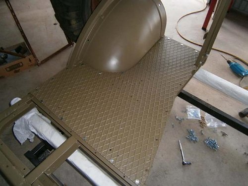

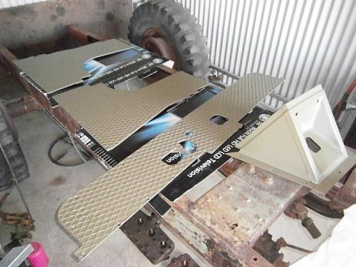

And thats where the progress ends, because when I had finished bolting the two larger floor plates I took a good look & wasn't pleased with the screw head bolts I had selected. The exact size I needed was no longer available, and the ones I chose were slightly larger. They still fit OK but don't look quite right.
So tomorrow, I buy 60+ of those bolts in next size down. I had one of these laying around and tried it for fit, it fits well. It fit well several weeks ago too, but I decided against them because they didn't fill all of the recess in the floor plates.
The ones I tried today were a tiny bit larger than the holes, and sat about 0.5 to 1.0mm above the floor plate surface. I thought I could live with this......but now that I have seen them installed............I can't stand the sight of them.
To add insult to injury, there would not be more than two holes bored with the same depth of recess, and the most shallow holes seem to be where it would look the most obvious. Some look bad enough to trip over getting into the cab. Tomorrow they all come back out and new (slightly smaller) ones go in. I don't expect to get this all done tomorrow. I am picking my sons new car up at 1000hrs, and will be returning to town later, to surprise him with said car when he walks out of school. He knows we have been looking, but doesn't know we have bought one. Rebuilding the Flathead V8 will have to wait until next year, now.
I also expect that the bolt shop will have 'just run out' of the size I want. Hope for the best but expect the worst. That way nothing surprises you!

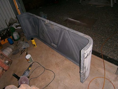

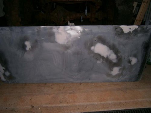

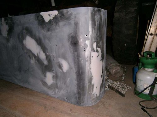

Firstly let me apologise for lack of photos today. Yesterday morning I started marking the dents and rustouts on the rear cab panel. I needed to replate three areas. Two where holes had been cut for something to go through, and one along the bottom edge where rust holes couldn't be welded up without blowing the hole bigger and bigger, as a consequence of poor metal surrounding the holes. These were the easy part. The difficulty arose with rust scale between the angle iron frame and panel steel that had caused a bulging effect. I considered cutting out these sections and replating, but knew that if I started doing this I would have to follow through with every place this has happened. That would mean virtually cutting off most of the lower 30-35mm. My metalworking skills don't extend to this sort of job. As Dirty Harry once said, "A mans got to know his limitations", and I do!
This afternoon, I spent a leisurely two hours, laying the first application of filler to the curve on passenger end. This part received a lot of my attention yesterday with hammer and dolly. Someone had torn a hole through the area and despite a quite good weld job, there was much work & time needed to get the area to an acceptable state, where minimal filler was needed.
I HATE PANELBEATING, I REALLY hate panelbeating. And I hate sanding filler WORSE than that! Thats why I tried to have the metal as straight as could be, to minimise how much filler I had to use (and then sand). The result achieved on the end done so far, looks promising, providing I have succeeded in preserving the little vertical groove approx 1in in from the panels end. A coat of primer tomorrow will answer this issue, one way or the other.
I don't want to prolong this job one second further that I have to, and hope to have all repair work finished tomorrow. Body filler sanding is definately an OUTSIDE job. There was so much dust on me, I looked whiter than Michael Jacksons face. What, too soon? I was far too contaminated to touch the camera, hence NO photos. I will take photos tomorrow morning, before I kick-on with the rest of the repair work.
The bolts ordered for floor plates have not yet arrived, so no joy there. Tomorrow won't be as hot as today............apparently it'll be hotter, so that will be nice for working outside, applying filler before it goes 'off' in the moments after application. I could move into the workshop for this bit, but I am rather messy with the filler, and manage to drop the stuff all over the place. Suffering the sun and heat is my penance for being a sloppy pig!
My small angle grinder went west today, just as I was needing it for roughing up surfaces for body filler. This slowed things down considerably. Had to resort to scouring the metal by hand with 36 grit sanding disk.
Jeezus, I HATE panelbeating!

Old 02-03-12, 12:04
Default Cab rear panel..beaten.
Panelbeating finished.
ID:	47526 Click image for larger version
ID:	47527 Click image for larger version
Had intended to get primer on today, but I took ill suddenly and had to stop work for the day. I was just about to start spraying too.
