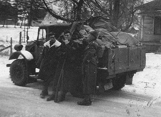

Here is another photo from my web site showing the tail-end of a Frod "prototype" 15 Cwt taken Jan 5, 1941 at Niagara Camp, Ontario. My father is standing on the far right.
Photo may not appear here. You can also find it on my web site at: Colin Stevens' CMP Page
Please send me your e-mail address and I shall look for the negatives.
