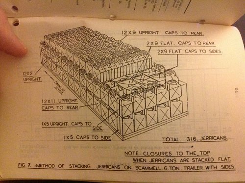

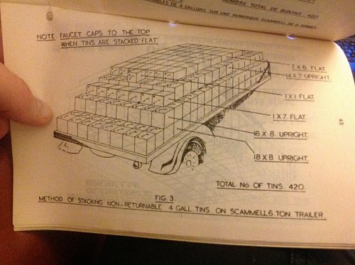

Yes, I think the 4gal cans are flimsies, though I was quoting from the manual - I dont have a good (complete) example of one.
Jerricans are referred to as 4 1/2 gallon cans in some of the wartime docs, differentiating them from the mention of 4 gallon cans. There are diagrams for safe stacking of both types.
There's a good photo on various forums that shows the difference between 2gal, 4gal non-returnable flimsy, 4gal returnable later type, and jerricans - I've attached it below (shout if it's your photo).
Old 05-01-16, 00:37
Join Date: Sep 2011
Location: Cambridgeshire, UK
Posts: 281
Flimsy type (non-returnable) from RASC training pamphlet 20 part 2.
(note this is a document on Petrol, Oil, and Lubricants, not water, so just quoted here to demonstrate the difference in the cans)
4 Gallon returnable (late flimsy)

4 1/2 gallon Jerricans
