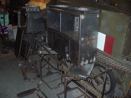

After a long sit, I'm finally getting on with my HUW project. I spent the last few months fabricating the interior bins, wireless table, seat bases, etc. and put them in for a test fit. Not much to look at now but it feels good to see it all together for the first time. What is becoming clear is just how cramped it is in the back of one of these.

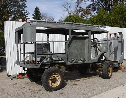

I got the HUW back from the sandblaster today....couldn't be happier. Here's as recovered, stripped, and now sandblasted.

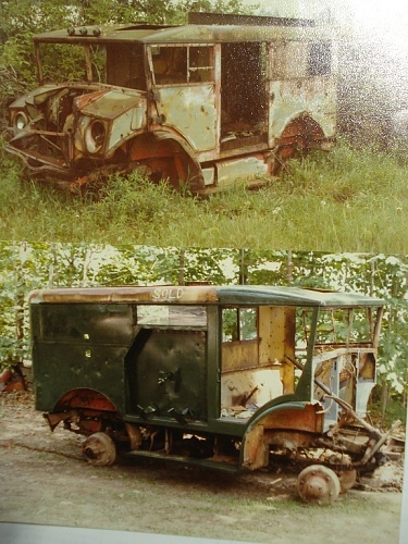

It is great to see this truck finally under restoration. Here are a couple of rather poor pictures of the truck when it was recovered from a Jasper area wrecking yard in the late 1970s or early 80s. Note the I beam on the roof.
Old 27-10-20, 23:05
Bruce Parker Bruce Parker is offline
Posts: 2,637
Thanks for those pics Bob. I find it odd that someone painted it Tremclad forest green over the faded khaki. What, to pretty it up for a quick sale? No matter, the green and spiffy red inner fender paint is all gone now.

I think the name of the yard was McDougals (your photo is correct!), and they had a couple of CMPs but none as interesting as the 8cwt wireless. There was also a major surplus store on the opposite side of the town called Prices. While the glory days in surplus were over by the time I got there I remember buying 19 sets and power supplies for $10-25. They had skids of them. There was also a row of 3 ton van bodies and cargo boxes out in the side yard, and a quanset hut full of ex govt desks and furniture..
I am pleased to see the progress you have made with the truck, good luck with the restoration!
Old 28-10-20, 03:55
Posts: 2,637
a
The poor thing was rode hard. The diffs had been replaced with the earlier, higher ratio ones (completely worn out) and between the I beam and the inevitable trailer hitch yanking out the lightweight rear frame crossmember there were some 'structural repairs' required. I had a donor chassis so it now has the right diffs and the rest of the chassis has been restored to what was originally intended.
