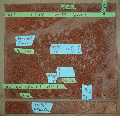

Old 22-08-22, 01:21
Posts: 2,232
Well, today I successfully harrassed Bob to find the remnants of the mud deflector/flap from his 2B1 box.
The remnants of the rubber (that had been trapped between steel panel and retaining strip) show a 3/16" thickness. the width of the rubber was basically the same as the steel, it's downward extensin from the stell can't be determined from the remnants. Unless others can tell us the vertical dimension, it will be a guess from photos.
As you can see, although the two ends of the brace are symetric, they are not 45 degree bends (a bit less)- measurement to follow. The top edge of the steel palte is bent, but I'm not sure whether deliberately or accidentally.
Shadows from the brace and rubber can be seen on the rear of the steel deflector
Name:	2B1 mud guard - flat.jpg
ID:	129803 Click image for larger version
Name:	2B1 mud guard -approx installed.jpg
ID:	129805 Click image for larger version
Name:	2B1 mud guard - back face.jpg
Old 22-08-22, 01:26
Posts: 2,232
Default brace
More detail on the brace from the back face of the mud deflector plate to the bottom of the box mounted underfloor on the 2B1 body.
Name:	2B1 mud guard -brace1.jpg
ID:	129807 Click image for larger version
Name:	2B1 mud guard -brace2.jpg
ID:	129808 Click image for larger version
Name:	2B1 mud guard -brace3.jpg
Each end of the brace strip is bent up 54 degrees from the flat strip. The effect is to slope the mud deflector back 18 degrees from vertical. (Hopefully this matches the slope on the forward face of the crossmember it mounts to...)
Last edited by Grant Bowker; 24-08-22 at 02:24. Reason: Edited to add the bend angle at the ends of the brace.

And does the rubber bolt to the inside of the wheel arch flap or on the external face of the flap, ie showing the reinforcing plate on the rear view
Looking at period photos looks like inside the wheel arch then I look again at others and I begin to doubt myself.
Paul
1942 Ford GPW
1942 Harley WLA
1943 Willys MB
1940 BSA M20
1940 Morris Commercial CDSW Light Recovery
1942 CMP Chevrolet no. 12 cab
1944 Bedford MWD
Old 23-08-22, 15:24
Posts: 2,232
The shadows of the brace and flap are both definitely on the same side of the steel panel, the rear face. Since this is only one sample, it is possible that others could have been assembled differently.
