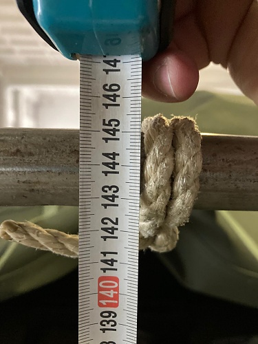

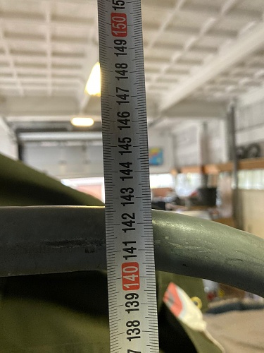

Posts: 13,995
Default Measurements
Originally Posted by Paul Edwards View Post
With regard to the hood bows, is the top bow slightly cranked at midspan to create a ridge line? Or square?
It is slighty cranked, 2,5 cm/ one inch higher according to my measurements. Top of the bow measures 145 cm from the bed floor, just before the corner starts the height is 142,5 cm.
The radius of the corner is 25 cm/ ten inch, Worthing's canvas fits that radius.
