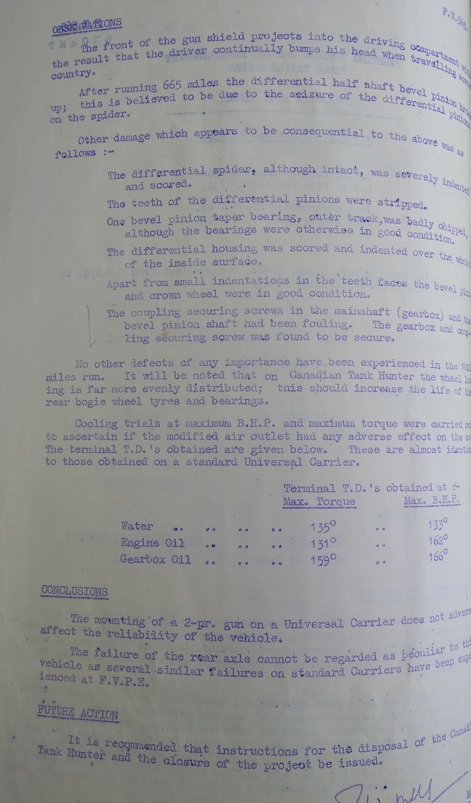

A Friend sent me this from some archives, Tank hunter British evaluation, interesting read.
1C57800C-0C10-4BDD-B9C3-AC37AF90499E.jpg   8A1E20DC-D4E5-443E-AD93-0C5AAAE22E86.jpg   EC480BBE-5141-4E16-8AD6-156E9F3C7F63.jpg   692C3B3F-07C4-487A-98C9-4D5CF38350ED.jpg   A05B4C9F-E2C1-4009-8A97-E77DE64FE141.jpg

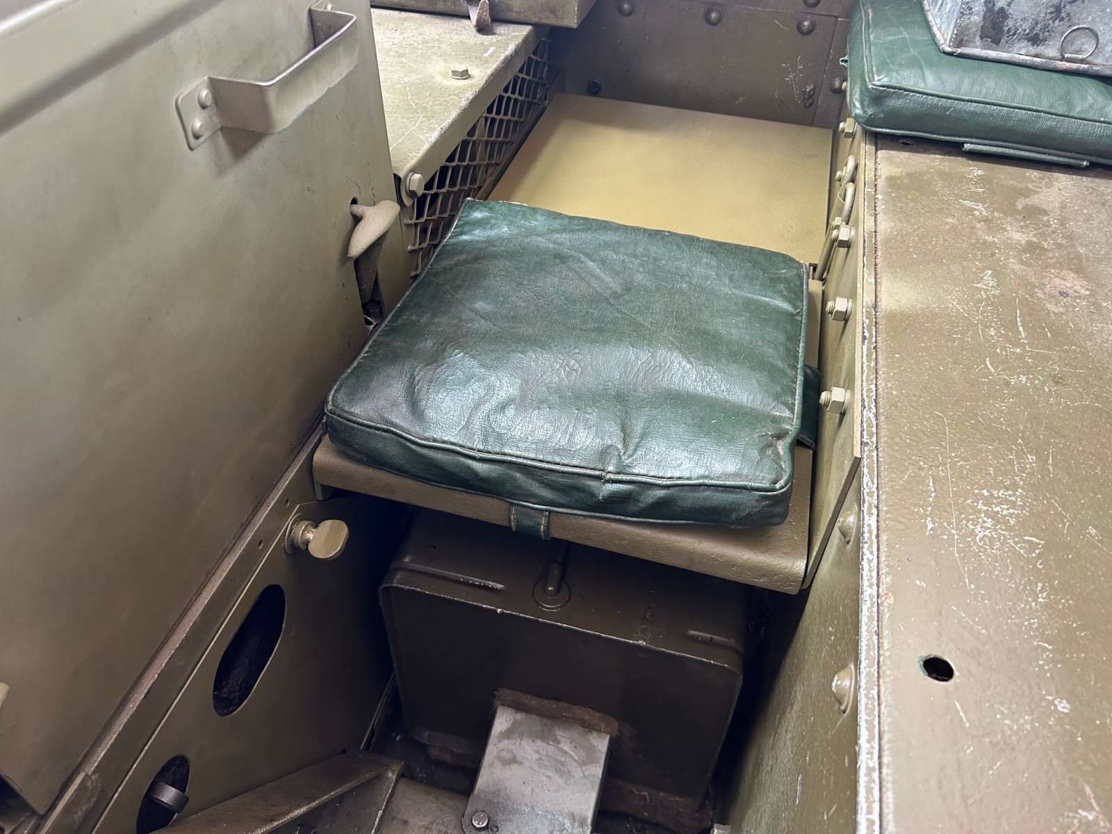

Default Rear fuel tank covers
Fitted the steel plates which protect the fuel tanks, these plates sit on angle iron same as a standard stowage mk1 but are longer (use 7 side bolt holes instead of 6) and without cuts outs as per standard carrier.
C3F82D62-AC7E-4259-942C-BAF93C49D416.jpg   67266734-F2CE-4316-9F01-8B068515E16E.jpg   6DE397D2-A3AA-4BEA-97BD-A64DF5608081.jpg   C114EED4-4BE9-40B3-A745-D2C4DA0FFF1A.jpeg
