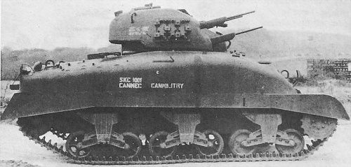

Old 06-05-21, 15:00
Posts: 14,848
Jordan Baker wrote: "I located the CMHQ file on the Skink AA tank. It goes from pages 4-300. Page 249 confirms that Skink marked SKC1001 was sent to NWE for field combat trials. A new unit was formed called the No.1 Canadian Tank Demonstration Unit."
https://heritage.canadiana.ca/view/o...80/249?r=0&s=2
This is SKC1001. Note it has been fitted with CDP tracks:
Old 06-05-21, 17:41
Chris Johnson's Avatar
Chris Johnson Chris Johnson is offline
Cdn Armd Corps In WWII
Location: Ontario, Canada
Posts: 61
Can anyone hazard a guess as to what the script says on the turret?
Chris Johnson
Old 06-05-21, 18:23
Posts: 14,848
Could they be shipping dimensions and weights?
