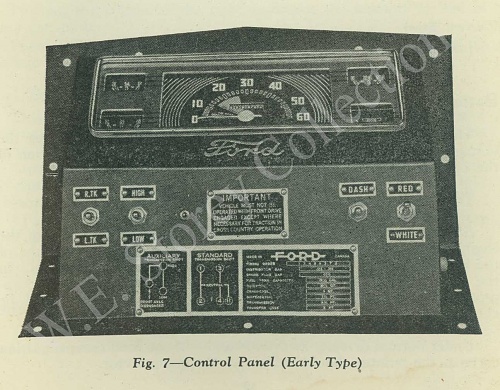

Perhaps these scans from my copy of Instruction Book - Special Pattern Vehicles - Fifth Edition published by Ford of Canada will be of interest.
Name:	Fig. 7 - Control Panel (Early Type).jpg
ID:	131037 Click image for larger version
Name:	Fig. 8 - Control Panel (Current Type).jpg
