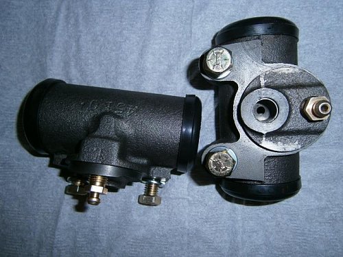

Default Ford / Chev CMP Rear Brake Cylinders
In addition to the Raybestos WC4511, an exact duplicate is Wagner WC4511.
Also listed in some places as "F4511".
These are 1 &1/2in, and come with bleed screw and dust boots installed.
ID:	44838 Click image for larger version
ID:	44837 Click image for larger version

Can't remember who took over who but Raybestos seems to have taken over Wagner...... these wheel cylinders are fairly generic and have a multitude of use in commercial/industrial applications such as forklifts,etc..... both front and rear. Remember that most of these brake parts have roots to FORD....even on a CMP chev truck
They have been a off the shelf stock items in heavy truck parts stores in Ottawa or at worst an overnight delivery. Around $55 dollars in Canada.... how much did they hurt you for ...?

Surprisingly little cost for these.
They were slightly dearer than the Raybestos list price, but as those were out of stock with no immediate plans to restock, it was the best option for me.
At Rock Auto, they were just shy of $65.00 US. That makes it roughly the same for $AUD at that time. Shipping via FedEx added further $30.00ish. So overall $160.00 for the pair, landed to my door.
I am aware of resleeving/reconditioning of originals at $75.00AUD. So basically another $5.00 each for new versus refurb! No contest really. They are a very good finish and quality from what I can see so far.
I will be buying the WC4571's for front in next few weeks.

Hi Tony
Shipping from the USA is the real killer for you guys.
When the cost of a new one is similar to the resleeving in stainless steel one has to think about which in the long run is best. A brand new wheel cylinder will eventually rust and deteriorate particularly with the significant seasonal changes. On the other hand a rebuilt WC with SS lining should last a life time...... in fact the rubber boots would be the first to dry up and crack.
The life of a NEW WC would also be affected by the frequency that the vehicle is actually being driven. Putting your vehicle away for the Winter for months with no driving probably causes more damage than a whole Summer of driving.
